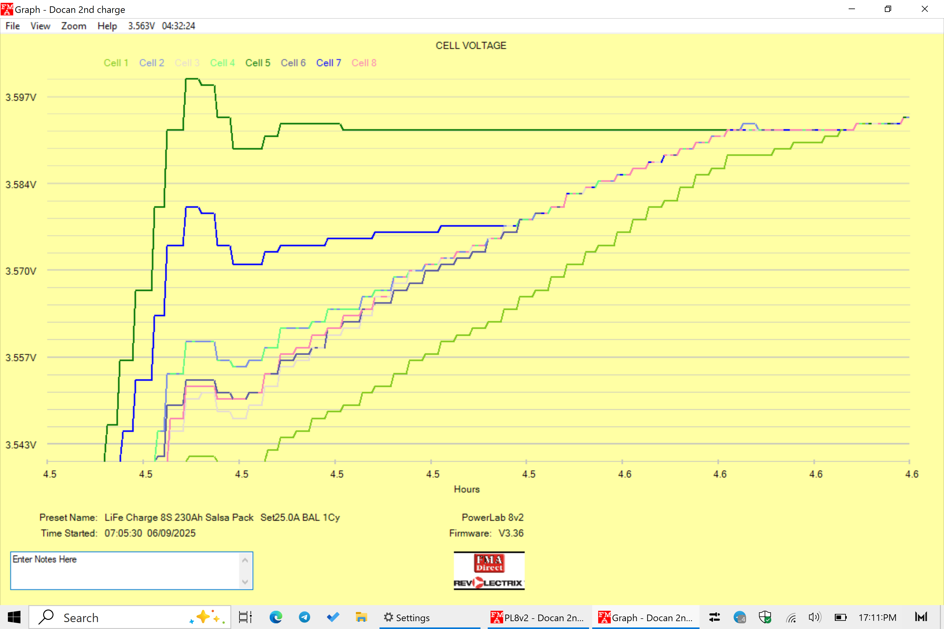

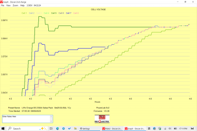

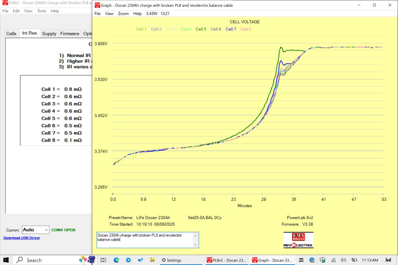

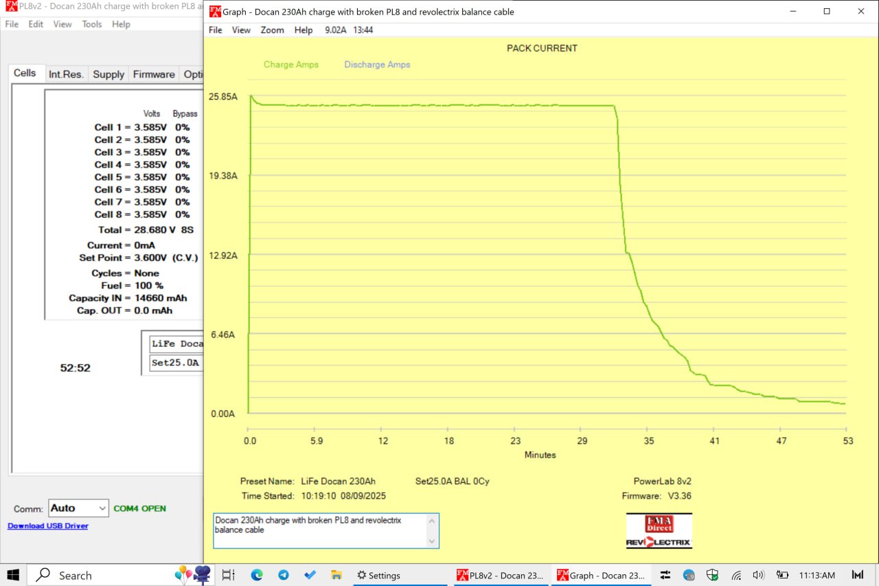

Postby Scooterman » 06 Sep 2025, 17:12
Here's a zoomed in graph of charge
Postby Burgerman » 06 Sep 2025, 18:08
It ended the moment it was balanced. Setting to that 11.5A would then have made zero difference. Because the current was under 1 amp at this time already!
Also that initial part of the curve where the two lines above and below the average could be not real. That happens if you have a bad connection, or if the PL8 is badly calibrated for whatever reason.

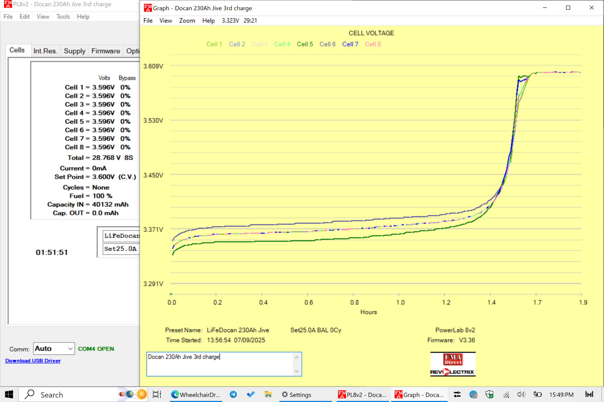

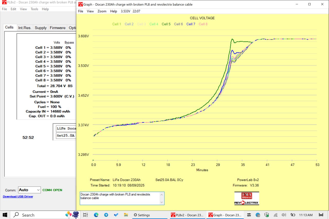

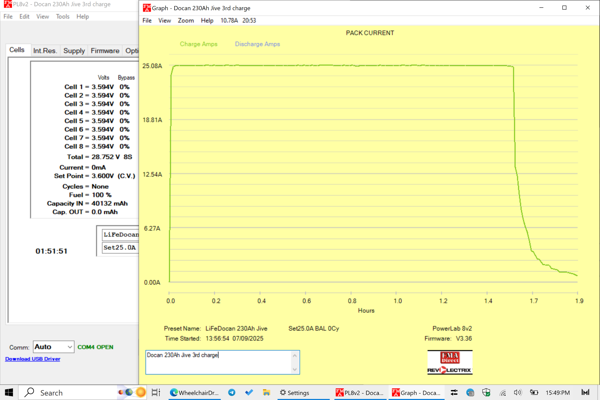

Postby Scooterman » 07 Sep 2025, 16:01
I checked all the connections and charged them again. Cells 5 and 7 still went high before all the others, but the balance phase lasted about 15 mins and terminated at 750mA.
I'm going to discharge them again by about 20Ah I think you said somewhere.
Then swap around the cells and charge them again to see if it's a problem with cells 5 and 7 or connections to 5 and 7.

Postby Burgerman » 07 Sep 2025, 16:14
I would sugest that cell 5 or 7 or 6. Has a bad connection someplace. Or a longer wire or something different.
If not then use a multimeter while charging and check the real voltages and see if they are all matched which they will be...
In which case you have a badly calibrated charger.

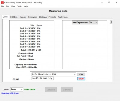

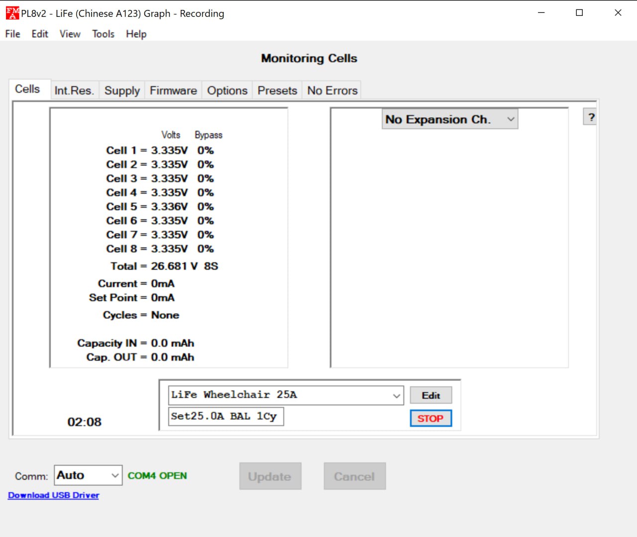

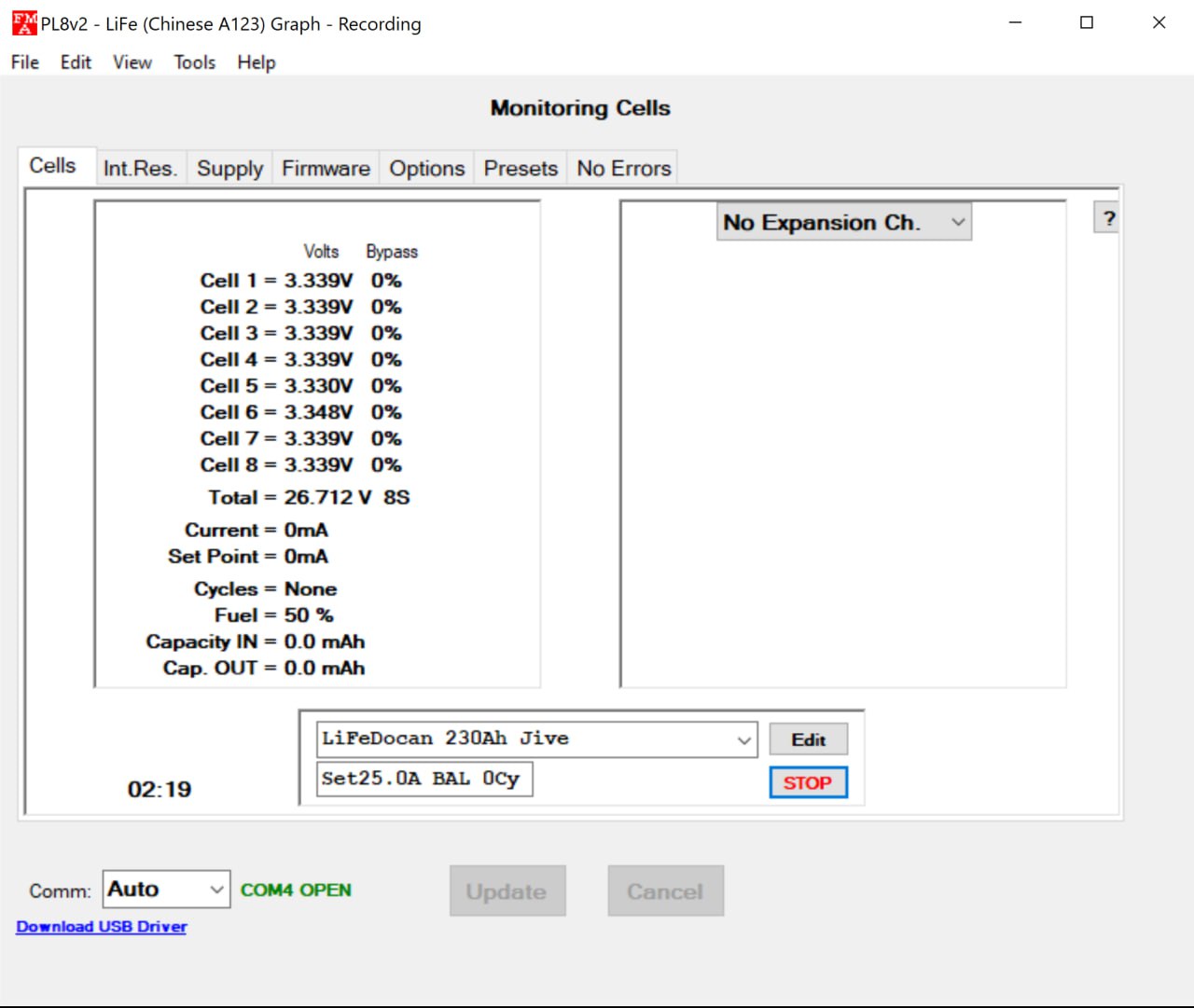

Re: docan cells update.
You were correct, the PL8 I was using isn't very well calibrated.
With PL8 in. monitoring mode my Fluke measures all cells to be 3.333V

Postby shirley_hkg » 08 Sep 2025, 11:37
The average of 5 & 6 is the same as all the others.
A component is ageing, but still safe to use.

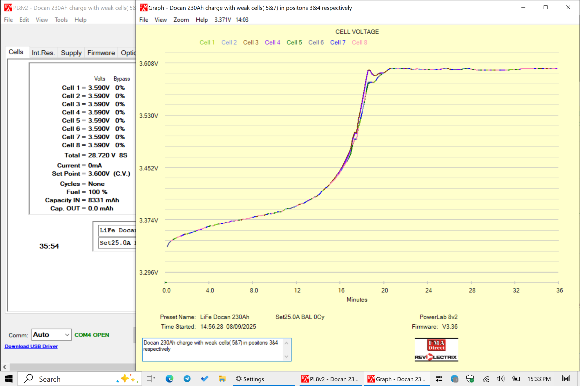

Postby Scooterman » 08 Sep 2025, 15:55
shirley_hkg wrote:The average of 5 & 6 is the same as all the others.
That makes sense as that PL8 has had the most use. I've packed it away as a spare.
Now using different PL8
I moved cells 5 and 7 to positions 3 and 4 respectively.
And on this charge 3 and 4 went high.
So, 5 and 7 are definitely weaker cells I assume?
Does it matter, should I contact Amy at Docan, or just install them in chair?
Postby shirley_hkg » 08 Sep 2025, 16:06
Cells seem ok.
You should do a full discharge to 3.00V to see their actual difference in capacity wise.
Posts: 4560
Postby Burgerman » 08 Sep 2025, 16:32
Looks pretty damned good to me.

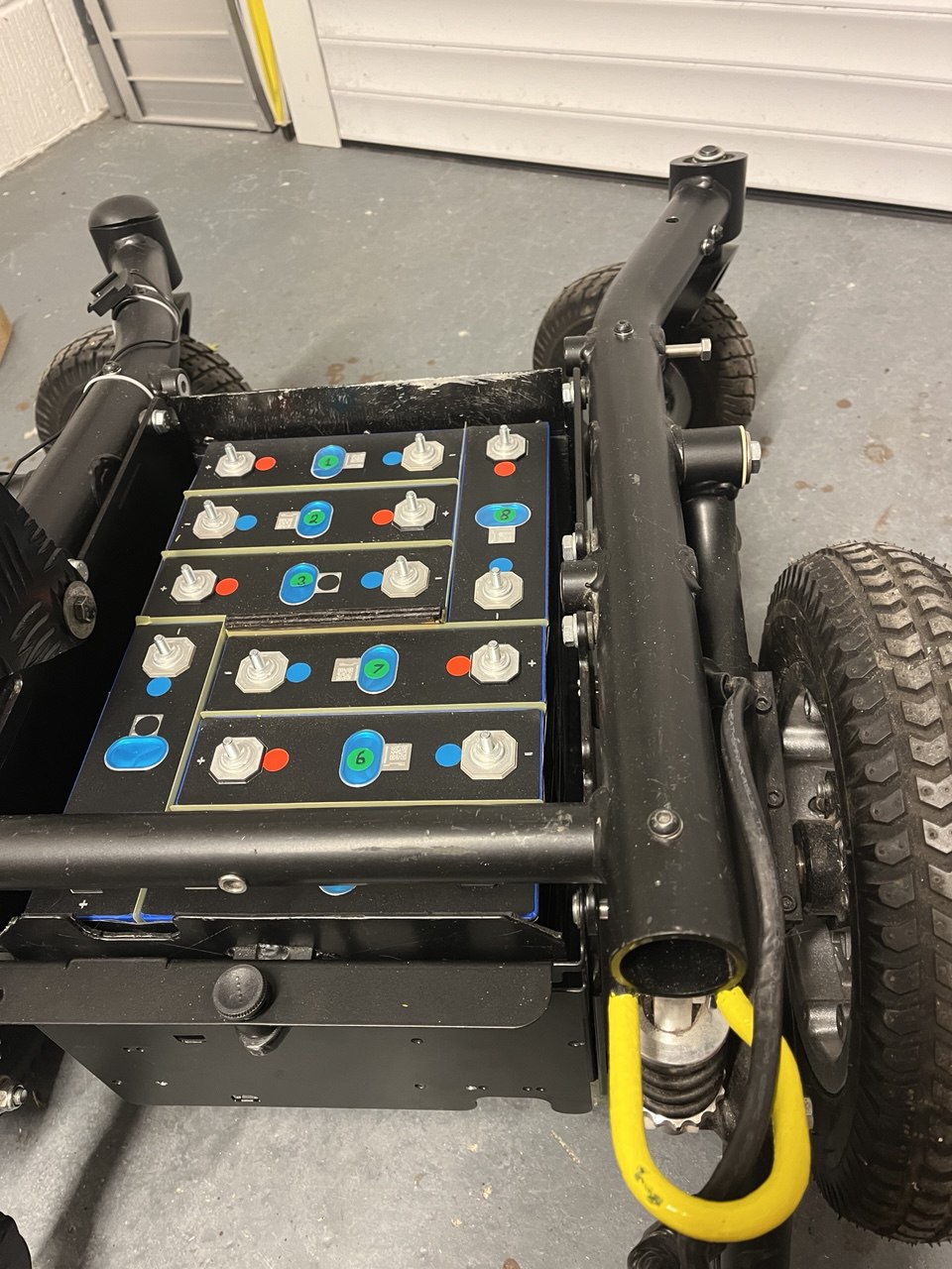

Postby Scooterman » 13 Sep 2025, 19:30
When installing 8S lifepo4 prismatic pack in 2 x group 24 steel battery box do we need to leave room for the cells to expand? :problem:
packing them in snugly is obviously good cos we don't want pack moving about. But then I think, do we need to allow a gap at either end in particular for cell expansion over time?
Worry that if no expansion gap cells might try and swell but can't, then explode, cause fire and burn house down!!! :shock: :ambulance
Postby Burgerman » 13 Sep 2025, 22:36
Its the opposite. The manufacturers insist that for long life and hevy currents we SHOULD have a steel plate either side, and a high clamping force... Because high charge voltages, high current draws etc that dont really affect us cause them to swell otherwise.
Posts: 70424
Postby Scooterman » 13 Sep 2025, 22:56
Funny you should say that because I read what you say in solar forum, and it seemed counter intuitive to me so wasn't sure if it was right? Thanks :thumbup:
The 230Ah fit fine in Sunrise Salsa/Jive R2. I just need to sort out some packing for sides.
Postby Burgerman » 13 Sep 2025, 23:23
You need some insulation/protection UNDER those cells, as well as around the outside edges.
All the casings are at different voltages that match the negative connections. If anything wears through that blue plastic film and they short out you are back to the :ambulance :ambulance :ambulance hanged
How much gap at each end?
And between bolt threads and that metal bar?
Posts: 70424

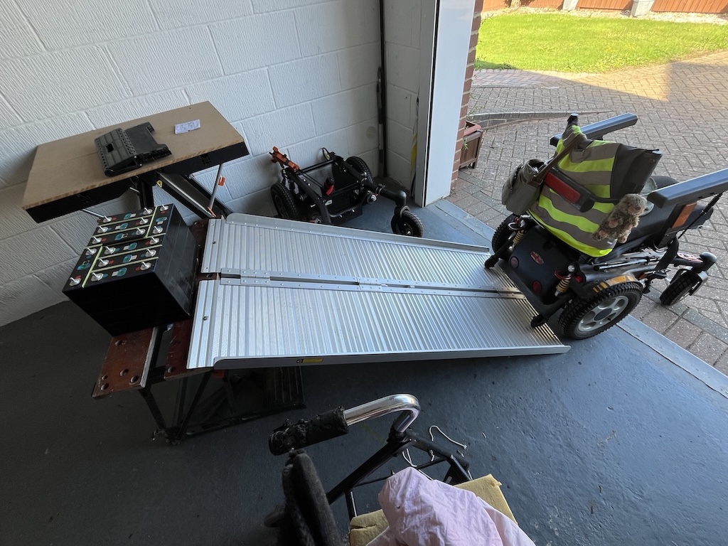

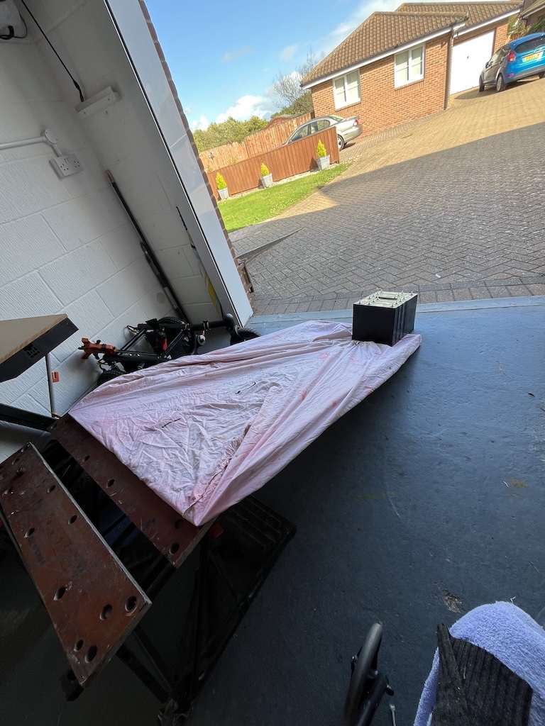

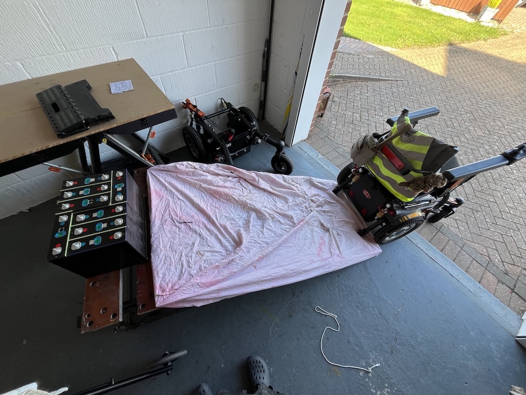

Postby Scooterman » 14 Sep 2025, 05:48
I've always found that difficult to understand. I assumed that he aluminium casing were either electrically isolated from the positive and negative, or at the same potential as the negative aka 0V. But obviously not because I suppose the manufacturers wouldn't supply the insulation boards, and you say not and I bow down to superior knowledge! :worship :D
Once I'd built up pack using supplied insulation boards. I bound it together with gaffer/duct tape, put it on a sheet of thin plywood, drew round bottom of pack, cut it out and taped it to bottom of pack so that should be okay. Pack also sits on three front to rear velcro strips.
Re that cross tube there's about 20-25mm air gap to top of studs. I plan to slice a bit of plastic pipe lengthways and stick/tape it to underside of cross tube.
Total length gap is about 10mm, but I've already packed most of that. Just got to find something 2-3mm to fill up rest of length gap. I diliberately left that gap for expansion but will find something to slot in there.
BTW built pack is bloody heavy, I really struggled getting from bench onto floor. The only way I could do it was to bolt wheelchair ramp to workmate and slide pack down on sheet.
