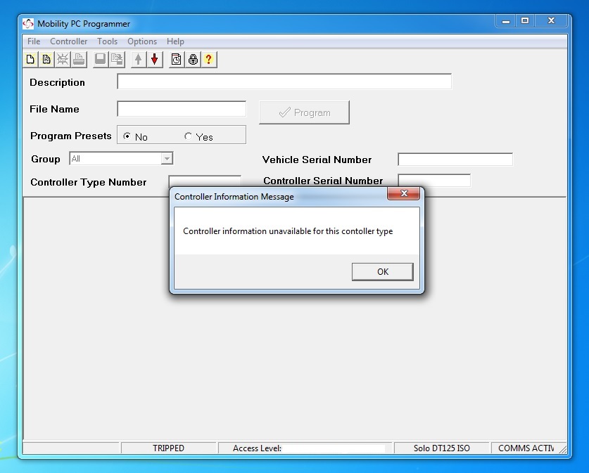

Postby woodygb » 20 Sep 2015, 14:50
The Mobility software will "talk" to the SOLO...but WILL NOT PROGRAM the SOLO controller....
solo comms.jpg (92.44 KiB) Viewed 15573 times
You need a handheld programmer SP1 OEM version or the Industrial software.Image
