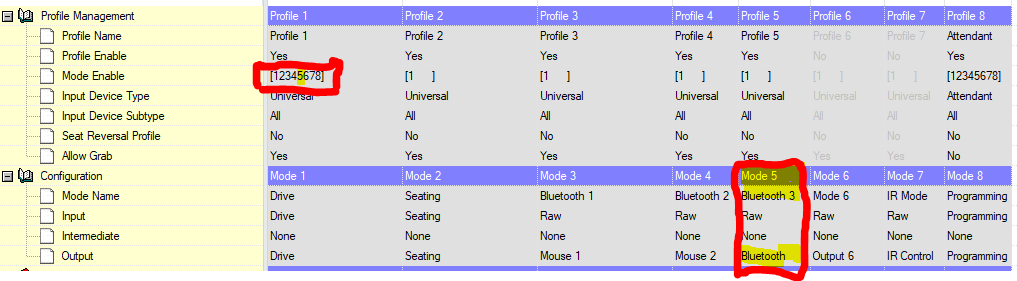

Postby relenox » 22 Jun 2020, 10:58
Can anyone send me the 6.1.0 or latest OEM?

Postby relenox » 22 Jun 2020, 12:50
terry2 wrote:
relenox wrote:Can anyone send me the 6.1.0 or latest OEM?
Thanks!
After 100 posts :D
I have 6.0.2 OEM software with dealer dongle, but I have problem enabling Mode3(BT) on my CJSM2-bt.. hope to get it work with the latest OEM

Postby terry2 » 22 Jun 2020, 13:06
relenox wrote:
Thanks!
After 100 posts :D
Bluetooth functionality you need to program, then this is done slightly differently.
First of all, you need to ensure one of the modes is set for Bluetooth, and this mode is enabled in the profile you are using

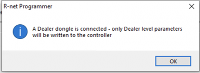

Postby thebassman » 30 Jun 2020, 20:04
I have a dealer dongle and oem software...can someone PM me how to set oem settings? : :thumbup:

Postby Burgerman » 30 Jun 2020, 22:10
If you open a DEALER level file, from your desktop, with OEM programmer and save it as a new file, then that file becomes an OEM level file. So now reopen it, and you can edit it.

Postby thebassman » 01 Jul 2020, 02:43
Welp... hanged

Postby Burgerman » 01 Jul 2020, 08:14
You are not listening.
1. Download the SETTINGS PROFILE to the desktop. Call it dealer_settings or whatever you want.
2. Close all software. Disconnect the dongle. Its not needed for the next step.
3. Now OPEN the OEM level software, and then open the file: dealer_settings.
4. Dont change anything. SAVE that file to the desktop and call it OEM_settings (any name you wish!) and close all software. That is now an OEM level file.
5. Now OPEN that file with the OEM software. It will allow you to edit OEM level parameters and it lets you write that file WITH the OEM changes to the desktop.
Now just load that file to the chair. In the same way you saved it to the desktop. You can use dealer dongle and dealer software. It will write the file to the chair complete with OEM modifications.
Posts: 71106
Re: R-Net PC Programmer OEM
Postby rover220 » 01 Jul 2020, 09:34
Burgerman wrote:If you open a DEALER level file, from your desktop, with OEM programmer and save it as a new file, then that file becomes an OEM level file. So now reopen it, and you can edit it.
must make sure dealer dongle is unplugged form usb mind.
