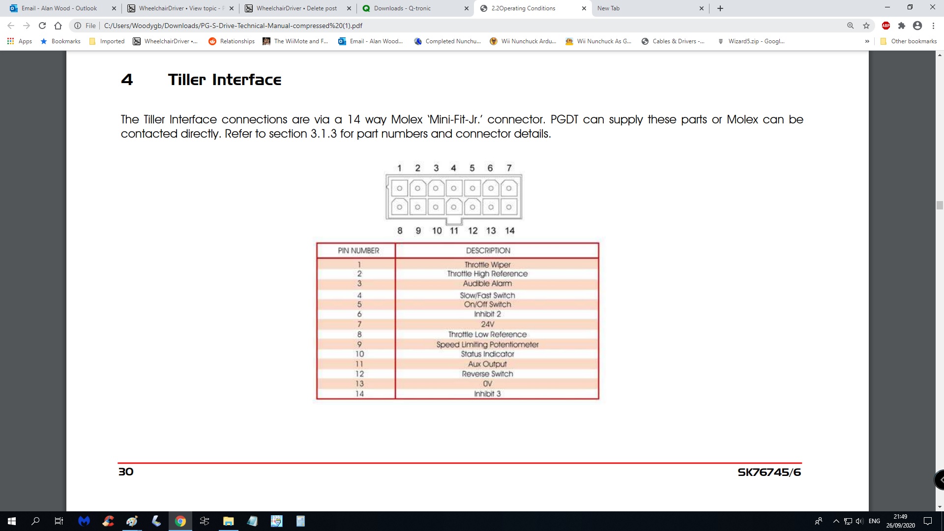

Postby woodygb » 26 Sep 2020, 21:44
S-Drive Manual on page2
https://en.q-tronic.nl/downloads/
The audible alarm will be EXTERNAL to the S-Drive ..possibly connected to pin 3 or 4
EDIT ..Pin 3

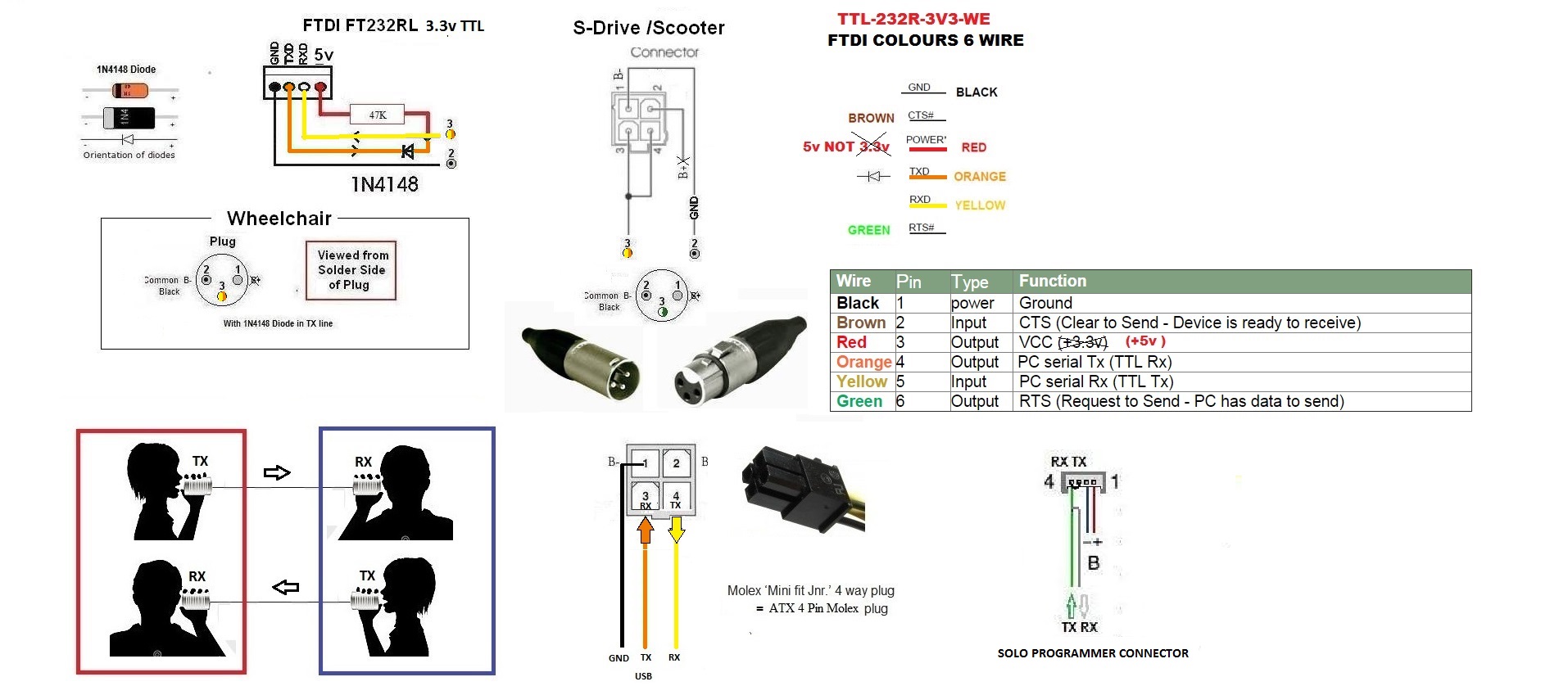

Hi guys, i tried to read as much i can find before to post, but i still have some question :)
First of all, i have a "D51270.06 45A" controller in a scooter, and i found that i'll have to use an FTDI usb, but just the last month i've received a USB TO TTL using the ch340e chip,
#1 question: Do you think it works at the same way as the FTDI?
#2 question: Which wiring diagram I have to use?
#3 question: Can i connect the wiring cable directly to the "3 INPUT PIN" chargin port WITHOUT HAVE TO touch the 14 PIN Molex port?
If you can send me the things i'll need it would be great, thanks in meantime!

Postby woodygb » 22 Oct 2020, 09:54
#1 question: Do you think it works at the same way as the FTDI? ..Maybe... You will have to try and see
#2 question: Which wiring diagram I have to use? ... Try the latest pic with and without a resistor.
#3 question:Can i connect the wiring cable directly to the "3 INPUT PIN" charging port WITHOUT HAVE TO touch the 14 PIN ( 4 pin ) Molex port? Yes ...Most mobility scooters are wired up to allow this.

Re: Programming cable specifically for S-Drive controllers
Postby woodygb » 22 Oct 2020, 11:43
To be sure, which is the latest wiring diagram?
Postby woodygb » 22 Oct 2020, 12:16
If the controller is wired up and in situ use the scooters ON/OFF Key .
OR
If the controller is on the bench use an ON/OFF link .... For ON connect between pins 5 & 7 ..

Postby darky » 23 Oct 2020, 19:28
Yeah to cut the beeper was the first i tought, but in this way i would have lost the diagnostic/warning part of it.
About the rest, i did all the wiring but something doesn't want to work... it seems all conneted fine but it stay on COMMS INACTIVE.
I also did the looptest that went fine
is it right in this order? http://puu.sh/GG3kw/071591bb3c.jpg
C = TX+RX (i think this is the only sure one)
but of the other two input, is the 1 or 2 the negative one?
i'm using a 54k resistor it's ok? (if i remove it, when i connect the usb converter windows get an error driver)
darky

Postby woodygb » 23 Oct 2020, 21:53
darky wrote:Yeah to cut the beeper was the first i tought, but in this way i would have lost the diagnostic/warning part of it.
"is it right in this order?" NO
1/ Positive DO NOT USE
2/ Negative or GND
3/ Inhibit or Programming Data ( TX and RX )
A 54K resistor could work.
Connections are marked on the drawing.
download/file.php?id=14255&mode=view
