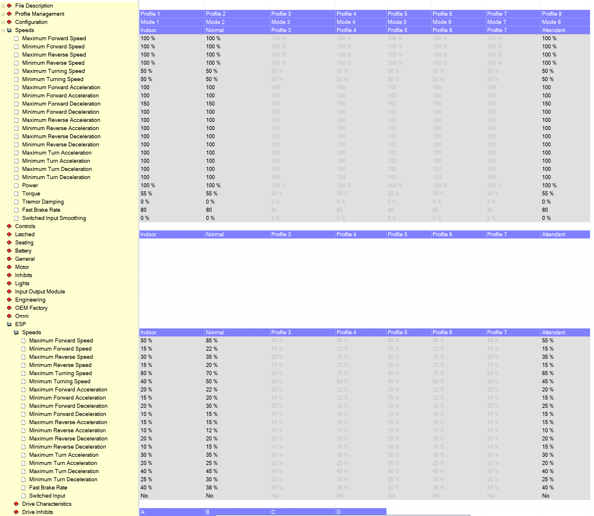

I have 2 profiles in the wheelchair - Indoor and Normal.
Speed in the program is also displayed in two sections.
As I understand it, I need to edit the ESP section?
And in what section empty modes are switched off?
Can anyone post the recommended settings for front wheel drive wheelchairs?

Postby Burgerman » 20 Jun 2019, 10:43
In the sections that you currently cannot access. And if it has permobils own seating modules setup, you cant access it at all.
AS for setting up driving parameters, in the ESP bit. You really cant. I have *never* got any front drive chair with a gyro to drive or steer in any way that I could use. They just cant do it.

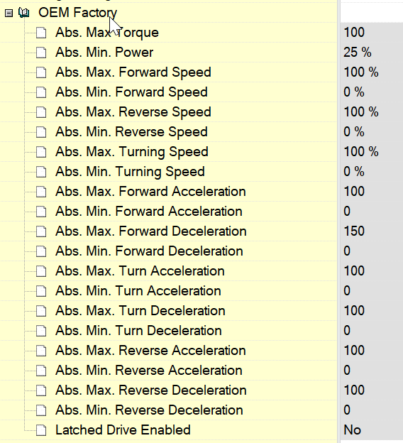

Postby AlexAGF » 20 Jun 2019, 11:08
I got OEM access. Now I see a lot more sections in the program!
I do not need to customize the seat modules. Need to disable or hide empty modes only.

Postby AlexAGF » 20 Jun 2019, 12:05
Tell me, why do need Latched Drive parameter?
Do I need to turn it on?

Postby LROBBINS » 20 Jun 2019, 15:29
Latched drive is for someone using an alternative input device - such as head switches - so that one hit (rather than continuous action) starts a motion and another is needed to stop that motion. If you are using a joystick, you don't want this.
Postby Burgerman » 20 Jun 2019, 16:17
Actually it doesent matter on/off as it only has any affect on digital inputs as far as I know. I have seen many with it enabled by default but no switches or digital input device fitted. So it wont actually hurt, but it wont do anything either.

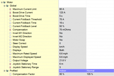

Postby AlexAGF » 20 Jun 2019, 17:01
I understood. Thank!
Tell me more please what parameters should I change in order to increase the torque at low speeds in order to more easily overcome the curbs?
And is it necessary to edit anything here?

Postby Burgerman » 20 Jun 2019, 17:46
Normally you would increase motor compensation SLIGHTLY. TYhis is also a danger. It is a positive feedback loop. So the more amps the controller sees, the more power it adds. Which increases the Amps, rinse and repeat. So if this is already set correctly and you increase it you can easily get a chair that runs away, cannot be stopped. So only mess about with that when you know what you are doing.
You can increase the TORQUE setting. This actually does seem to also increase motor compensation but only at SMALL STICK MOVEMENTS. So around neutral position. So it may help but will make the chair jerky if you add too much at super slow speeds as you turn left, right, or set off backwards or forwards.
If you want to see how many Amps the motors pull, while stalled (threshold/curb etc) so not moving when it should be, look at MOTOR AMPS L and R in the program as you try to climb etc. If it already reaches 120A then no amount of changing settings will do anything to help. That would require a slower geared motor.

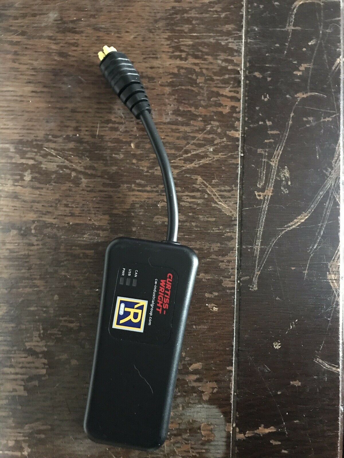

Postby Thndrwhls » 22 Jul 2019, 04:07
Hey fellas, I just lucked upon a Permobile M300 that was rarely used and only in a house. The batteries were dead volt meter only registered 1 volt. I had a pair of group 24 MKs that I use in another chair that is getting heavily modified in the welding shop right now.
I want to program this M300, it has the rnet PM 120 so good there, except for the fact that Permobile cripples end user programming. So if I have OEM software and a Dongle I can program some settings from what I have read. Does anyone have the OEM software they would be so kind as to PM me with. As for the dongle, I have seen a few on ebay, but honestly do not know what I am looking for, the ones I have seen are 6-700$ so I want to be sure before I buy one, and should I be able to find them for less??? I have uploaded a pic of what I have seen, just want to confirm this is what I need.
As far as Dealer programmers, I have a good relationship with one of the Numotion Service techs here, and feel he would let me dictate the settings I need. Are they able to modify the turning speeds, acceleration, Torque, power, etc... I dont care about the seating, its fine as it is. I just want more torque to climb and better steering control.
Thanks in advance!

Postby Burgerman » 22 Jul 2019, 04:17
You need an OEM dongle, really. As there are walls set up to prevent you setting high enough turn acceleration settings etc. Those may well need to be removed.
The problem is getting one. But see PM.

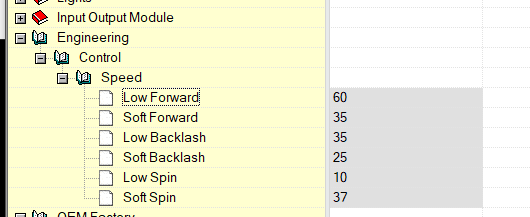

Postby Burgerman » 31 Aug 2019, 11:50
I know what everything in the R-Net and the other PG software settings does. With the exception of the following below.
I know how it FEELS when you change them. I dont know what they are actually doing. And they generally work best left well alone. They appear to change only the very last part of slowing down, or when you just start from a standstill, or begin to turn on the spot. I know that if you set them differently everything generally feels worse... But it would be nice to know what they ACTUALLY change.
I emailed PGDT with this screenshot and asked them. That was 4 days ago. So far, no reply.
Does anyone actually know?
