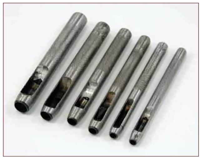

Postby Scooterman » 22 Nov 2018, 12:53
I have a set of these and have used them for punching holes in thick leather and thin aluminium sheet (which is probably harder than copper). They're not expensive.

Scooterman wrote:I have a set of these and have used them for punching holes in thick leather and thin aluminium sheet (which is probably harder than copper). They're not expensive.
what are those called - and how do you use them - with a hammer ? i returned the small hole puncher i had - was useless - i will use what i received and doubled up on them - in the future i will either have them custom made if i needed - or just use cables - the blanks i purchased are the correct size and thickness is nice but making a hole in them - not going to happen - i ruined one already - i just put them aside and maybe one day i have some use for it -
Yes just a hammer with the metal on a piece of wood. I just call them hole punches, BM or a-nother will know if there's a different name. I think they're supposed to be used with leather, but work fine for soft metals. I think I paid about £5 for them (about $8)
