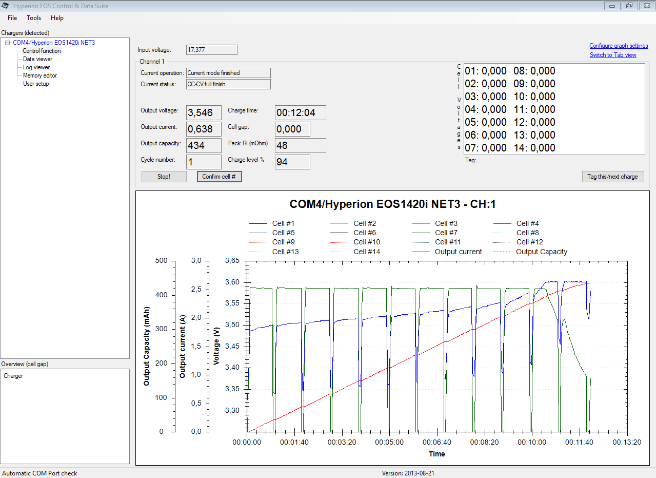

Got my headways 12Ah recently (I decided to build 8s7p/12Ah pack). Charging cells and have some doubts because some of them, #3 have very different behaviour.
After full charge I try to discharge it (minus 1Ah) with 5A and cell #2 shows graph like this, which I think looks good:

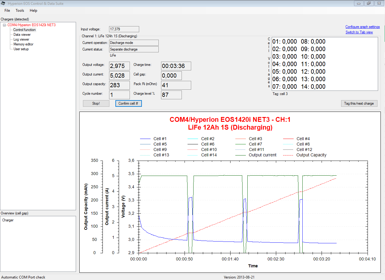

But cell #3 with 5A discharge had only 2.97V and hits it almost immediately after discharge started, also with 2A discharge graph looks like this (3.17v) which of I'm very concerned:
Is it Ok or not?

Postby Burgerman » 09 Jun 2016, 20:18
1. Did you FULLY charge each cell to 3.6V before you started? Do so!
2. Are these Loose cells, or already assembled intom a pack?
3. Discharge cell for a few minutes directly after a full charge. Discharge at the same Amp rate, and watch the volts. All should be the same voltage about 3.3x after a few minutes discharging at say 2 to 3A. Is that the case?
If not you have a problem. Seems unlikely as I have never had a bad cell. Or you have a bad connection...
Was it fully charged?
If so it may have a fault, or been discharged too low, or overcharged, or you have a bad connection. Where are the cells from? A reliable source?

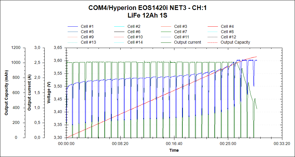

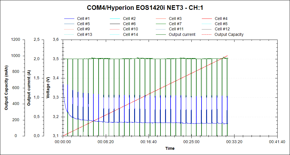

Postby Andrey » 09 Jun 2016, 21:38
So, I did the following:
1. Charged to 3.6v with 2.5A:
2. Discharged with 2.5A for 12minutes, voltage drops to 3.15v:
3. Charged again to 3.6v with 2.5A:
How does it looks? How it should look?

Postby Burgerman » 09 Jun 2016, 21:46
The charger discharges in pulses mostly, and then stops for a few secs to see UNLOADED true voltage.
As long as all cells behave the same theres no problem. If only 1 or 2 cells do this then there is a problem. The difference between high peaks and low points under load represents resistance of cell, wiring, connectors.

Postby Burgerman » 09 Jun 2016, 22:03
It depends on if this is cell resistance, connection resistance like a loose screw, and if its different to the other cells. Do the other cells behave the same?
The voltage under load isnt that important. Its going below a certain state of charge that is the problem. The unloaded voltage.
2.9 = end of play for any normal use.
2.5 = end or discharge for max capacity measurement.
2.0v or = less damage. UNLOADED.
So again, do the other cells perform the same?
