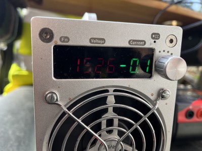

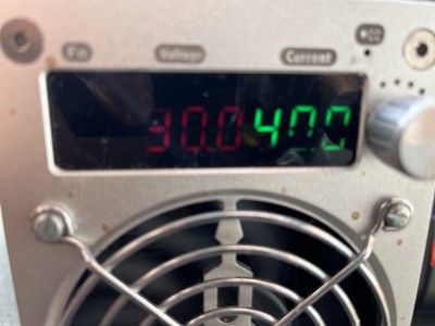

The ZXD had been working fine month after month, then for some reason the parameters went wrong???
So I stuck a faulty sticker on it and used the other ZXD instead.
So last week I did a factory reset and changed the EPROM Max Volt and Current settings, and saved before exit.
Then set current and volts to 40A and 30V as seen in photo. (the photo is a bit blurry but the LED display is fine in real life)
But it only outputs at 15V when connected to the PL8 ?????????????????? hanged
I went to charge my scooter this afternoon but didn't like to press START with the supply just showing 15V. So I disconnected and am now charging with other ZXD and PL8.
Any ideas what might have gone wrong with the ZXD? :problem:

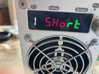

By running the self calibration process (press /hold encoder knob 15 sec till a white zero), will resume everything to factory preset.

Thank you for trying to help. I remember when it went wrong, I tried to recalibrate it by following the manual and using the good ZXD as a reference. But I got stuck on calibrating the amps as either my multimeter wasn't high enough rated current or it needed a shunt or something, but I can't quite remember as it was a long time ago. But I think your method is different and no doubt much better, I was probably leading myself up dark tunnel with no light! czy But I will give Shirley's method a go first as it's much less of a brain buster for me.
Thanks Shirley I shall give that a go. I will be brilliant if the fix is as a simple as that. I can spend the rest of the day sitting in the sun getting drunk2

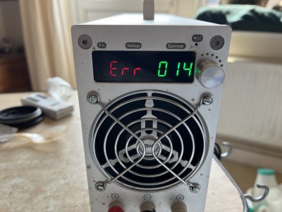

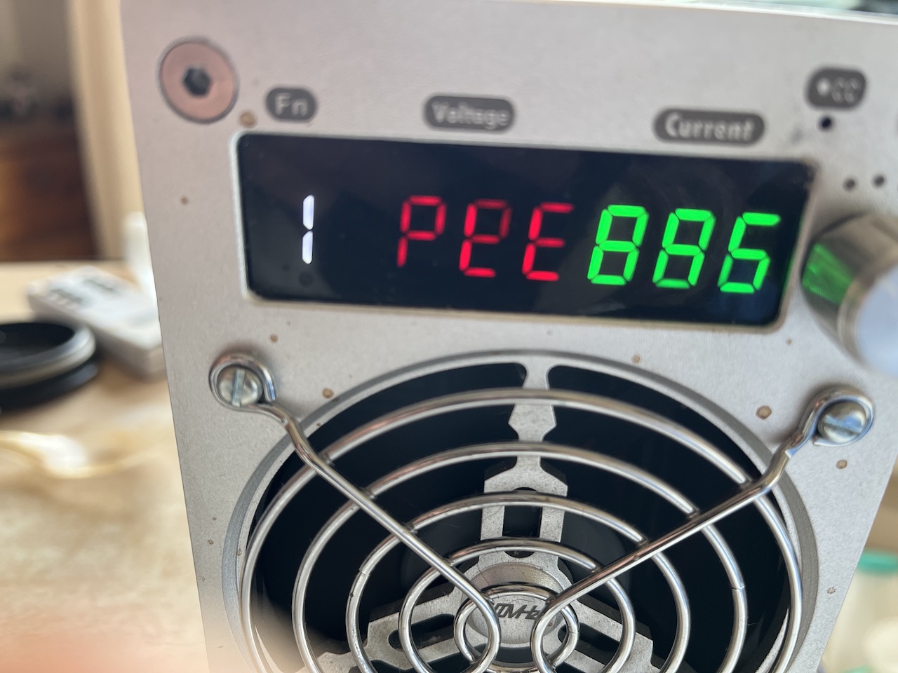

When I press and hold the knob it initially shows the FACTORY SETTINGS then a WHITE ZERO with some RED and GREEN numbers that values keep on changing, then it changes to a WHITE NUMBER ONE and the message PLEASE SHORT CIRCUIT.
I also got at one time an ERR 014 message

Yes, doing the auto calibrate will also reset most EEPROM addresses to factory settings. The autocalibration also does a very good job, probably better than a manual calibration unless you have certified accurate test equipment. Take a look at the autocalibration procedure on the web pages - it goes step by step including telling you when you have to short the output and when you have to remove the short. After that, you still have to go through the various settings because the factory settings are probably not what you want.

Leonard - Update
I've just gone through the auto calibration and it seemed to go okay, no error codes. And the ZXD is now outputting correct voltage (same as knob selected value).
ZXD seems to be working normally again which I'm really pleased about. I'll use it next time I need to charge the scooter or WC with PL8 :thumbup:
