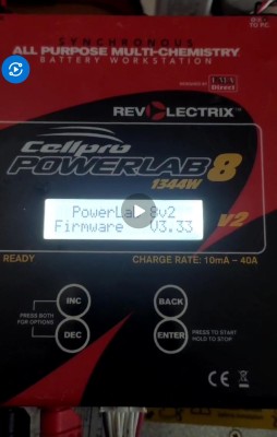

What makes you think its not a revolectrix firmware?
3.3 is just an older one. Dont worry. Just update it.

Postby shirley_hkg » 02 Apr 2022, 09:32
I didn't know it can name a PL8 after someone.
Yes, seller renamed it, and sent me vid.

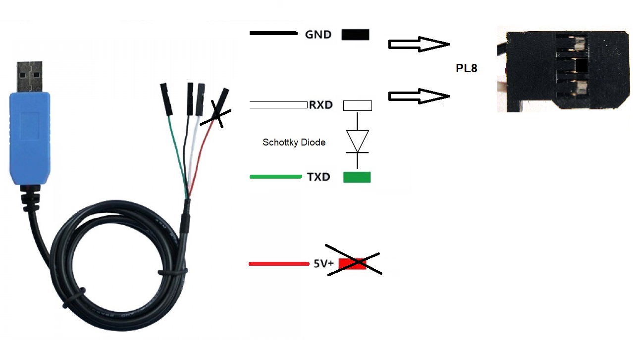

Shirley ..You showed a BLUE PL2303 in one of your pics ...make sure it is a PL2303 TA not the earlier PL2303 HX...
The circuit that you could try is simple enough and I THINK it will work...
DO NOT CONNECT THE 5V ..Just connect the GND and RX at the PL8 and place a Schottky Diode between RX and TX on the USB - TTL convertor side.
The same wiring / diode arrangement could be applied to other USB-TTL Adapters.
Postby woodygb » 03 Apr 2022, 12:35
You could pop the case remove / cut the RED 5v and GREEN TX wires , also place the Schottky diode inside jumpering across from RX to TX .Image

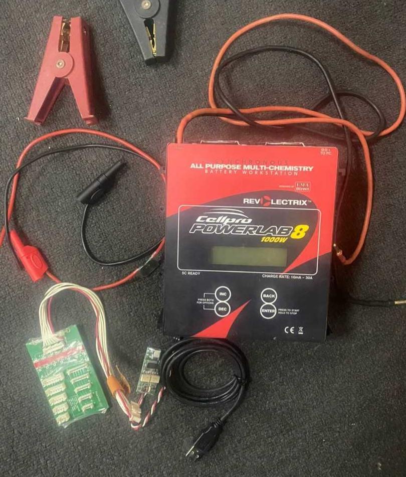

Over the last week , I find dozens of used PL8 are on sale. However, it would still be useless for those late comers without a link to the CCS. Graphing is an essential feature .
I'm thinking of sending you a PL8, so you can put up something to replace FUMI3.

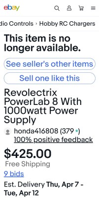

Postby shirley_hkg » 04 Apr 2022, 02:12
fishinjunky wrote: I was tempted to purchase this used pl8
https://www.ebay.com/itm/325120633919?m ... olid=10050
People are so desperate going after it ! ! ! czy :cussing
