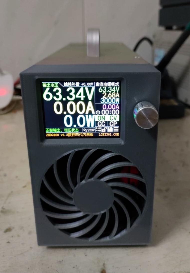

Postby shirley_hkg » 11 Jul 2022, 00:30
OK. The next generation is out for trial. New features :
-Large screen
-Compensation for volt drop on cables (4 wires mode)
-Modes Selection - Power Supply , Charger , 3 Stage Charger.
-Polarity protection in charger mode
-Bluetooth connectivity allows firmware update and App
Talked to developer that a CV-timer can be added to give better protection against thermal runaway when charging SLA battery. When fully implemented , ZXD2400 will be a peerless beast to any stock charger / supply .
LROBBINS wrote:Shirley, perhaps you can ask the kit designer if on his next software revision he can add a timer for the CV stage (with an option of either going to float or turning the whole shebang off if it times out before reaching float transition current). He already has an auto-off timer (can be set to turn off if inactive for tot time), so adding another IF statement may not be too difficult.
The logic would be something like this:
IF voltage >= 0.98 x Vcv; start timer (above float, but allowing for imprecision in voltage measurement - or it could be calculated as half way between float value and CV value in case using something other than 930 for the float voltage calculation)
IF timer >= 8 hours or Amps <= 0.001 X base Amps; shut off or go to float. This will be higher than 0.001C10 = 0.0063 Amps but Eprom 74 = 1 is the lowest that can be set; e.g. if base amps = 30, it will be 0.03 Amps which is approximately 0.005C10 for the P1500, but I would guess awful close to as fully charged as with 0.001C10).
Beta models are undergoing debug trials . Wait and see.

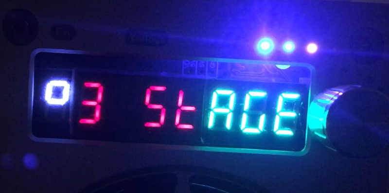

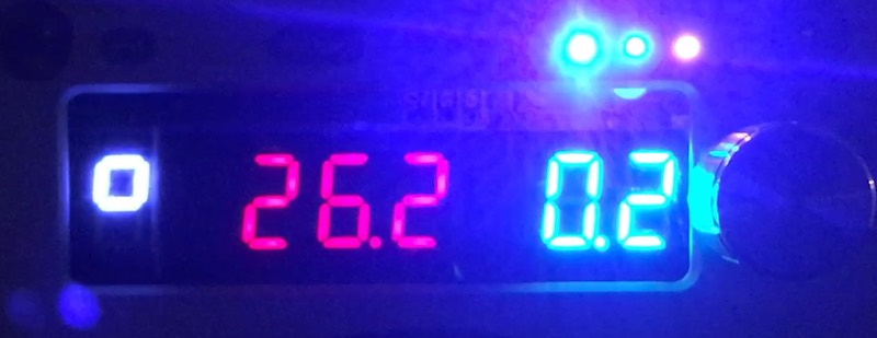

Postby jefferso » 10 Aug 2022, 01:07
10 days shipping to UK is now only £6 more than that of the 80 days slow boat journey. :dance cheers
I finally got this unboxed and starting to test. It ran cool and quiet while charging at 22A using the Anderson SB50 plug. Amazing.
I'm just going through some settings to make sure I understand them. I'm using it to charge MK Gels, so is this setting good for the 3 stage charge?
26.2 V and 0.2 A ?
jefferso
Posts: 333
Joined: 18 Jun 2016, 22:18
Postby Burgerman » 10 Aug 2022, 03:07
You need to set it to:
20A is fine. I do a little more. MK say 23A is ok for GRP24.
CHARGE voltage 28.2V maximum at 20C (and a little less if its warmer than that). Say 28.00.
Then it needs setting to terminate this CV stage at the point where the battery current stops falling by 0.1A over 1 hour. This usually means that you will need to set 0,3A AND 27.0V on the "float" screen.
The float voltage needs to be around 13.5V (27.0V) and it should fall to this level when, as above the current drops automatically to 0.3A.
