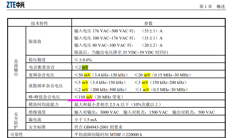

Ripple noise levels of this machine .
Postby Burgerman » 12 Aug 2022, 01:31
And 220,000 hours mean time before failure. Or 25 years plus, on time...

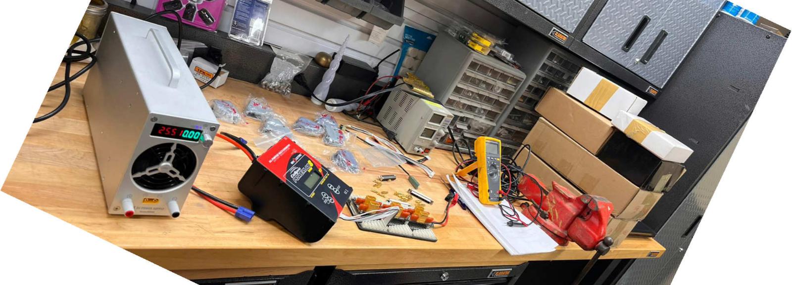

Of the beta units, I like this one .....

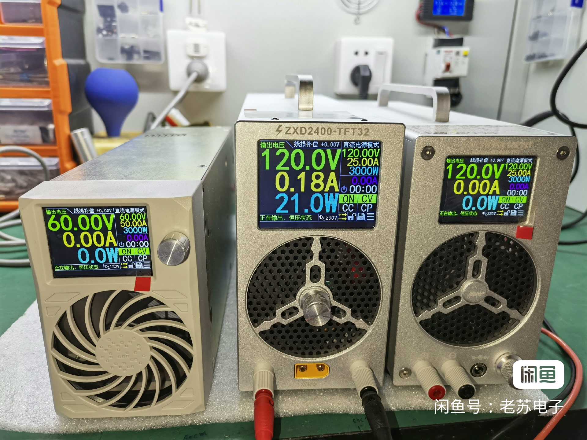

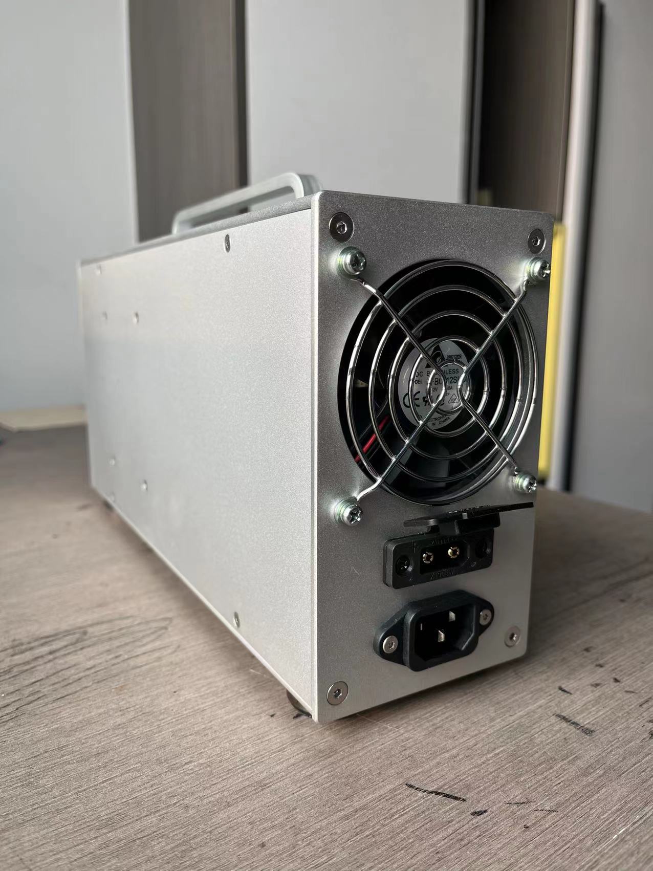

OK. The next generation is out for trial. New features :
-Large screen
-Compensation for volt drop on cables (4 wires mode)
-Modes Selection - Power Supply , Charger , 3 Stage Charger.
-Polarity protection in charger mode
-Bluetooth connectivity allows firmware update and App
Latest update. The 4th generation is in market now. Price is up by £15, with SB50 & XT90. Display is Chinese for the time being , (BT updatable 2024).
Postby Gnomatic » 15 May 2023, 17:16
-Large screen
I see the XT90 on the back but can't see any SB50.

Postby shirley_hkg » 16 May 2023, 04:06
You will be the first one to add an Anderson SB50 as well. cheers

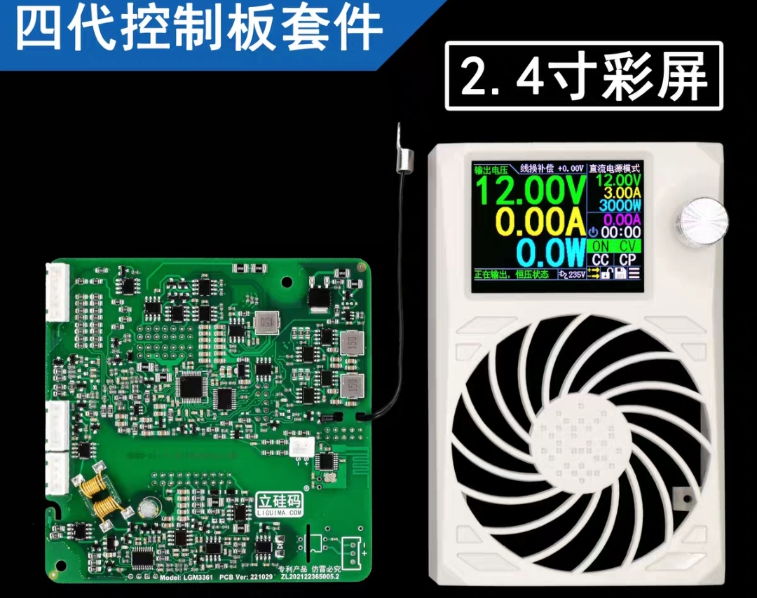

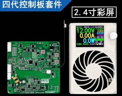

ex-Gooserider wrote:Any option to upgrade one of the earlier units?
I sent back mine to upgrade actually.
Just swap 2 non polarized capacitors .
You need new control board, of course. $40

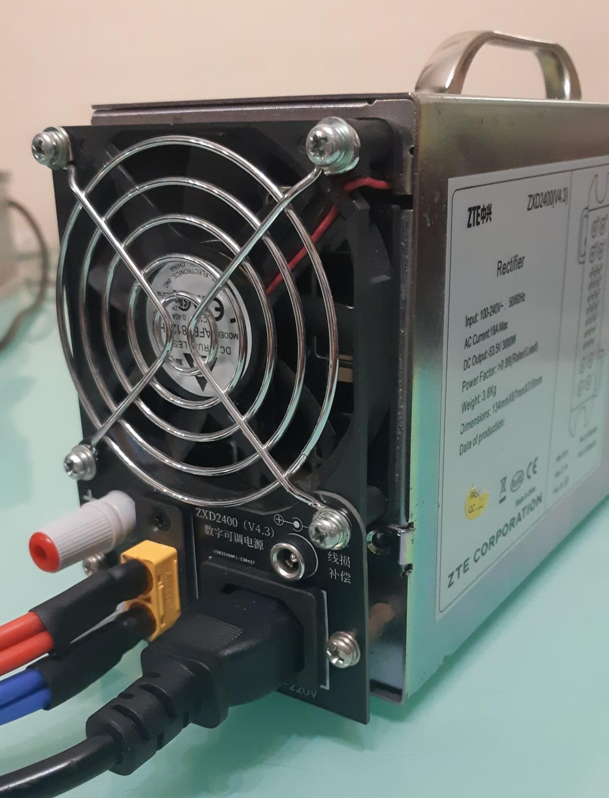

Extra gadgets,
Large screen 3.2"
Nicely arranged connection board. cheers
Anything you thought about. :dance

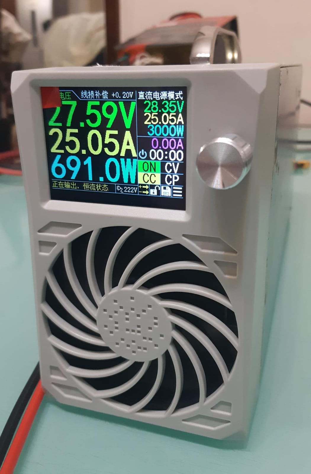

I have had my first 4th generation ZXD .
Firstly, it is much much quieter. Fan noise is unnoticed arm's length away.
Adjustment is 0.01
BT connectivity
4 lines load drop compensation
Developer replied that Lenny's suggestion to add trigger_to _float timer will be added next year, so do English menu.

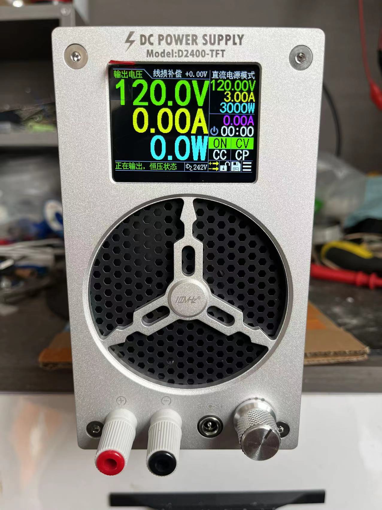

Will change it to aluminum outfit, with Anderson SB50 added, if shipped by shirley_hkg . :clap :clap
Price is more or less the same as I can ship it in China now.
Much cheaper & faster.
