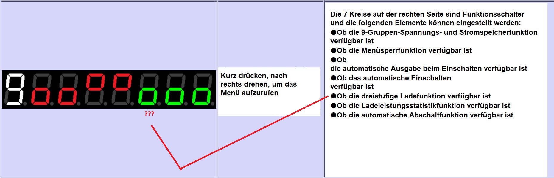

Hi guys! I have a ZXD2400 too. It is one of the series 1. It works great, - thanks to Shirley_hk. :wave: Up until now I have only used it as a desktop power supply. Apart from voltage and current, there was nothing to do. Now my original charger for the Optimus2 is defective and I have sent it in for repair.
Now I want to set up my ZXD2400 as a charger by using the 3-stage charging function. I want to do it like Steves1977uk - via XLR - 12 amps.
Which of the circles represents the 3-stage charging function?
thanks for help.

Postby shirley_hkg » 19 Sep 2024, 02:06
Yes. The one you pointed to.

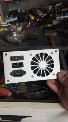

Postby shirley_hkg » 20 Sep 2024, 10:25
Seems no room for SB50. Be prepared to swap out the XT90, if an Anderson were to be installed.
Burgerman wrote:I prefer the last one. The laid down on its side one.
Have some progress on adding Anderson SB50.

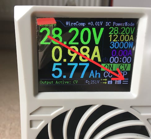

Postby Burgerman » 22 Sep 2024, 04:31
As a rule with XLR charging you will only lose maybe less than 1% due to wiring. Where you lose out is in the time it takes to charge. Because while on charge the natural battery voltage once around 95% charged is dragged high. To maybe 13.4V due to the opposite to peukert. The surface charge is high. So if charging at 14.1V for gel for e.g thats a difference of only 0.7V per battery. So any resistance in the loom, means you might lose a fraction of that 0.7V difference and so less current flows. This means that the bulk of the charge isnt really affected.
But at the poit where it naturally slows down as the battery becomes more charged, then now it slows down a lot more. It may add an extra few hours to the charge compared to say an anderson connector and some more substantial cable.
So it causes a bit time difference. But no real losses. Where there are losses is inside the battery. The higher the charge voltage is, the more that some of the charge energy goes into splitting water into oxygen and hydrogen. So at the last part of the charge, during CV, then the battery wastes some energy getting hotter. The battery is recombinant. Which just means that at low currents, where gassing is slow, the battery recombines these gasses back into water. That process produces heat too. So in the first 80% of the charge its about 99.9% efficient! The last 20% gets more and more wasteful as time goes on. So how much gets wasted as a percentage overall depends on the charge voltage, the battery itself, and the length of the CV stage. But you likely waste 5% on a full charge. Or should I say you SHOULD be returning around 5% more in watt hours that you took out. In order to get a complete charge.
Posts: 70441

Postby Burgerman » 22 Sep 2024, 10:50
That then works the same as the PL8 does.
It uses the cell balance wires to do the same thing.
When charging 1 cell or all 8 cells, the balance wires (OR THE CHARGE WIRES) sense the cell / pack voltgage during the breaks in the high frequency pulse width charging.
Its switching all the time at one of 3 different frequencies. It measures volts while charger isnt charging every few ms.
So the individual cell voltages at top of page are accurate, and measured during the charger "OFF" periods.
The overall voltage displayed lower down, is the average voltage at the charger required to achieve the voltage at the top if lead or the cell voltages if lithium. Which is why they are not exctly the same and dont match. Although they will get closer as the current falls away.
Read the top one for accuracy! Not the lower down one as it will usually be a little higher voltage but its not the battery voltage... Even when no balance wires are used.

Postby shirley_hkg » 22 Oct 2024, 07:34
I've made one laying on side , with XT90 and Anderson at the back.
I prefer to stock case one as it's more compact.

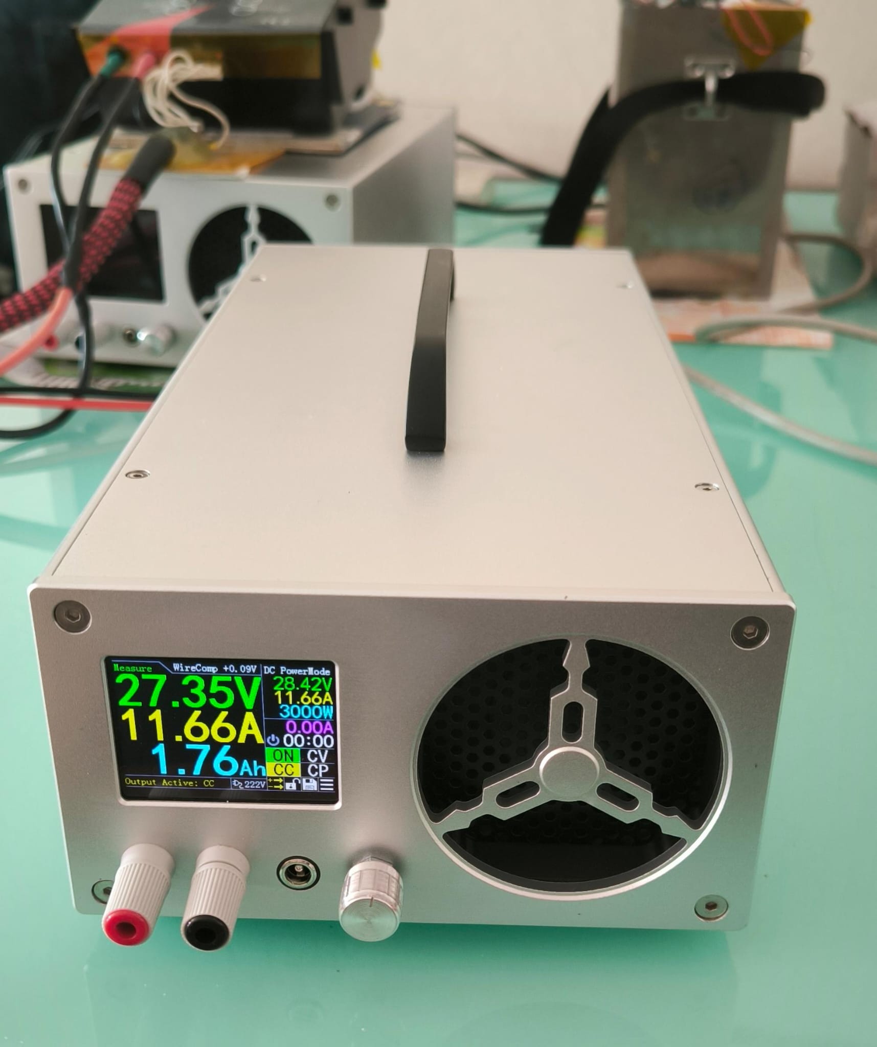

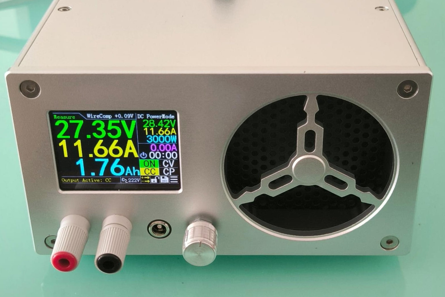

Postby Burgerman » 28 Oct 2024, 19:08
I just ordered on of these newer version ZXD supplies/chargers from Shirley.
These are 0-60 Volts DC, 0-50 Amps, 3000 watts. (same as older ones were, better display, quieter, more connectivity options)
And are either a power supply, which means it can be used as a quality high power capable bench supply, as a charger 2 stage CC/CV charger, or for lead batteries it can be used as a 3 stage charger.
All user configurable. These things are converted from a high reliability 24/7 duty cycle telecoms rack mount supply used in industry. They are electrically very robust and high efficiency. They work on 240V (and at half power on 120V AC systems. 25A DC output instead of 50A).
They can be configured as a 0-120V and 25A clean DC supply too should that be of interest.
I use 2 of these already as lead/AGM/Gel battery chargers at 12A and proper settings and 3 stage (via XLR) to give a superior battery charger than any mobility charger. And at 30A via Anderson. 50A on Odyssey.
I also use them to power PL8 chargers for lithium chairs and lithium/nmh etc hobby stuff.
Rear Panel Connections:
Anderson 50 (120A capable)
XT90 (90A capable)
Front Panel Connections:
4mm banana connectors for bench use on front. (Only use 4mm front connectors for 25A or less).
