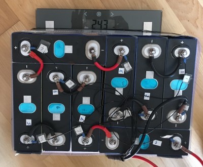

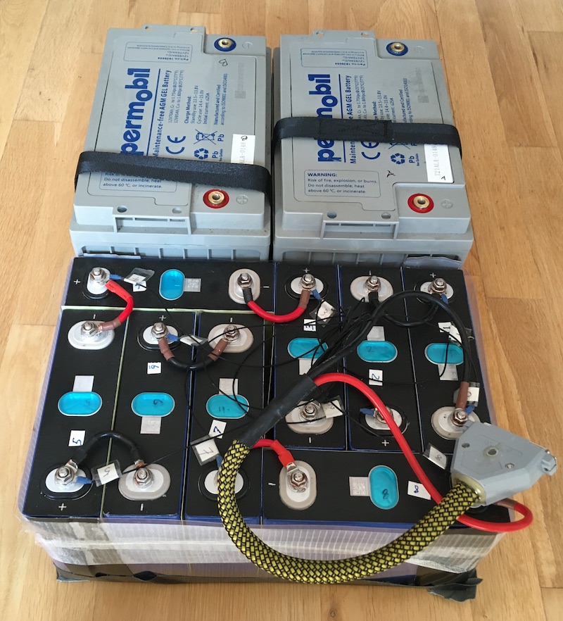

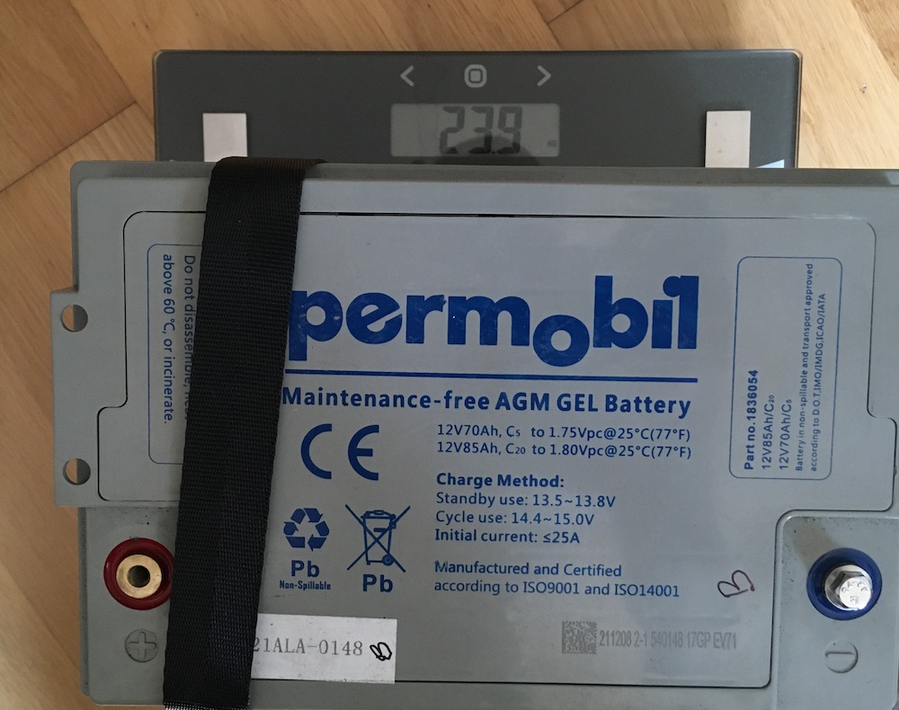

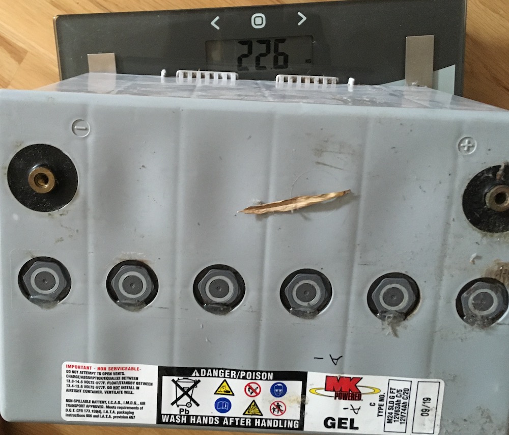

My 160Ah pack weighs 24.3kg.
A single Permobil AGM Gel weighs 23.9kg.
A single MK Gel weighs 22.6kg

Postby Burgerman » 26 Aug 2024, 17:27
Amazing that you can get 3x the range, 10x the lifespan, from something that is now half the price, half the weight and 2/3rds the height.
And if you dont mind them being a bit explodey you can do even more range with lithium ion cobalt (phone/laptop/tesla) type cells. But I do.
The 230Ah cells from EVE are 4.11kg each. 32.88 kg for 8.

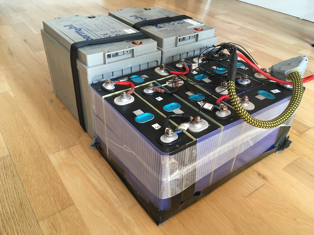

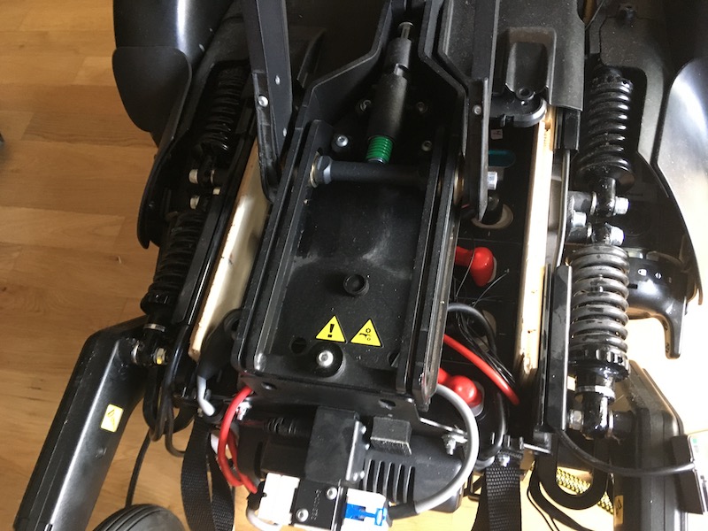

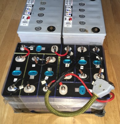

Postby jefferso » 26 Aug 2024, 18:45
I was a bit worried that the length of the pack is a bit more than the two MK Gels next to each other. But when putting it next to two Permobil batteries, it seems just about the same so I hope it will fit lengthwise. Width and height won't be a problem.

Postby jefferso » 26 Aug 2024, 19:26
I have 2 MK gel batteries manufactured in 2019 which were stored for more than a year so probably have no real capacity left. And I have 2 Permobil AGM/Gel batteries from 2022 which might have 50% of their capacity left. Does anyone have any recommendation on how best to get rid of them? I thought maybe I'd list them for £10 on Gumtree and see if anyone is interested.
I'll keep my current MK Gels as backup once I finally get this pack installed.

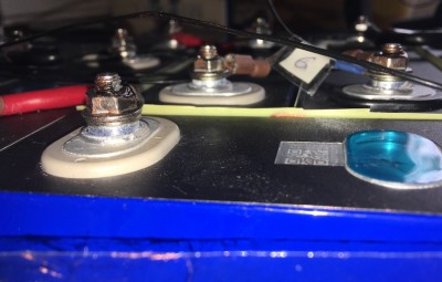

Postby jefferso » 26 Aug 2024, 20:21

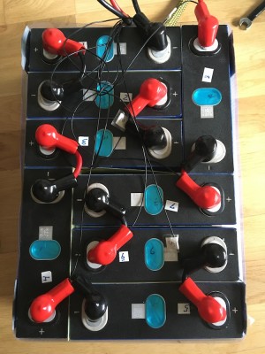

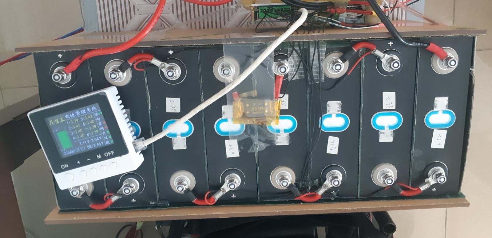

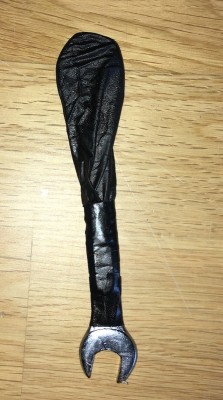

When assembling the pack, despite admonitions to be careful, a spanner made contact across a couple of cells and made a scary spark. It destroyed part of the stud and nut on the negative terminal of cell 4, but the pack so far seems normal and balanced fine. I was worried it welded the nut but it loosened and re-tightened without much trouble. For subsequent work, the other end of the spanner was covered with the finger of a nitrile glove and electrical tape.
I got some Battery Terminal-Cover Boots Insulating Protective Lug Cap 12x20mm from ebay.
https://www.ebay.co.uk/itm/375521793950
They don't fit exactly but seem to be doing a decent job of covering the studs and interconnect and balance wire ends.

Postby Burgerman » 26 Aug 2024, 21:20
Smaller versions of those terminal boot covers are also available on amazon. I have some here.
Posts: 70132
Re: Group 24 cells
Postby jefferso » 26 Aug 2024, 21:43
Burgerman wrote:Smaller versions of those terminal boot covers are also available on amazon. I have some here.
What size do you think would work best?
I also see 12x16mm
https://www.ebay.co.uk/itm/383045679251
Not sure that I'll ever take them off now that they're on, but might be good to have some better fitting spares.

Postby fishinjunky » 27 Aug 2024, 12:59
your pack looks good and organized :thumbup:. I also used those boots on my pack. We did the same thing with a wrench but it was on the lead battery luckily banghead . We tapped the handles on all our metal handled tools for building a pack.

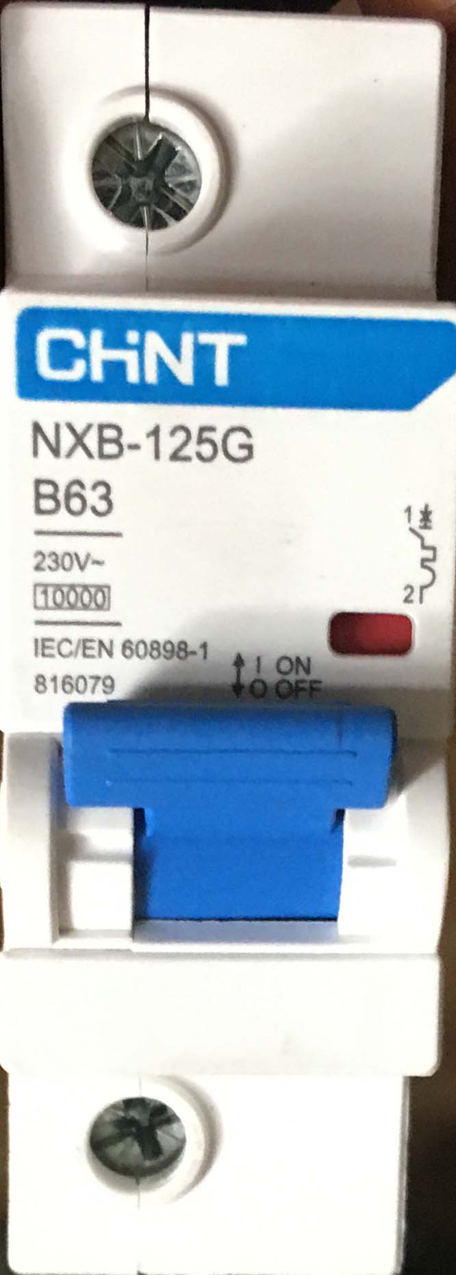

Postby jefferso » 28 Aug 2024, 17:28
Does a DC circuit breaker care which way the electricity is running through it? My original plan to connect the long grey cable from the breaker to the red positive cable, then the short grey cable to the positive of the battery pack won't work because the short grey cable won't reach the positive terminal on the pack. So if I connect the short grey and the red, then use the long grey to attach to the positive terminal, it should reach, but I think it will reverse the direction of the electricity.
jefferso
Posts: 325
Joined: 18 Jun 2016, 22:18
Re: Group 24 cells
Postby Burgerman » 28 Aug 2024, 18:52
No. Its just a bi metalic strip. It bends and opens when the current warms it up.
However, most of these things are crap. And they start tripping out at lower loads as the contacts get a bit oxydised and so heat up too fast under even light loads. And they dont trip under very high loads sometimes for too long!
I prefer to just use a 150A MIDI fuse. Look on amazon. These are tiny, have a 5.5mm hole at each end DRILL that slightly to 6mm. Then it can bolt directy to a battery terminal. And then it can go between any 2 cells.
I am considering adding a 200A one between EVERY one of my 8 cells for safety reasons. Not needed but ...

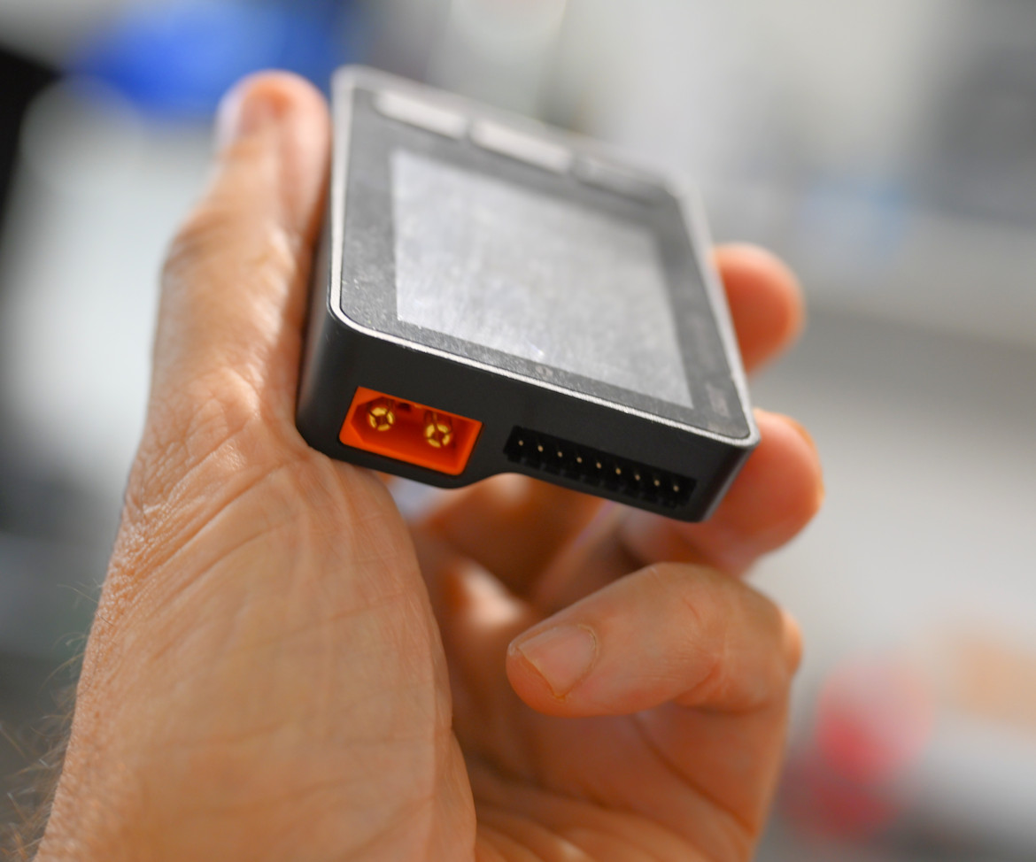

Get yourself one of these:
https://www.amazon.co.uk/ISDT-BattGo-Ba ... B07WZFS7D8
It has a nice colourful bar graph display, and shows you your battery state. Its accurate AT THE ENDS, and its less accurate everywhere else because of the nature of the super flat discharge curve. But its not bad.
You need an 8S balance lead. Or two. If you cant find a 600mm one, get 2 300mm ones. On the ISDT BG-8S end, plug it in... On the other end add the 9 balance wires to another one of your charge cable connectors. It rolls up small. Esily goes in a pocket or a small string draw bag you ca hang on the chair. Mines old and a bit scratched. Its a bit toy like and plasticy... But its pretty good for our purposes. I used it initially so I could get some idea of what was happening. But now I ave a good feel for whats going on just by looking at the R-NET meter, judging distance/work, and see what I put back with the PL8. For a week or two I noted the precentages, and the distance (on the joystick - reset the trip miles!) etc until I could get a grop on how it all worked. I no longer use it. I wil do on my bigger 230Ah pack whan it arrives for a while. See how many days I can go...
Just plug it in every now and again to get a quick idea of battery state. Dont leave it connected if you are not using he chair as it slowly drains cells 1 and 2 to power itself.
Its also user calibratable. Quite easy to do. If you have a decent multimeter that you trust.
Also does a bunch of things that you wont need or want with RC gear. Ignore that.

Postby jefferso » 28 Aug 2024, 21:02
Burgerman wrote:No. Its just a bi metalic strip. It bends and opens when the current warms it up.
I think this is the one. So far it hasn't tripped with the lead acid batteries. It's in the circuit now. I'll see how it works with the new pack.

Postby Burgerman » 28 Aug 2024, 21:17
While it works, why not. Much of this depends on the user though. Serious programming, drive it like you stole it and it will trip. If you dont it wont! Unless its faulty or a bit oxydised.
One thing. Some are relatively high resistance. (its why they get hot and then trip to begin with) If its between cell 4 and 5 and you see funny balance curve issues here that will be the cause. If that happens then connect to one end of the battery instead.

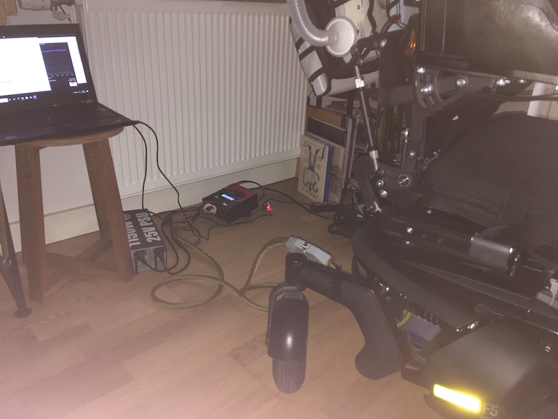

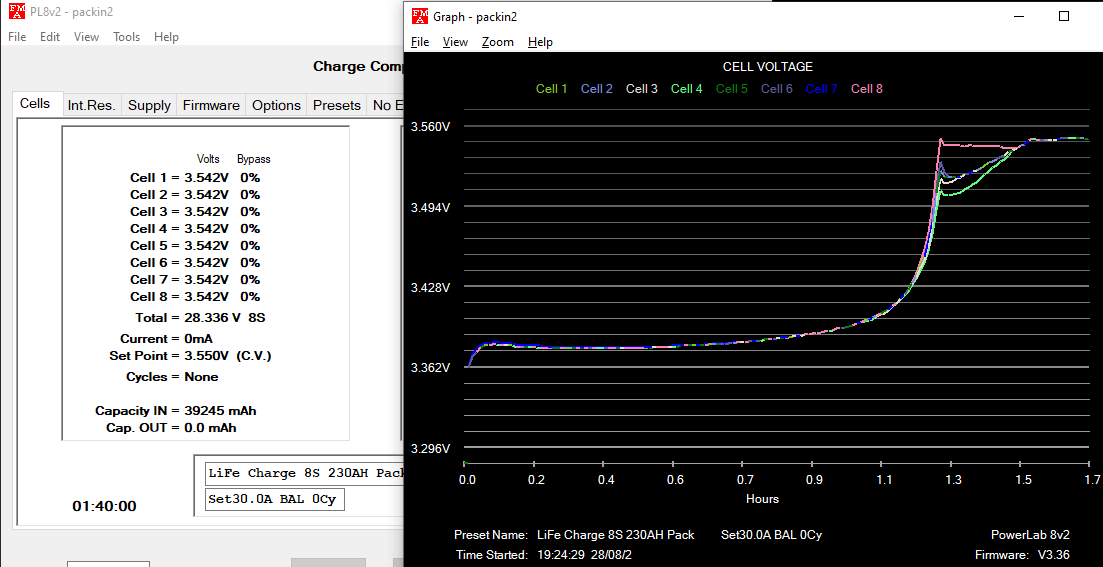

Postby jefferso » 28 Aug 2024, 21:30
Burgerman wrote:Have you tested this yet?
I haven't tested it yet except for turning it on and moving it around in the room to a different position. I just did its first charge inside the chair. I'm doing a bit of discharge now since I'm not sure if I'll get to use it tomorrow.
I still have a few things to do. There's a finger's width of space on each side so it needs something to keep it from sliding side to side, though it's wedged in front to back pretty tight.
I have to figure out how to route the charging cable out. Right now it's coming out the side. I temporarily taped it up so I can use it in the house. I might have to cut a hole in the top plastic shroud big enough to pass through the connector.

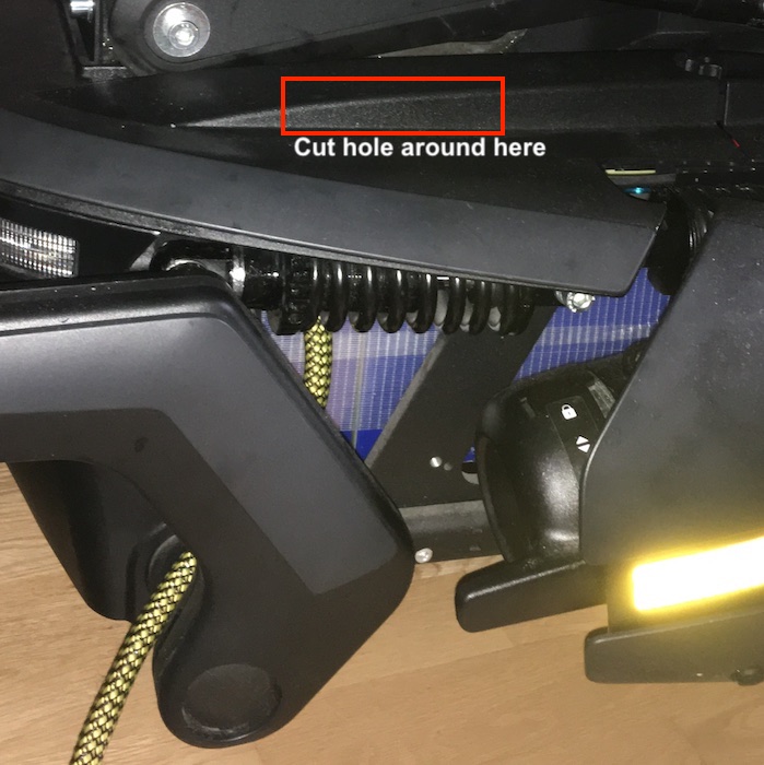

Postby jefferso » 28 Aug 2024, 21:39
The circuit breaker is between the chair positive cable and the pack's positive (cell 8 +). At least I hope so, if I've done what I think I've done. So it's not involved in the charging at all. I should probably add one of those fuses to the charging circuit.
Here's how the charging cable comes out right now from the side towards the back.

Postby Burgerman » 28 Aug 2024, 23:03
Have a think before cutting great big holes!

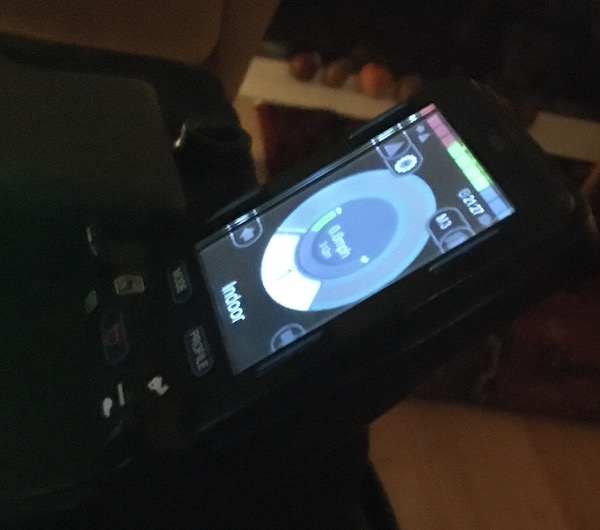

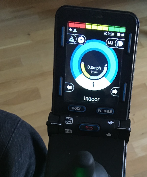

When I was discharging, the wheelchair controller screen seemed to show no green bars. I couldn't understand why it would suddenly go down but figured it might return to normal when I finished the discharge. It was the same after unplugging the charger. I asked my friend to confirm and he said all three green were lit up even though when I looked at it, they seemed dim. Turns out if you look at the joystick controller screen from too far to the right side (I never normally see it from the right side), the green shows up as dim. It was actually showing full the whole time.

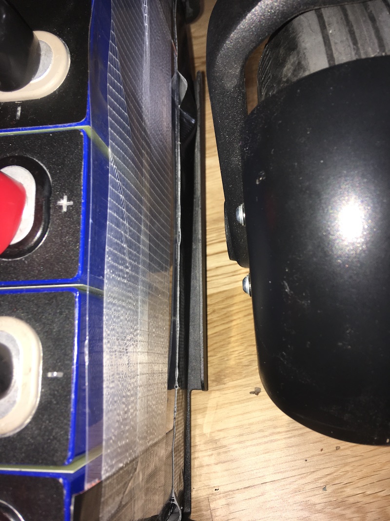

Postby jefferso » 29 Aug 2024, 18:05

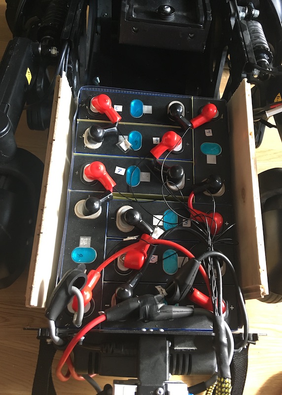

I had some scrap wood flooring which fits really snugly in both sides so it's now wedged in there.
I have a few layers of acetate and tape underneath but no wood or acrylic under it yet.
Still not sure how to route the charging cable. I was thinking of cutting along the inside edge of the plastic shroud so it could just be a small notch but the seat rising mechanism travels along that edge so it might interfere so might have to revert to the great big hole idea. It's now taped to the rear castor support temporarily again. I might have to revert to the old batteries for a while if I can't get it resolved tomorrow.
