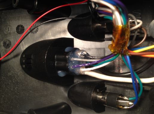

I opened one of my joystick, the pictures attached seems not same as your picture?
I can open all my 5 joysticks to check if any one may match, because the remote control is a must for my stuff. Or maybe I can got one same as yours?
Best

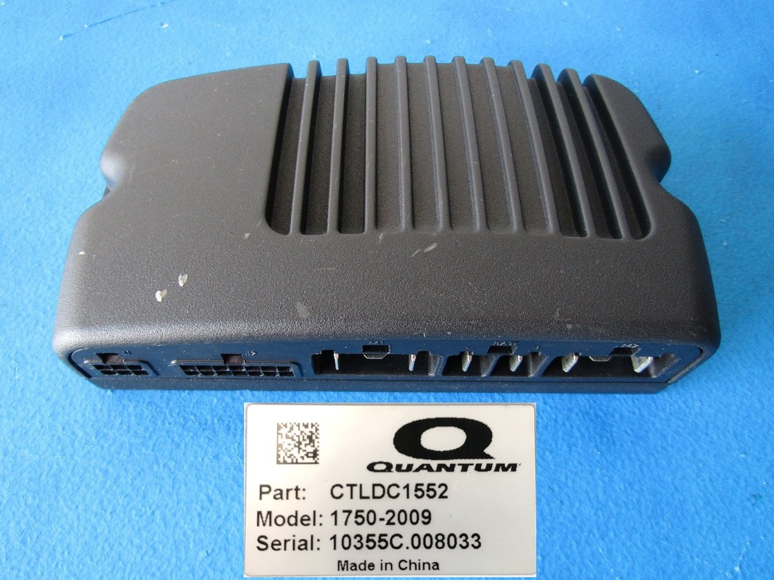

I had previously wondered if the 50 of the part number / code was an indication of the model and it is now confirmed that it is indeed an indication of the powerbase type.
So we now have more definitive info on what lead / comms protocol is used by certain Pride/Curtis models.
The Curtis EnAble40 LOOKS the same as a Pride/Curtis CTLDC1552 or 1750-2009 and the EnAble40 manual suggests serial type comms ( RX / TX ).
It is however a variant of the EnAble50 and uses CAN.
A Curtis 1740 powerbase is an EnAble40 and a 1750 is an EnAble50 ...the 40 is programmed with a serial type lead and the other 50 uses CAN.
I am assuming that if the control system is an NE model that it is an EnAble40.... a check of the powerbase number should confirm this.

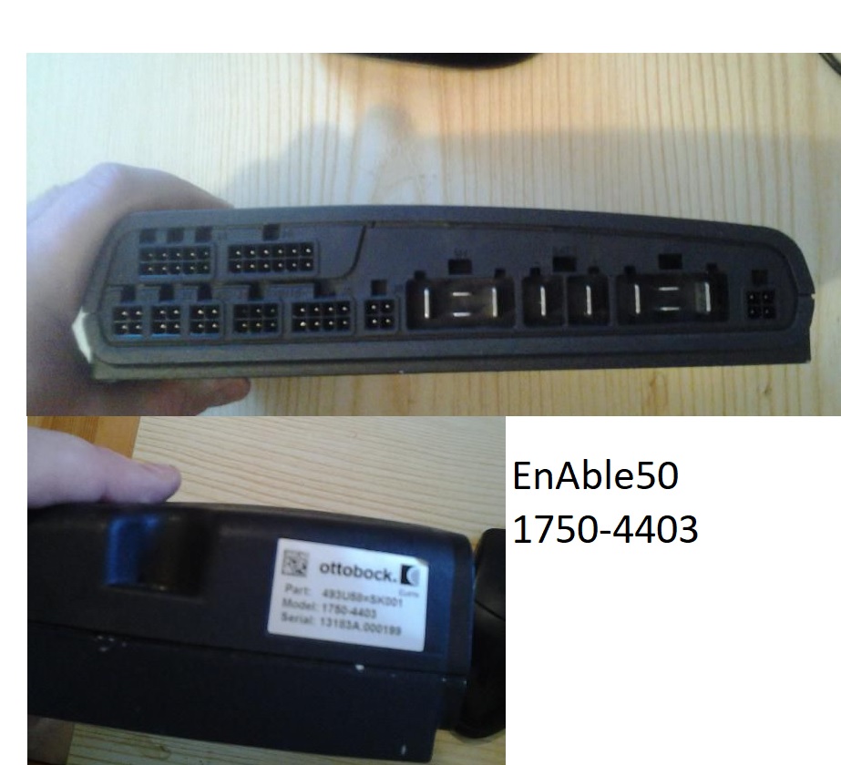

Re: Q logic/Curtis Cable end
Postby woodygb » 06 Aug 2018, 11:04
EnAble40
CTLDC1552 ...LOOKS the same as the EnAble40 but is an EnAble50 variant.
EnAble50

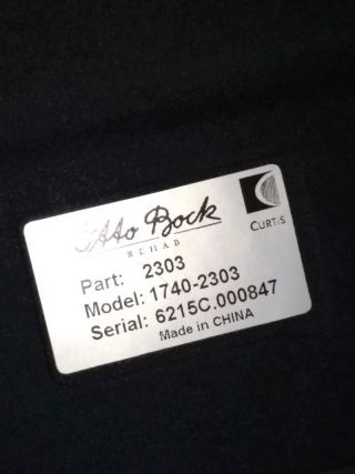

Postby Mind The Gap » 06 Aug 2018, 11:59
Hi Woody

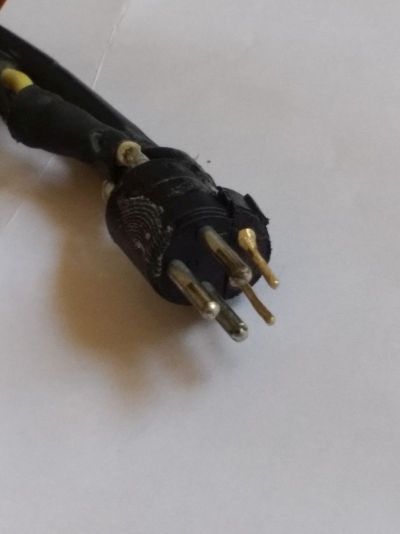

Have made 5 pin connector that fits socket. Have pictures but cant seem to upload them only 65 kb.
The label on the module reads as follows.
Otto bock
Part 2303
Model 1740-2303
Serial 6215C.000847
Cheers Paul
Postby woodygb » 06 Aug 2018, 12:27
1740 is the number for an EnAble40....which should program via a Serial type cable using RX and TX.
Did Rover sort you out?

Worked out the picture problem up loading 2 pictures .
Cheers Paul
Mind The Gap
Posts: 183
Joined: 02 Feb 2015, 21:37
Location: S.E London
Postby Mind The Gap » 06 Aug 2018, 12:37
woodygb wrote:1740 is the number for an EnAble40....which should program via a Serial type cable using RX and TX.
No. Will have to try to make cable.
Have a look at pics and see what you think. Fits in nice and firm.
Cheers paul

Postby woodygb » 06 Aug 2018, 12:40
I have a cable here that is ready for you to solder to that plug if you want to try it.
Postby Mind The Gap » 06 Aug 2018, 13:00
woodygb wrote:I have a cable here that is ready for you to solder to that plug if you want to try it.
yes please woody.
