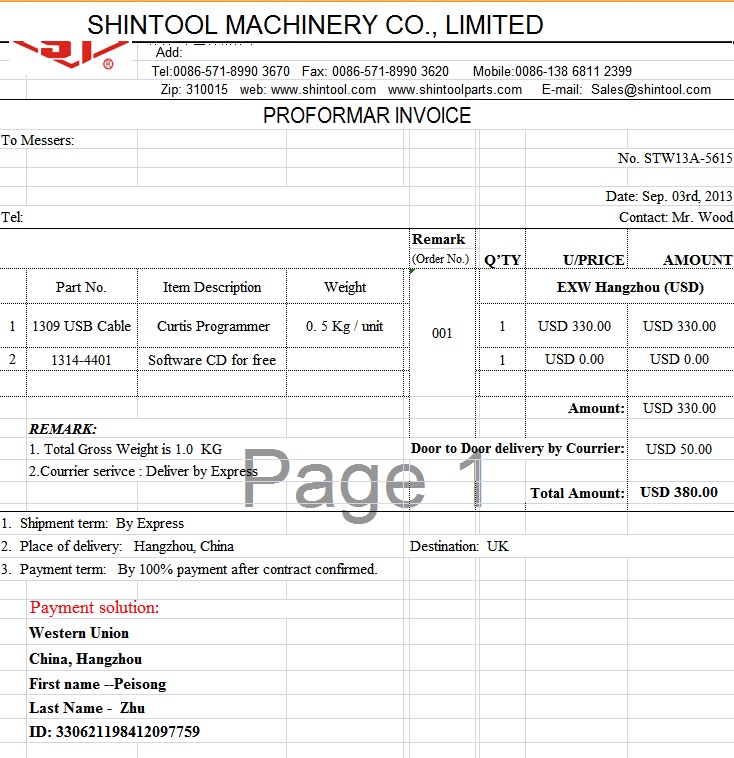

Postby woodygb » 29 Dec 2013, 15:30
SHINTOOL MACHINERY CO., LIMITED quoted me $380 U.S. dollars for the NEW 1309 USB lead .. OEM level.
Postby vinsen » 29 Dec 2013, 15:35
woodygb wrote:SHINTOOL MACHINERY CO., LIMITED quoted me $380 U.S. dollars for the NEW 1309 USB lead .. OEM level.
This is the price of the cable ? :shock:
vinsen
Posts: 79
Joined: 28 Dec 2013, 09:41
Location: Russia
Postby woodygb » 29 Dec 2013, 15:38
YES.... and before you ask ..NO ..I didn't buy it.
1309 PRICE.jpg (203.73 KiB) Viewed 14325 times
Postby vinsen » 29 Dec 2013, 15:44
http://www.shintoolparts.com/product.asp
We have done ...........it just takes time . Expensive for the cable .
.............Maybe this is the price for the CD and cable ? .
.........And in General on this forum this cable someone who has ? Show the insides of this cable .
