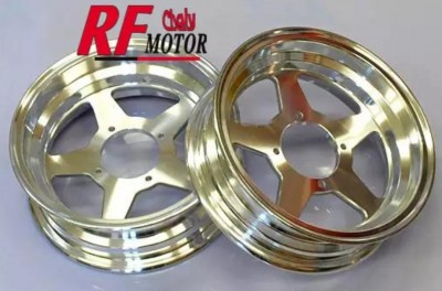

Steve , are you using 10" tubeless rim ?
Does it have lid over the rotor edge , or is it supported by the 5 bolts on the outer face only ?
Re: RoboteQ GB Project
Postby stevelawiw » 02 Dec 2019, 13:56
Yes 10" SIP 3 inch wide tubeless scooter rims.
No 'lid', it's bolted to the original mounting holes, 5 x 8mm.
Too much work on the other side of the wheel for me to ever get any more made like this, there are 5 slots milled out of the rim and 5 lugs bolted to the rim and the original Invacare wheel outer which itself had to turned down on a lathe. I had a picture of 'the other side' I was going to post, but I can't find it. I'll have to take another the next time the wheel is off.
Shirley, is it possible for you to source 10" wheels like you supplied to Burgerman but without the 5 large holes drilled in the faces? They would be a really good starting point for a new set of wheels for me :biker

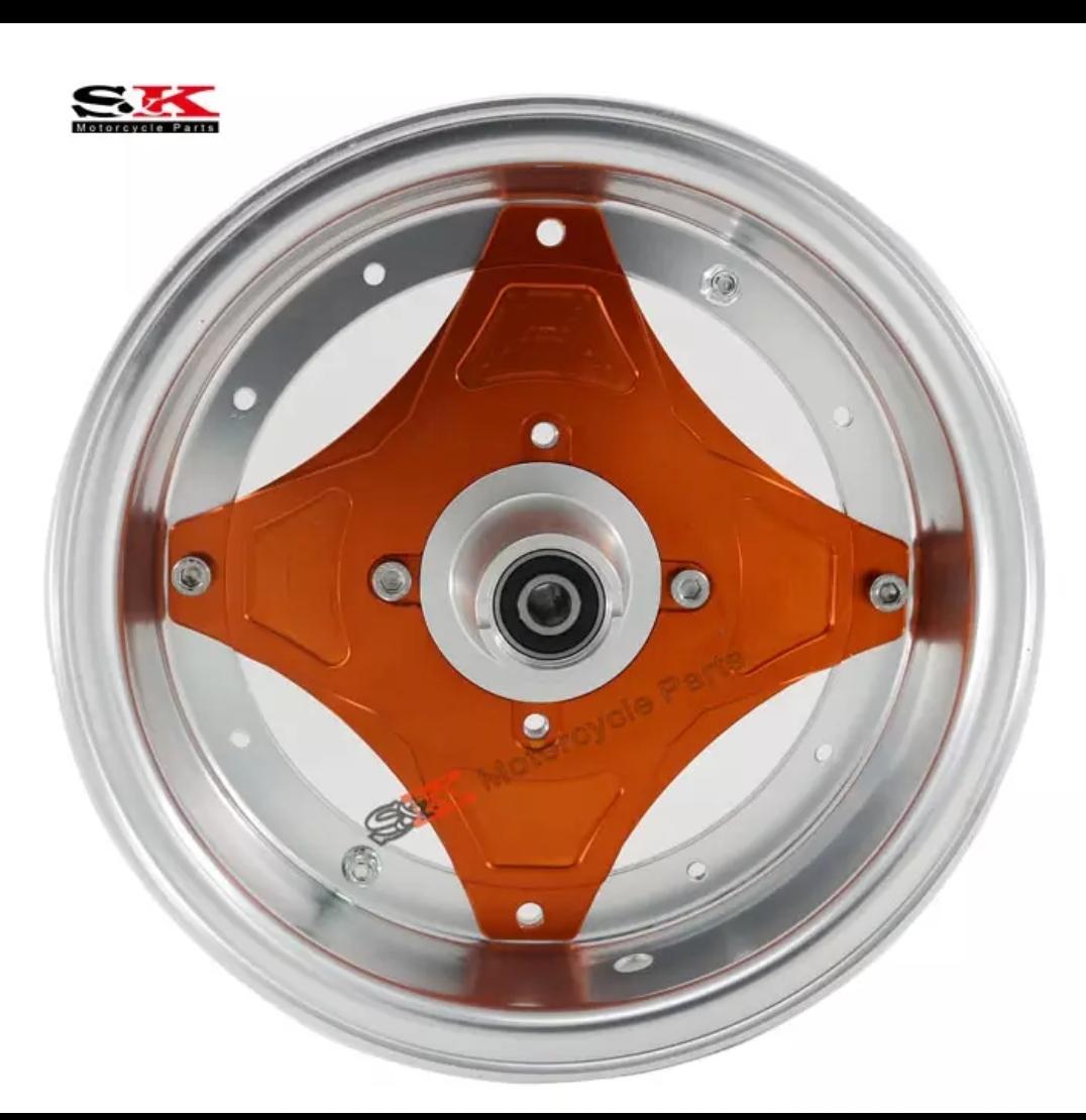

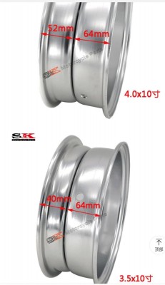

Postby shirley_hkg » 02 Dec 2019, 14:34
Yes , available in 2.5/3.0/3.5 wide @£20 or so.
The next one is split rims , not tubeless .
Postby stevelawiw » 02 Dec 2019, 14:41
The second picture is split rim? How much are they Shirley? Do you have a sideways pic? I could seal them couldn't I? O but they probably won't take a tubeless tyre :argument
Something like that that could take a tubeless tyre would be perfect, as It's easy to attach an ally disc to it :thumbup:

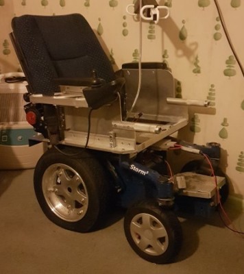

Postby stevelawiw » 04 Dec 2019, 22:18
I had a go myself today at recording a top speed using the Ulysse Speedometer app on my android phone, I got it up to 10mph and that was enough for me! I'll never want to go faster than that in my indoor/outdoor wheelchair :shock:. Maybe if I ever swap and put it into my outdoor/indoor chair I might venture maybe one or two extra mph (it has a longer wheelbase), but 10mph feels bloody quick!
I'm going to get my stuntman(nephew) back and get him to try, because I have to know what it's capable of, even if I'm never going to use it.
