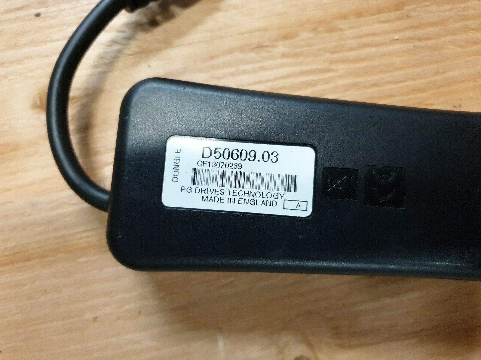

Postby TheFrankZebra » 11 Sep 2019, 23:58
So, there’s a dealer and an OEM level dongle, but are there also two versions of the handheld programmer? One the DTT and the other an OEM one? And I think I missed my chance to buy it, but someone was selling Quickie R-Net Programming Software, but it not only came with a disc and some cables, but some kind of Quickie USB to Can box. Does anyone know what it is/was? Is it possible (or certain?) that it was OEM? I will post a pic if I can.
TheFrankZebra
Posts: 14
Joined: 07 Jan 2019, 21:15
Location: New Jersey
Postby Burgerman » 12 Sep 2019, 00:26
It may be. Theres at least 20x more dealer ones to OEM around.
If the dongle has an A on it in small box, its dealer. If its got a B on it its OEM
Posts: 71117
Postby Burgerman » 12 Sep 2019, 05:57
Like this.
This one has an A in that square. That means its a DEALER (useless) version. Although if you dont mind a fight there are ways around this.
If it was a B then it is OEM.
Posts: 71117
