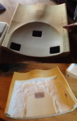

Remove the cells. Add a layer of plasticine. Sit on it for 15 mins, move about a bit, reach for stuff, tilt, recline, etc then get off it. All will then be obvious. Measure. Give plasticene to kids.

I can do the plasticine bit moving and reaching isn't going to happen if I could do those I wouldn't have pressure sores :)

Postby Burgerman » 02 Oct 2019, 17:26
Make sure its deep enough and warm. Or it will be too hard. Alternative, buy a 10 lb tin of glazing putty. Put it in a big plastic bag. Sit on that. All of these are untried by me - just ideas. But even a large bag of salt (dishwasher salt in big bags) might work.
You could even just sit on a foam actual cushion and get a carer to slide a hand in.
Or... Get a sheet of paper, and a sheet of copy paper both cushion sized and sit on that and wiggle.
