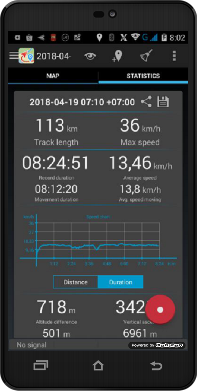

Postby expresso » 18 Apr 2019, 02:16
whats a good app for this - the ones i have keep closing on me - cant understand why - i start it - leave it alone - go ride - when i check its not open no recording
any good apps i can try ?
Re: Lithium Build for Magic Mobility X4
Postby snaker » 18 Apr 2019, 02:35
I am using this one. It works fine and stable.
https://play.google.com/store/apps/deta ... cker&hl=en
Posts: 1234
Postby Burgerman » 18 Apr 2019, 02:36
So its a bit better than before then? :clap
We have a winner.
Posts: 69905
