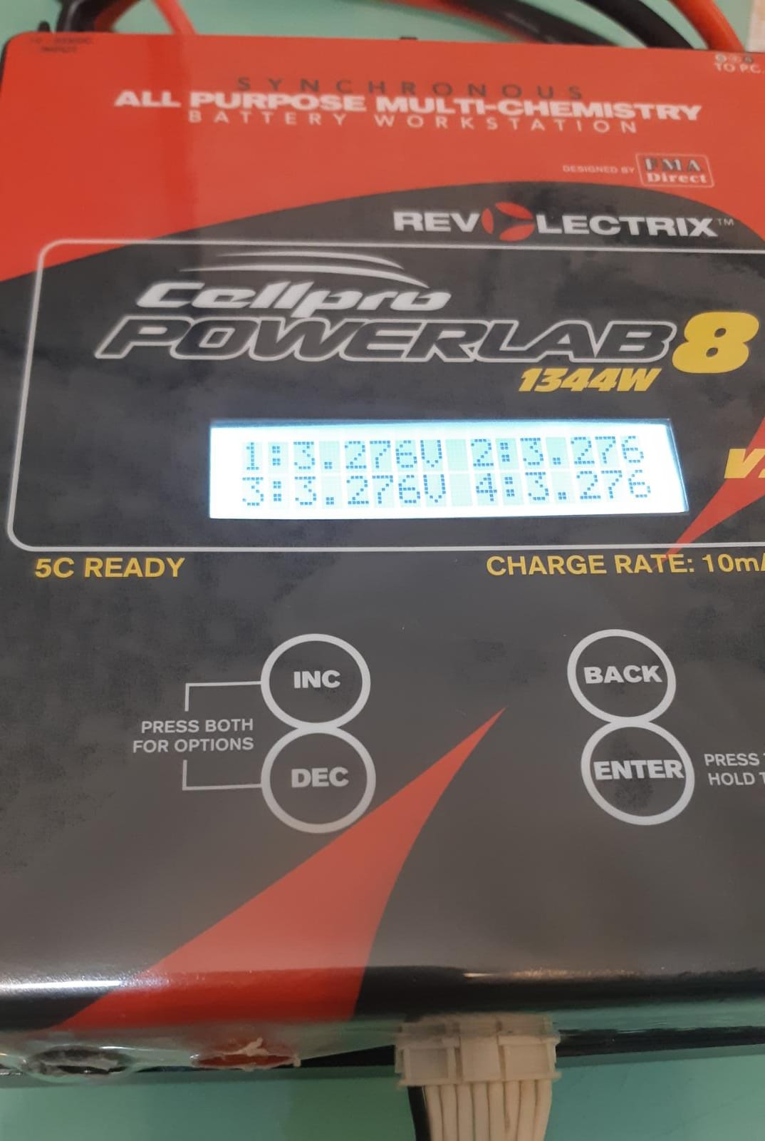

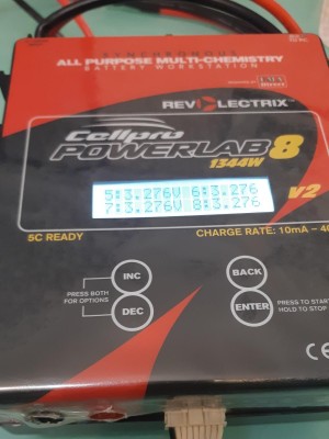

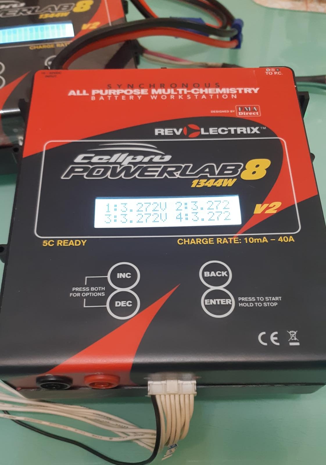

Postby shirley_hkg » 26 Feb 2023, 06:12

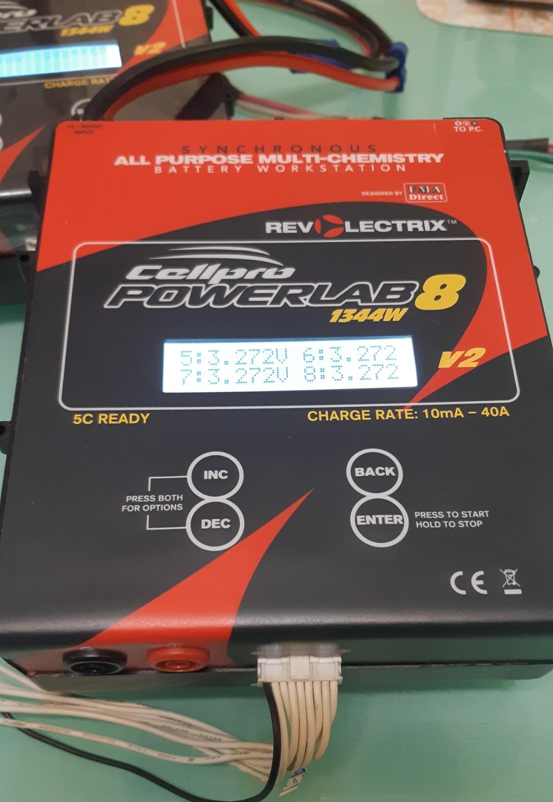

Got 2 very nice, nearly brand new, PL8 this week.
Tested to ensure they are free from incorrect voltages of the 8 balance pipelines. I've came across 5 units which had the problem, so a proper one is scarce.

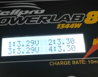

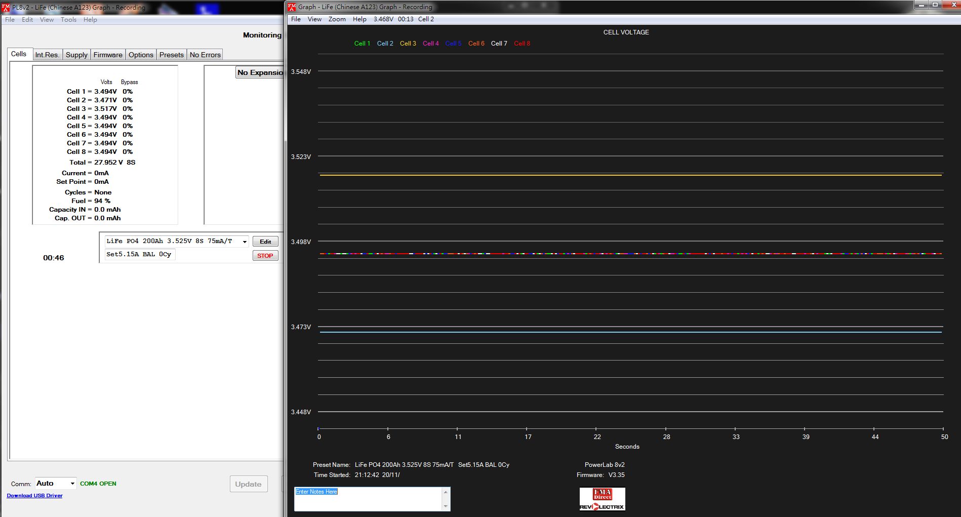

Postby shirley_hkg » 26 Feb 2023, 06:16
Another one.
Charged the same battery a bit, so voltage is not the same.

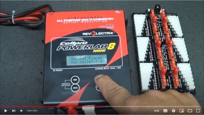

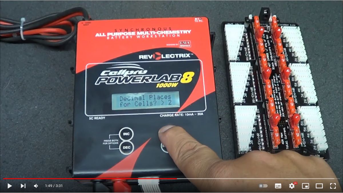

Postby shirley_hkg » 02 May 2023, 04:00
How to change to 3 decimal ON THE PL8 ?
Posts: 4657
Postby shirley_hkg » 02 May 2023, 05:04
We've never done such on the charger itself. Don't laugh .
youtu.be/fNHwYR4WkRM
Posts: 4657
Postby Burgerman » 02 May 2023, 07:41
I always use PC and dont think you can.
Posts: 71100

Postby Burgerman » 02 May 2023, 10:24
NOS?
The number of digits may require that you have one of the registry hacks on a PC in order to change it.
2 options.
a)Averaged data so it looks all neat and only a couple of decimal places. Makes pretty graphs and unless something is actually wrong its stays this way but its not real! All good for a typical hobbyist without alarming him for no good reason.
b) an extra decimal place 4 decimal digits. And no data averaging so it shown reality. And also shows the caibration differences between cells. Or charger innacuracies too. Usually you would never see this as most people dont have the registry hack that allows it. And I dont think it can be changed on the charger.
Posts: 71100

Postby Burgerman » 02 May 2023, 12:37

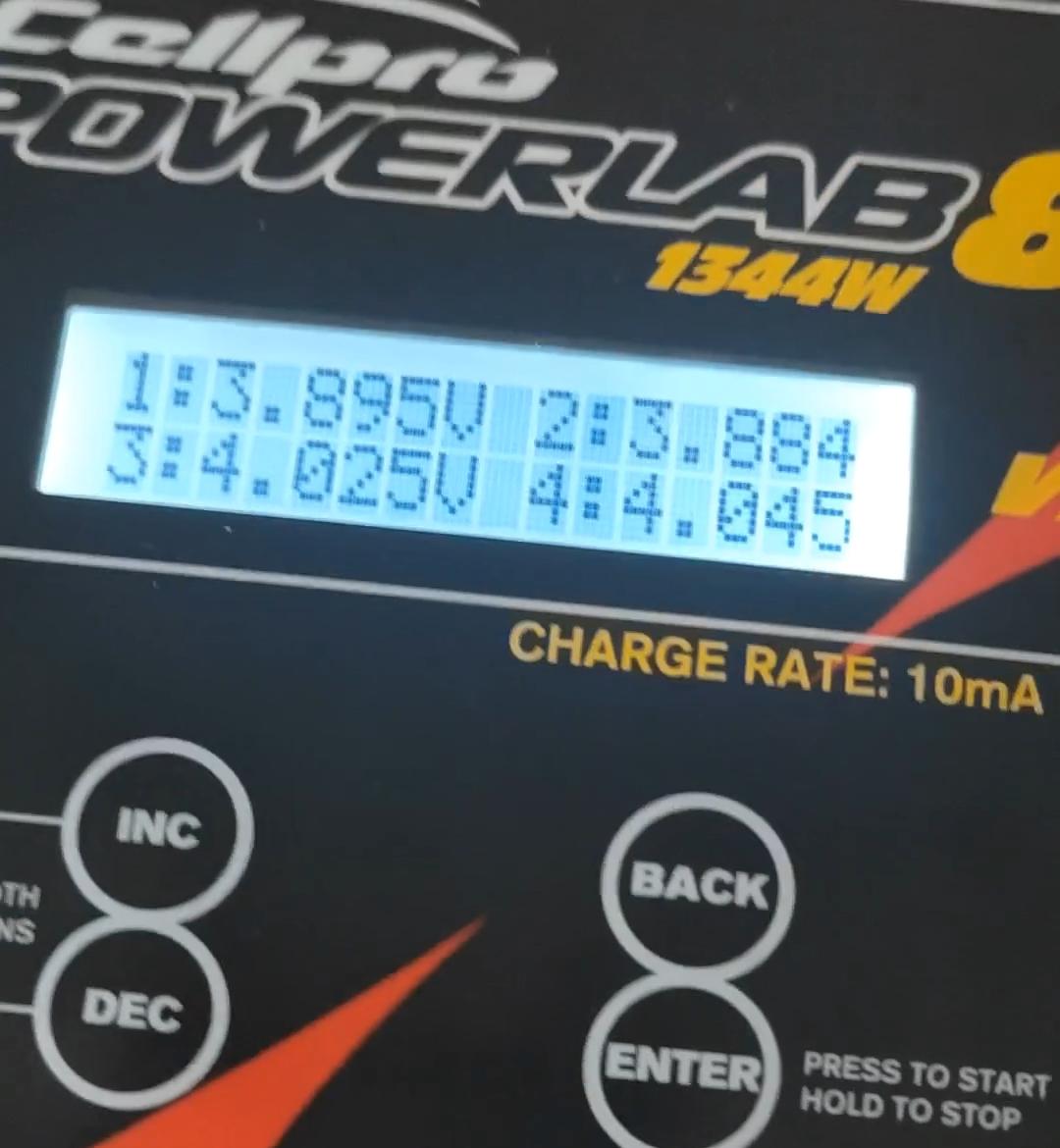

In your picture no,s 2 and 4 dont showthe V at the end?
Posts: 71100
Postby shirley_hkg » 02 May 2023, 13:36
No.
It has factory default value @ 2 place of decimal , as he never used it.
I am telling him how to test and show me that his charger doesn't have irregularities in reading voltages .
If it is fine , I am buying it. Someone here wants PL8.
I've seen a few units that were not right .

Postby shirley_hkg » 02 May 2023, 16:27
Burgerman wrote:In your picture no,s 2 and 4 dont showthe V at the end?
Yes. They do ..
Posts: 4657
Postby Burgerman » 02 May 2023, 16:43
Posts: 71100
Postby shirley_hkg » 03 May 2023, 01:53
It's fine now . No (V) at the right ends .
Posts: 4657

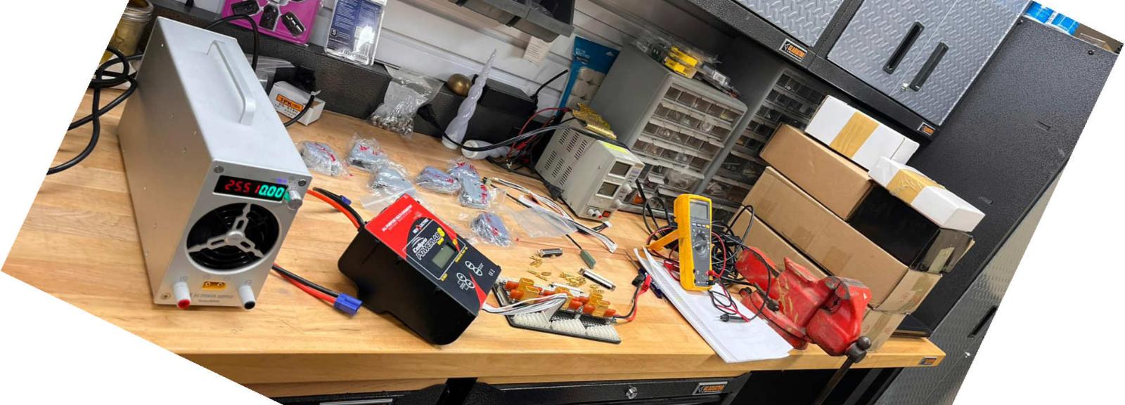

Hey, there’s our workbench. Thank you Shirley! Everything arrived quickly and beautifully wrapped. You have been so very helpful and we really appreciate it! We are waiting for a few more supplies to come in and we will begin our journey of building our first set of batteries…..and then the questions may come pouring in.

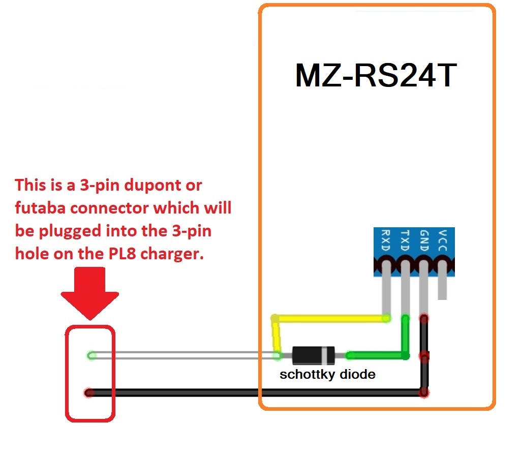

Postby woodygb » 27 May 2023, 16:16
Another possibility with the addition of a schottky diode.
