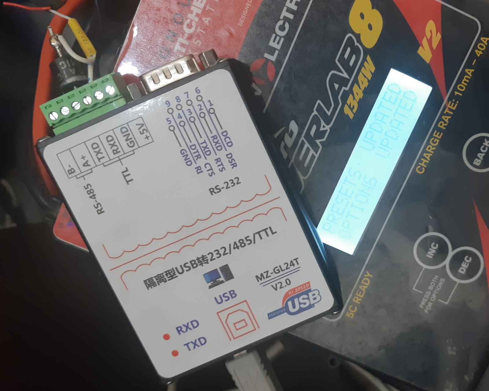

Postby shirley_hkg » 06 Jun 2023, 04:35

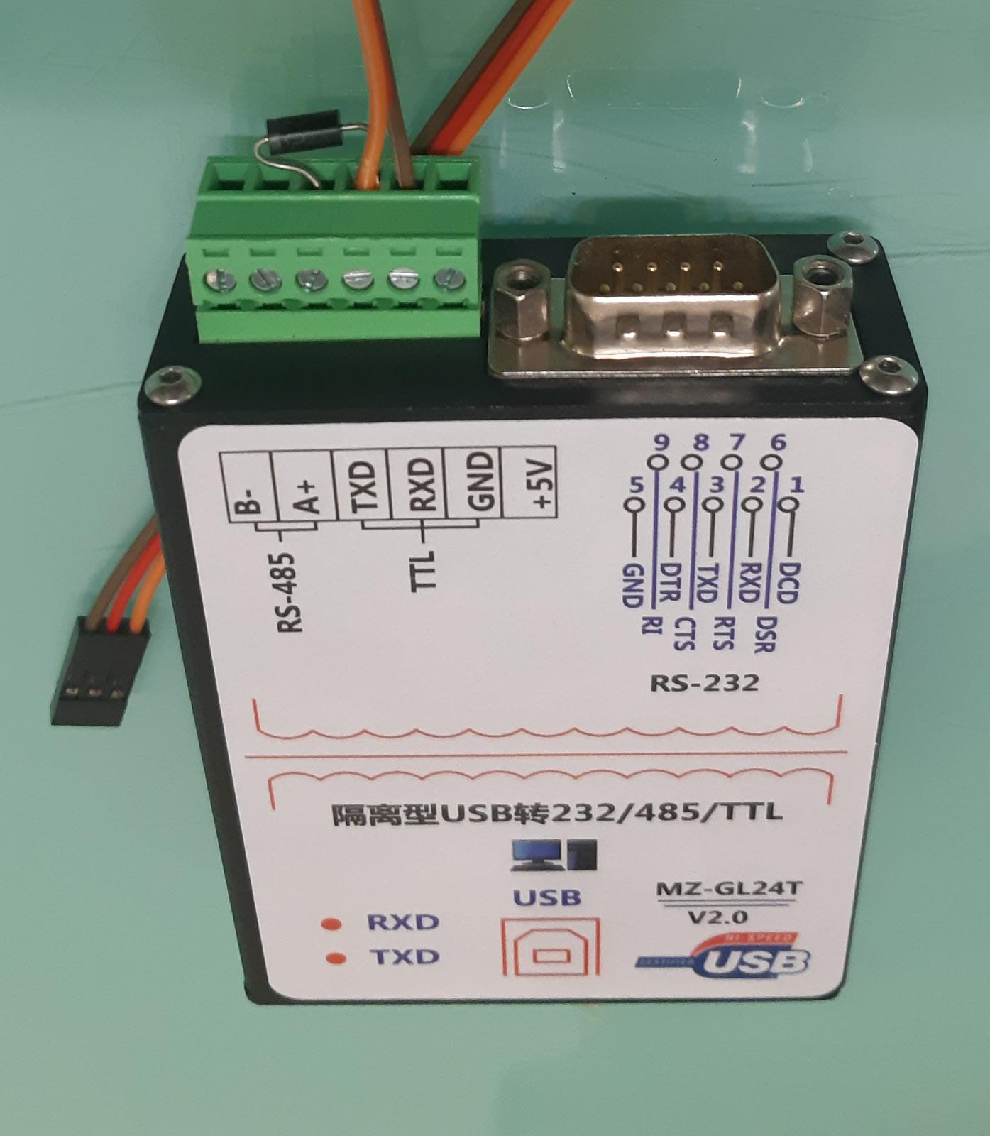

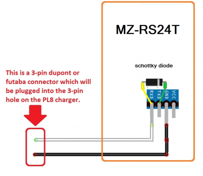

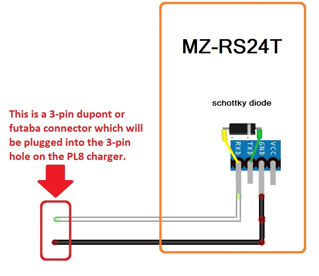

woodygb wrote:Another possibility with the addition of a schottky diode.[/attachment]
Yes. It works flawlessly.

Postby woodygb » 06 Jun 2023, 09:45
Make the wiring a little tidier / easier by simply connecting the diode ( use a physically smaller one ) across the RX and TX terminals.

Postby shirley_hkg » 06 Jun 2023, 12:28
Ah, brilliant.
I have small diodes coming.

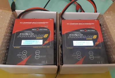

Postby shirley_hkg » 23 Jun 2023, 04:11

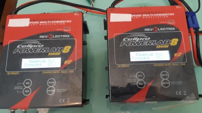

o wrote:Hard to keep up with the demand of good working PL8, but to let go of my own collection too.
Very pleased to come across one selling 2 new in box units. Grap them without any hesitation. All good.
Have to fill up the spare of my own too.
I have 5 units which are in perfect working order.

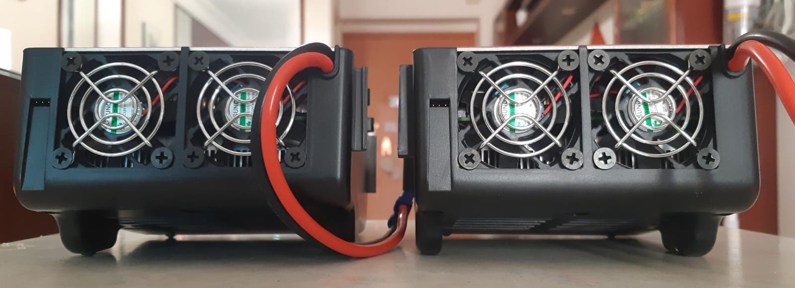

Postby shirley_hkg » 27 Jun 2023, 13:21
Exhaust fans are clean as a whistle.

Postby martin007 » 27 Jul 2023, 20:07
What function does the diode have?
Posts: 4105
Postby Burgerman » 27 Jul 2023, 23:08
It prevents the TX and RX from interfering with each other. As they both use a common wire. A one way valve. And a shottky diode because they only lose a very small forward voltage (about .25V) instead of .7v from a silicone diode. Or it may not work.
Posts: 71100
Postby martin007 » 27 Jul 2023, 23:28
Is the use of the diode still in the testing phase?
Is it an initiative of forum members?
Posts: 4105
Postby Burgerman » 27 Jul 2023, 23:41
Its just basic well known electronics. Woody started doing it because some programming leads were unreliable or not working.

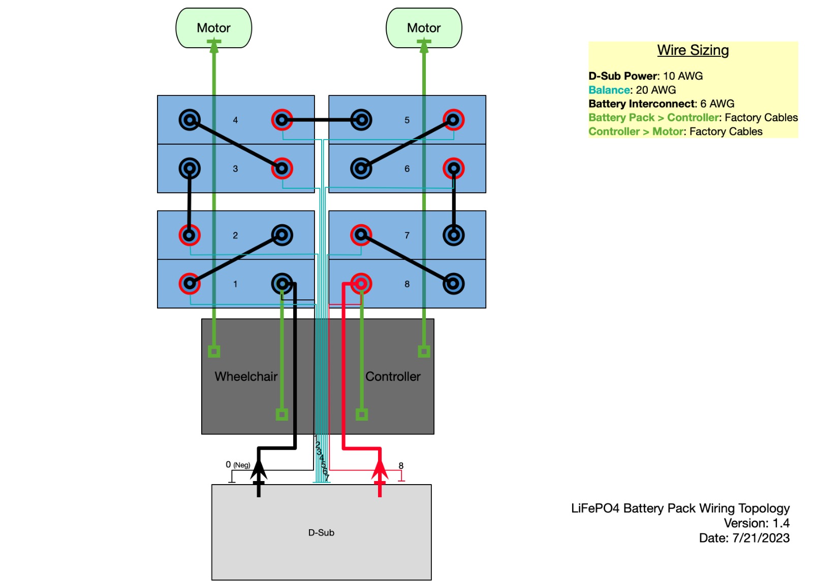

Postby shirley_hkg » 01 Aug 2023, 11:38
Nice wiring diagram . cheers

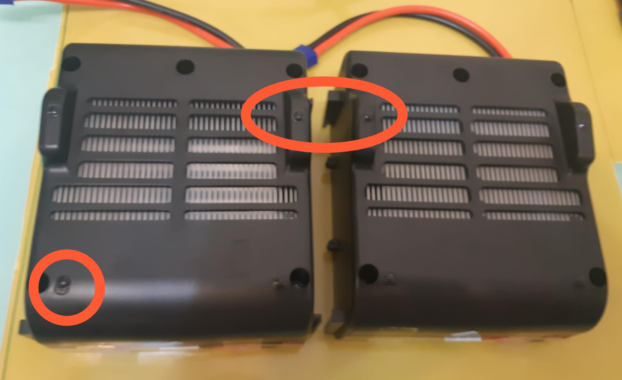

Postby shirley_hkg » 04 Sep 2023, 13:46
This guy seems to have endless supply of brand new units. Already bought 2 from him in June , and are sold to members here.
Got another 2 New-in-Box units. Those easily felt off rubber tags are all intact. The most beautiful units I've acquired.

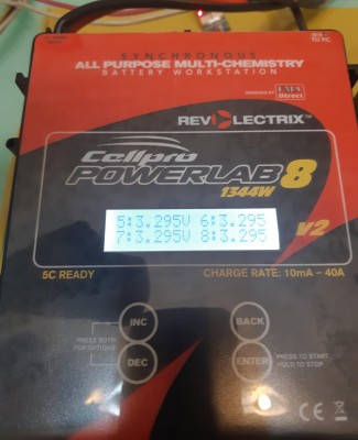

Postby shirley_hkg » 04 Sep 2023, 14:09

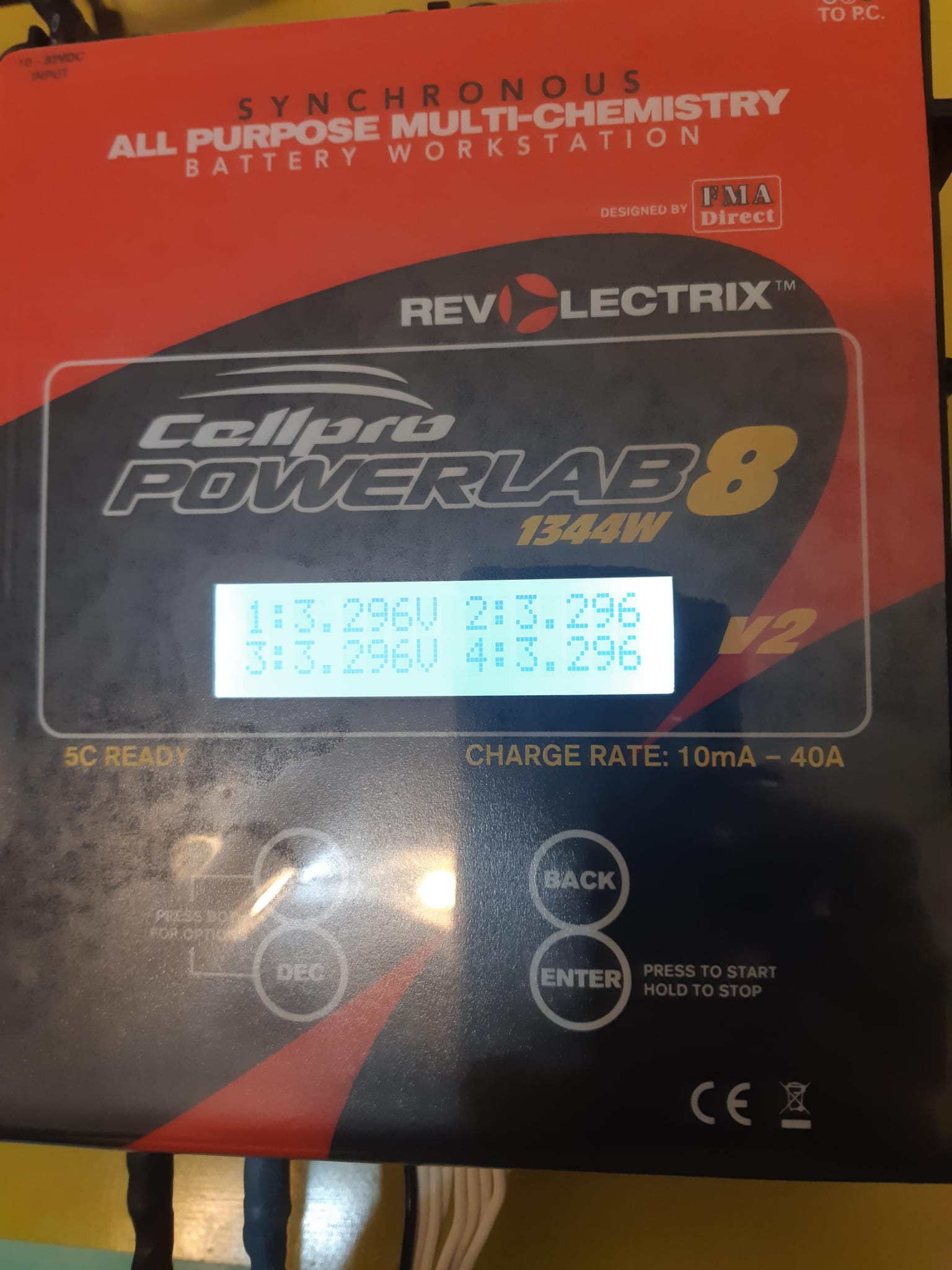

The first thing to check is the voltage consistency.
Posts: 4657

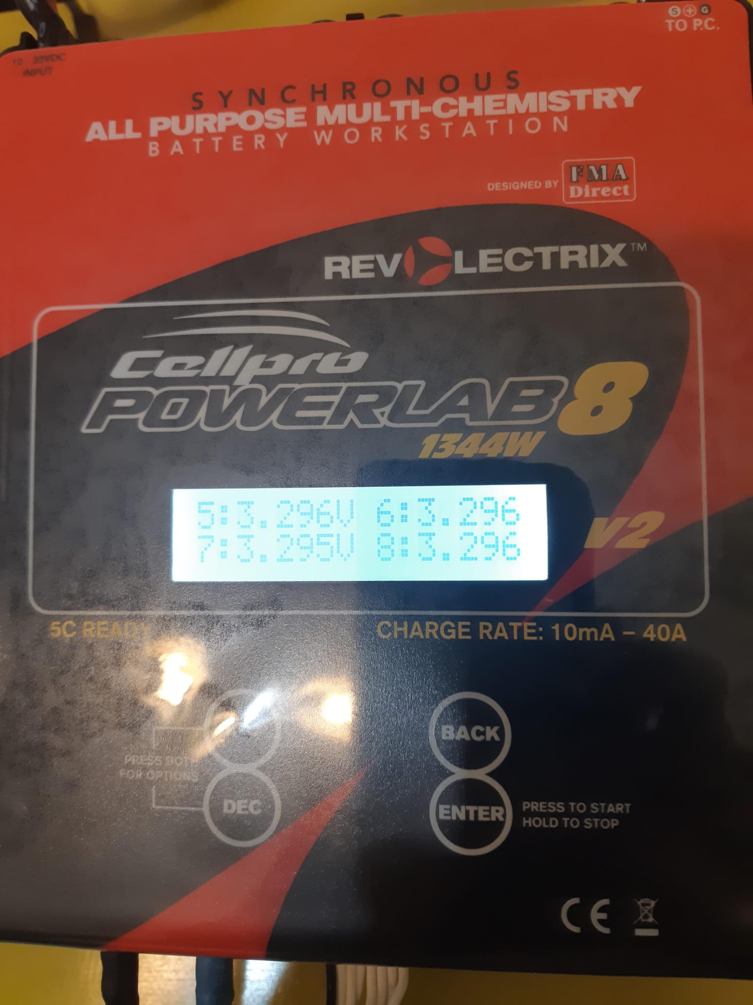

Postby shirley_hkg » 04 Sep 2023, 14:13
The second unit too.
Posts: 4657

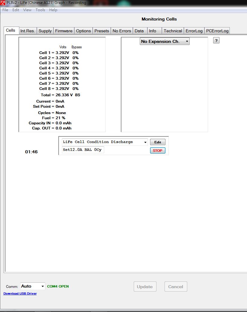

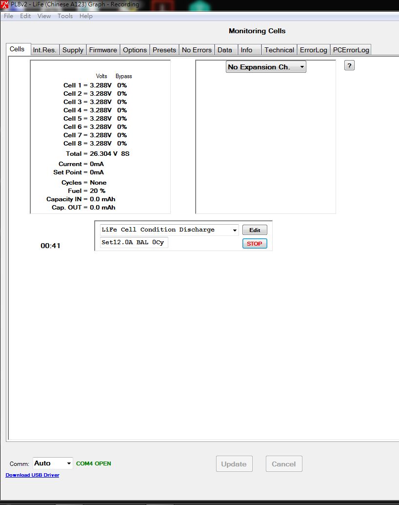

Postby Burgerman » 04 Sep 2023, 16:58
Problem is that those voltages tell you nothing. Because they are all averaged / rounded and pushed close together.
So you will need to ENABLE 4 DECIMAL PLACES in the software. That also removes all of the data averaging. Then they will all read a different voltage on your PC screen.
