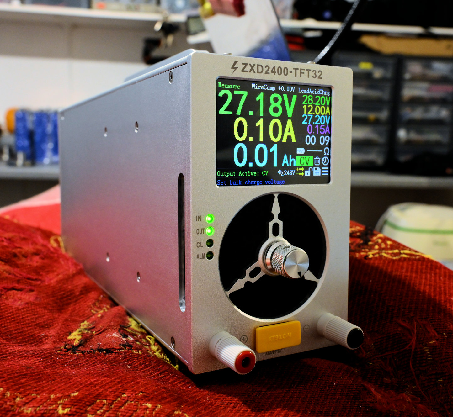

Anyway, heres my current settings for GEL battery...
Not at top in white, LEADACID.
Initially when I switch on power it just reads the ALREADY FULLY CHARGED battery voltage! This is about 26.5V?
Then when I switch on, by pressing button, it charges at 28.20V correctly, and the current in amps starts low, and soon drops below the 00.15A (150mV) I have set.
At this point the battery voltage drops away again, until it falls below the 27.20V hat I set for float for around 5 seconds. And then it charges for a while until it reaches the float voltage again. Then it switches off. And waits for the volts to fall again. Over and over.
This will continue, untill the 16 hours I selected is done. Then it will turn off.
It will give a 99.5% charge in the 28.2V, 8 hour long Absorption stage.
This will give a fully saturated complete charge in about 12 hours but best left for 16 hours if you get chance.
If you need to use the chair you can do so after the 28.8V absorption stage ends after 8 hours perfectly safely too. But leaving it longer once or twice a month is beneficial.
Remember its already full here!

Postby Burgerman » 26 Dec 2024, 20:19
No need.
Just look at the screen. As you turn the knob it goes to the top (the white bit) (or any other feild in turn). And allows you to then press to "select" any "adjustment" and it dims a little and the selected field turns GREEN so you can tell which one you are on.
As you press once then turn the knob now the digits or options change.
And so now you can select for e.g power supply, leadacidcharge, lithiumcharge at the very top. Press again and its locked it to that setting. Intuitive and super simple once you try it.
Then turn knob again to scroll to all the other various setting feilds in turn. And then just do the same, one press to select it, then turn to set whatever numbers you want, then press again to lock it in.
A video wouldnt show this well anyyway as you need to feel and watch as you go. Easier to see on your own screen/charger. Just do it, its simple. Much easier than the older versions. Scroll to the OFF square (which is telling you its OFF and it turns green. And press ONCE to turn it to on. And it will then display CV or CC if thats what its doing and it will start up.
Whole setup for any new battery or type or power supply takes seconds. And if you look at the blue help text that appears at the bottom theres even a description that appears to explain what it will do!
Then after this setup session you just need to press START button in future to turn it on. And press the OFF button (its telling you its off - in a little square) to begin.
Watch http://www.wheelchairdriver.com/gopro/ZXD.mp4
Note that I turn it on first.
Then press once more and the OFF square turns green, and now says CV for Constant Voltage.
Although I am doing this with it falling off the bed balancing right on the edge with one hand as the other holds the camera as I am laid onmy side so not a great vid! And a crap phone camera.
Posts: 71096

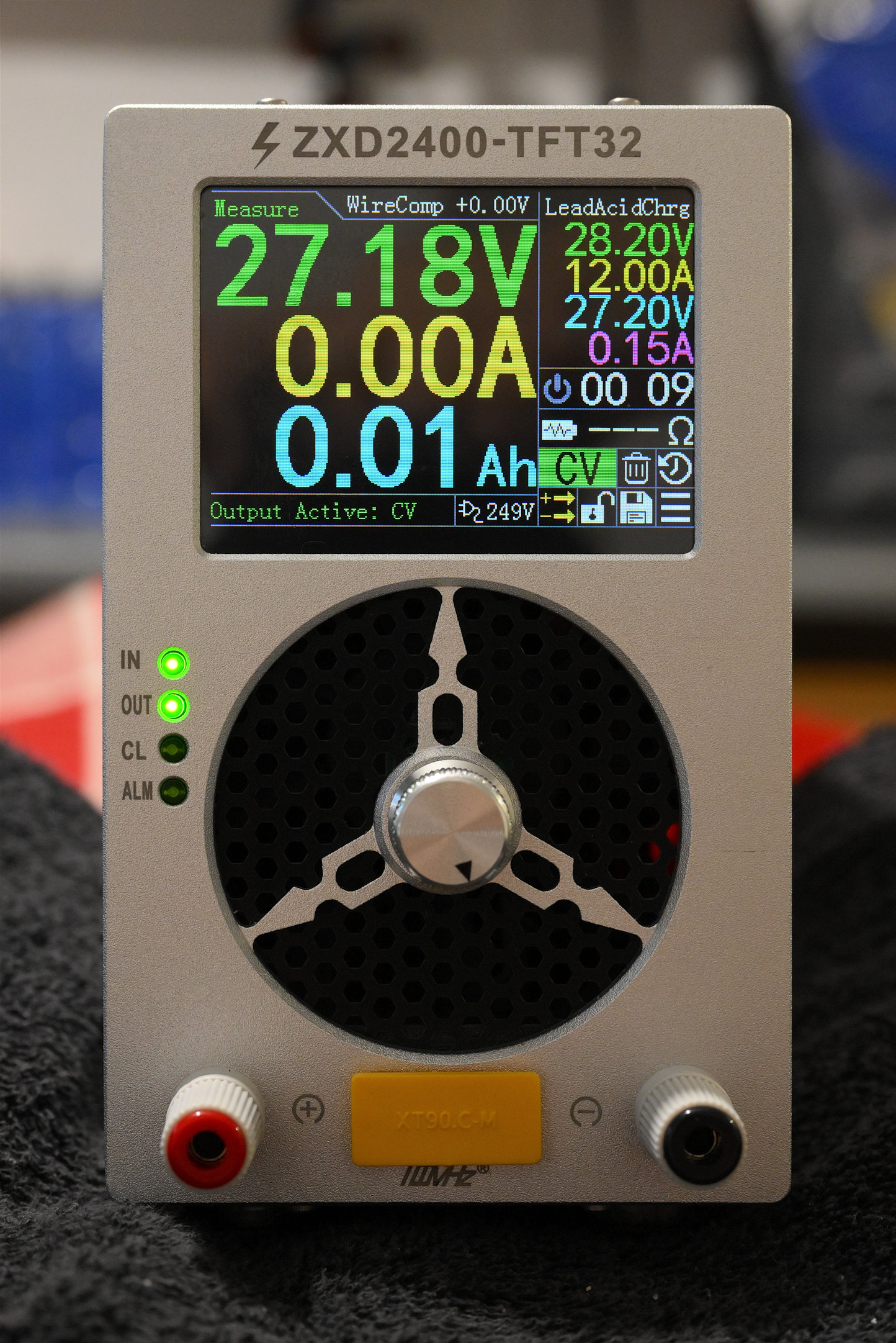

Postby Burgerman » 27 Dec 2024, 12:43
I like this new one so much I just ordered another one!
Same, small case, large screen anderson on rear as above.
Those, delivered (3 weeks from order) are:
Stock Plastic case $1,800 HK Dollars. (or £180 UK)
Fancy Aluminium case + 2.4" screen $2,050 HK Dollars. (or £205 UK)
Large screen, small case, andeson rear etc same as mine $2 ,200 HK Dollars. (or £220 UK)
So for anyone interested I will sell:
a) the older style one. Looks as good as new but used for a few years. Bit of dust...
b) never used older style one complete with fancy case never yet assembled!
c) at least ONE of my big analog 0-30V 0-40A bench power supplies that are years old!
If interested make an offer and pm me. Or eBay ahead...

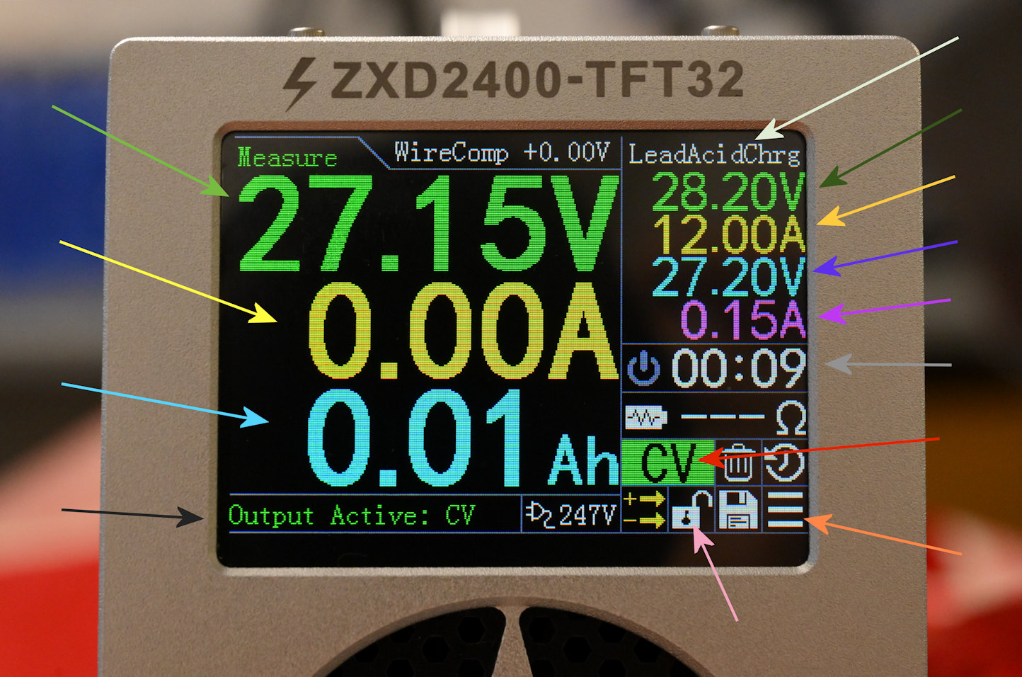

Postby Burgerman » 27 Dec 2024, 22:33
Screen...
Arrow Colours:
1, LIGHT GREEN: Realtime battery or output voltage measured at the terminals.
2. LIGHT YELLOW: Realtime current in Amps, being sent to device in SUPPLY MODE or battery in BATTERY MODE.
3. LIGHT BLUE: Amp Hour accrued (a guide to Ah sent to battery but this will be 5 or 10% more than the Ah actually used with lead.
4. BLACK: Tell us if output is active and if its CC (BULK) or CV (Absorption). Followed by Mains AC voltage.
1 to 4 we cannot set. These are information only.
5. WHITE: Allows is to SET either LeadAcidCharge (CC/CV/FLOAT and timer, and tail current) or LITHIUM (CC/CV), or POWER SUPPLY (VOLTS / MAX AMPS)
6. DARK GREEN: Allows us to set correct CV or ABSORPTION Voltage.
7. DARK YELLOW: Allows us to set the charge MAXIMUM current allowed. During CC stage.
8. DARK BLUE: Allows us to set correct FLOAT VOLTAGE
9. PURPLE: Allows us to choose the tail current where the battery is about 98% charged or 8 hours at CV to transition to FLOAT. This needs personalisation initially.
10. GREY: Here we can choose how long charger stays on. The on off switch sets the charger to turn off when it sees no current. OR it chooses weather the charger stops charging after its been at FLOAT for a pre determined number of hours. I set this to 8 hours.
11. RED: this will start the charger. Then it displays the mode, e.g CV or CC. If nothing is selected just pressing the knob will also start it.
12. ORANGE: Press for MENU. Press and hold 4 seconds for MENU, hold for 4 more seconds for ADVANCED MENU. 0000 is the password in both cases.
13. PINK! Allows the menu to be LOCKED. On off still works. Setting AUTO START etc in the menus can allow this to be made into a plug and play dumb charger with your own settings that a carer cannot change. Password to unlock is the same 0000. Unless you choose a different one. And you should!

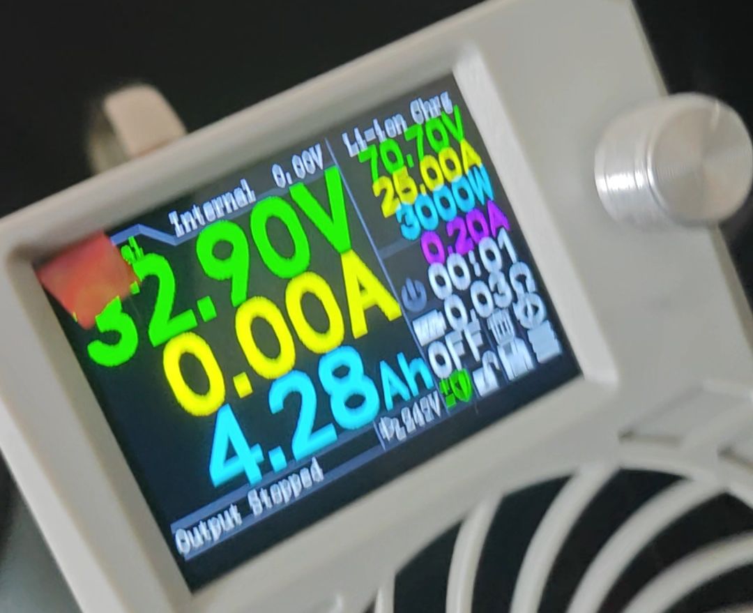

Postby emilevirus » 28 Dec 2024, 17:42
emilevirus wrote:I just received mine. It won't go past 25A. Any idea why?
I received the 120v version. It goes up to 120v and 25A

Postby Burgerman » 28 Dec 2024, 19:57
I dont know if the 25A/120v versions are the same physically as the 50A/60V versions.
I suspect they are and its just a settings thing.
In the menu inside, advanced menu, set it to 3000w, it likely already is, and to 50A and 60V instead and see what happens.
As far as AC input, they all work from 80V up to 260V or more.
Posts: 71096
Postby emilevirus » 28 Dec 2024, 20:28
Burgerman wrote:I dont know if the 25A/120v versions are the same physically as the 50A/60V versions.
It's already at 3000w and can't go further than 25A
emilevirus
Posts: 564
Joined: 12 Aug 2020, 22:02
Postby Burgerman » 28 Dec 2024, 20:32
Because it cant if you allow it to do 120V. 120V x 25A = 3000W...
I suggested going into the menu and adjusting max volts to 60.
THEN in the same menu adjust the max current to 50.
Then come out of menu and take a look. Still 3000W but can you now select 50A?
You may need to run a calibration.
Posts: 71096
Postby emilevirus » 28 Dec 2024, 20:51
Where is that? I can't see voltage limit anywhere.
emilevirus
Posts: 564
Postby Burgerman » 28 Dec 2024, 20:57
ADVANCED MENU.
I just tested that.
I changed mine from 50 to 25A
And from 60 to 120V and it allowed me to set that on the screen. So I can do 120V too... So hardware must be the same.
So hardware is the same?
ADVANCED MENU
Press MENU hold it for 4 seconds or more. When you see 0000 press for 4 seconds or more AGAIN (just wait). And thats the ADVANCED menu.
I set the alternate progress boot screen, fine tuned voltages (multimeter) and adjusted screen brightness once dimmed, etc too.
I also set FRONT FAN ALWAYS RUNS to off. And same on rear fan.
Now its silent at low power. And not filling with dust all day. Gets just barely detectably warm on sides of case.
Posts: 71096
Postby Burgerman » 28 Dec 2024, 21:07
When I am right you can thank me! :lol:
So these power suplies are really BOTH versions in one.

①USER : press the menu button once.
②ADVANCE : press menu button for 4 seconds, prompted for password, (default 0000). Press again.
③FACTORY : press menu button for 4 seconds, prompted for password, (default 0000). Press 4 seconds to enter.
