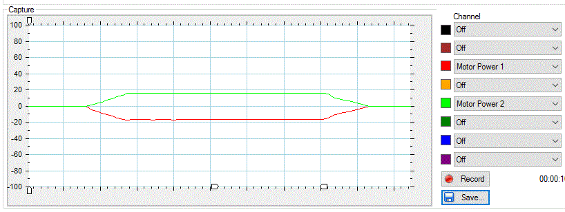

Suppose you turn in place then let go of the stick without moving forward or back. Does the green line move down and the red line move up? Equal and opposite? [You can try this with RPMaccel and RPMdecel = 0. Obviously, turning will be sluggish with increasing acceleration/deceleration over time, but I just want to know if the two lines converge properly if there's no attempt to boost things.
Yes. It behaves exactly as it should. Linear and symmetrical accel/decel to each wheel. With the newest script. But way too slow. (This is from memory) but will check tomorrow. No acceleration over time, straight lines only. You get triangles...
See image.
Turn in place, release. Same high settings as before. Latest script. Takes over half a second for wheels to reach turn speed, and the same for them to stop on release. That's a little slow even with high settings for turn. This is normal acceleration rate. I think. But symmetrical.

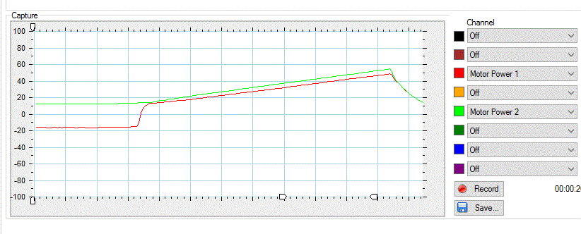

Postby Burgerman » 13 Nov 2015, 21:27
Initial playing about. You are correct! Deceleration is about 10x greater. Forward acceleration is set to really really slow, to show what I am talking about!
Because the logic error still exists. (I think)

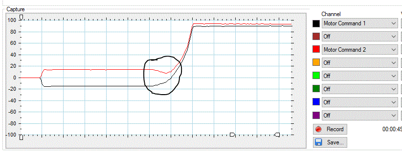

This is what we see, when I zero turn, and then accelerate towards an imaginary doorway.
Note the top motor command here (green) maintains its forward speed, and the bottom red (reversing) wheel, accelerates to catch it up. Very quickly. However it means the chair continues to turn initially as you accelerate.
This is what I would EXPECT to see. This is actually what we see when I just look at the joystick input. (And what I would logically expect the motors to do unless I am wrong.) They converge, (the forward going wheel slows down), then both rise together. Ringed. Note, this is not from the same graph, its simply in place of a drawing to demonstrate what I think should happen!

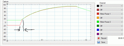

In all a great improvement, but we still have that turn thing going on.
Note, after release from zero turn, it still turns during the period of the vertical black lines.
And note forward acceleration increased by large margin at start, tailing off to low level and 8 seconds to full speed. This acceleration boost really needs a parameter that allows it to end at 5, 10, 15, 20, 30% speed - adjustable to get it correct. Or better still have it add "less" boost as speed increases in linear (square?) fashion? We may really need a short steep boost acc "curve" then a straight line at a lower acceleration the rest of the way.
