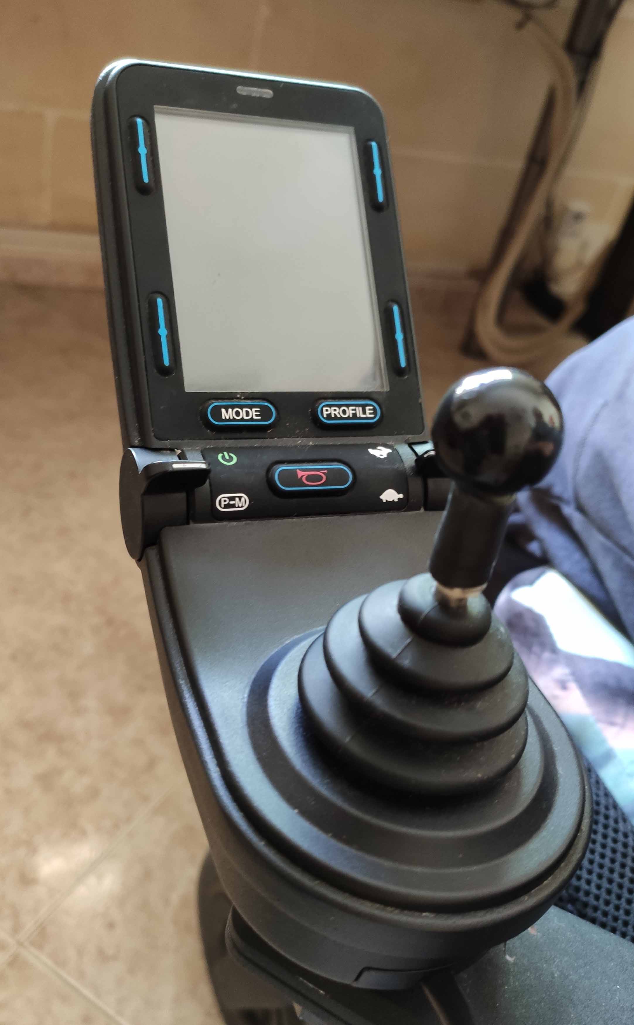

Yes. The joystick unit itseld is designed for finger loads. It is sensitive to being hit, forced or other abuse. And it can send its zero position off centre and so the char moves while the stick is central. It can also rin the accurate self centering. So that it covers a too wide area. It can also be just a faulty joystick but thats not very common. Yours appears to show damage on the end of the joystick? So its seen much more force than it was designed to take.
So it needs to be replaced. Not cheap.
You might be able to "fix" this. I have looked inside myself but its a bit fiddly if you have not done this kind of thing bofore.

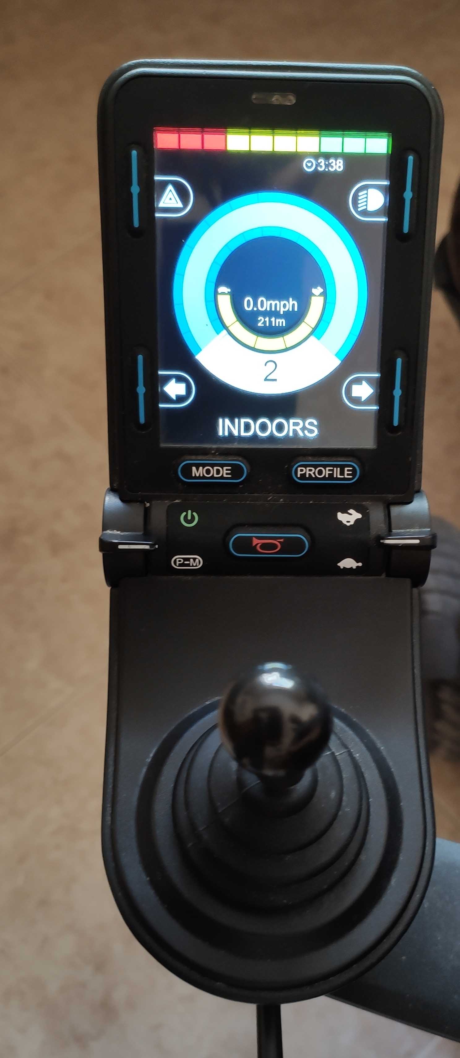

Postby Burgerman » 03 Jun 2022, 11:56
But the top of the joystick appears damaged? Is that correct? If so how do you damage that without applying force? Maybe just a bad photo.
Take apart, remove joystick unit, remove rubber, check mechanism for damage, bent, no longer centering properly, spring tension etc.

Your description of the problem suggests to me that your joystick needs replacing....
Postby Burgerman » 03 Jun 2022, 12:25
That was the opinion I came to. Looking at the picture.

Postby Frank » 03 Jun 2022, 18:26
My previous photo may have been of bad quality and misleading. My control box has not been damaged and has only 211 miles on it. We opened the control box to check the inside and found that all the plugs are firmly connected and everything seemed good. So there is nothing else we can do about it. We mounted it and put it back on the chair. At the moment it is working correctly again but I am sure that the joystick error will come back sooner or later. If that happens again I will have to exchange the control box. I believe that the joystick is to blame, can one just buy the joystick and replace instead of buying the whole control box? Thank you for your help.

Postby Burgerman » 03 Jun 2022, 20:09
It is POSSIBLE to just change the joystick itself. But they are assembled and calibrated by PG Drives. So in your case its going to be a replacement. Under warranty? I have 3 of those bought on here, ebay, etc. All cost me 125, 150. So its also possible to get them new or as near new as matters cheap if you are patient. But if under warranty why worry?
Do a joystick calibration from the CJSM2 menu in obp. I dont think it does a zero position calibration but its a long time since I looked. But it maps the east west north south travel positions.
That joystick is longer than stock. Which allows easy excess force and more leverage when pushed. Which wont be helping any. Esp if you hold it with your whole hand with your weight on it over bumps.

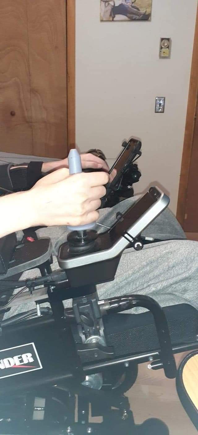

BM, after reading this I'm concerned about damage my linx joystick because I use a long handle I don't have any hand or finger function my fingers curled so I slide my hand down over the joystick. I've gotten error codes an flashing red light because sometimes if I hit a bump hard my hand jams the joystick to far. Can you guys think of a better solution for the joystick or is this just what we have to work with?
Posts: 1101
Postby Burgerman » 04 Jun 2022, 17:18

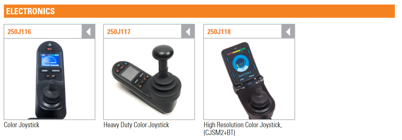

PG do a special HD joystick specifically for users that cant use fingers. And use whole hand. Its on a good few rehab chairs prescription form. So not sure about linx.
Page 27, part 250J117
And it uses an industrial joystick. This is what you should have been prescribed if you use whole hand as per the copy and past from PG Drives a few posts above. Do your experts understand or know this? I doubt they know which way up it goes...

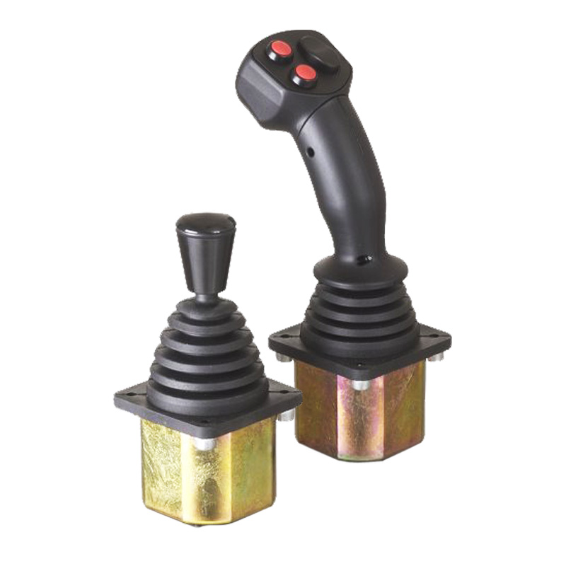

Postby rover220 » 04 Jun 2022, 18:14
Mo vis make the parts to convert to HD joystick.
Postby fishinjunky » 04 Jun 2022, 18:18
rover220 wrote:Mo vis make the parts to convert to HD joystick.
This one? Says it's compatible with linx and r-nt.
https://www.mo-vis.com/products/special ... tick#faq-6

Having damaged a couple, and seen how easy it really is. I am very surprised I see so many users with a "ball" or with long handles or users that rest complete hand on the joystick, that manage to not have problems. They are genuinely easy to break, de-calibrate, or bend. Hence the warnings. But it seems all those doing the prescriptions or assessements are unaware of this or the solution to it. Not a cheap fix, but for the sake of safety or reliability probably well worth the extra.

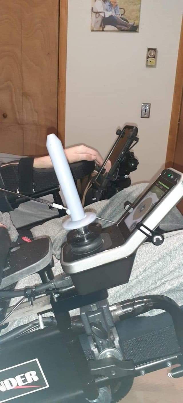

Postby fishinjunky » 05 Jun 2022, 13:41
rover220 wrote:The HD option isn't for everyone. It's very heavy and requires nearly 3 times the force input to operate.
do you think that could be somewhat mitigated by adjusting joystick throw, joystick neutral zone, and joystick sensitivity in programming?
this heavy duty joystick an handle in the first pic would be ideal for my hand. Im rough on my joystick only matter of time before it fails or breaks. Then its 1500$ dollars to replace czy
the second pic is my current linx joystick and handle
Posts: 1101
Postby rover220 » 05 Jun 2022, 15:56
it requires 650g of force to move from centre position,
Postby Burgerman » 05 Jun 2022, 18:31
At what length or distance from the pivot point?
I never used one on a chair. But have on a crane before becoming disabled and never noticed any difficulty at all. It just felt right for the handles length.

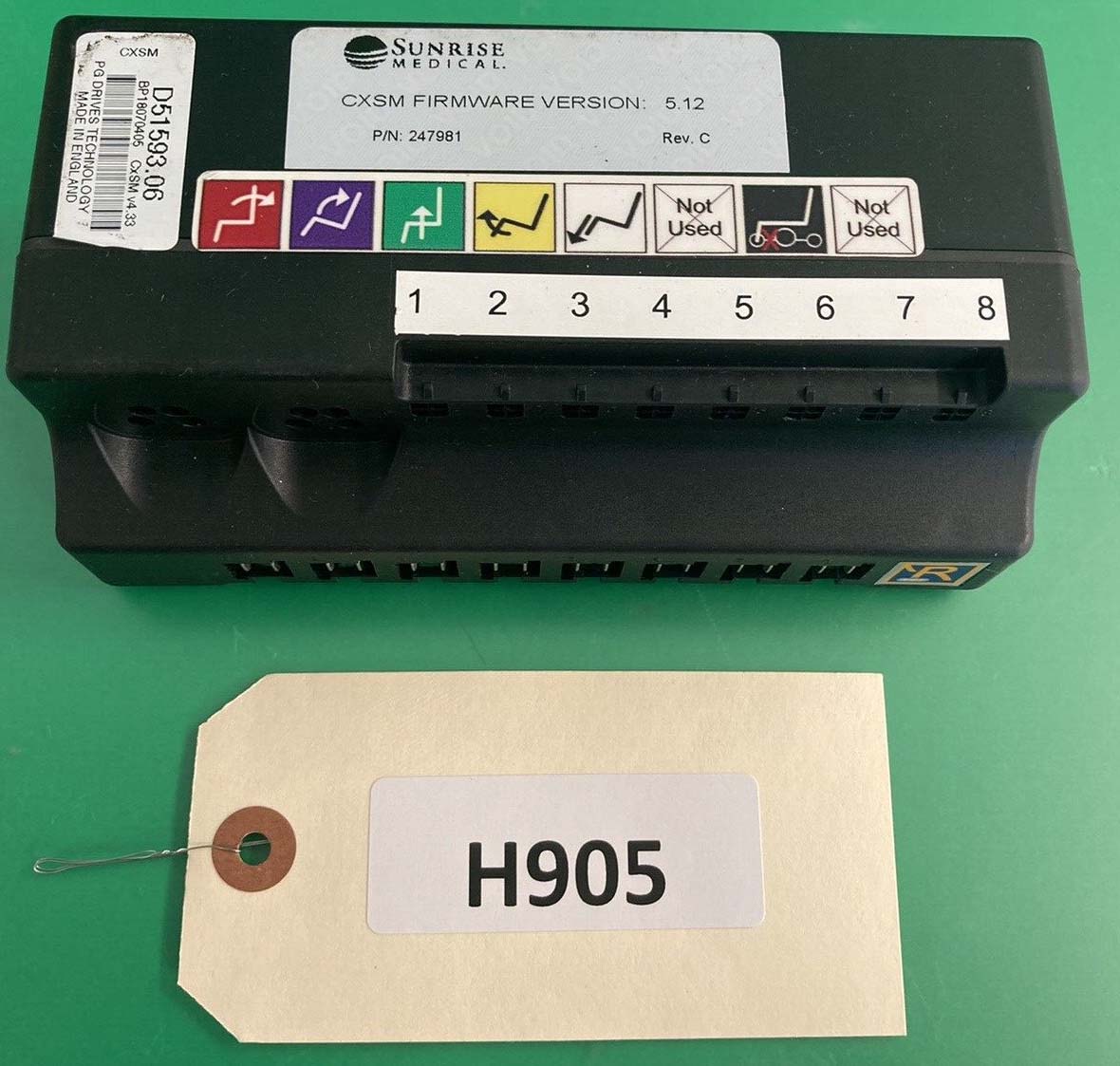

I would like to buy a used control module as spares. I found the following used control module, Quickie Control Module for Quickie Q700m Power Wheelchair D51593.06 247981 #H905. Is this power module like mine and compatible with my chair? Will it need any programming? Thank you in advance for your help you may offer.
Frank

Postby Burgerman » 29 Aug 2023, 16:49
It SHOULD be plug and play unless the mid drive has slightly different programming. But as long as you upload YOUR profile from your 700R chair it should work.
With all the positioning and sensor feedback its hard to say without trying it. But I would be about 90% confident that it will work on your chair easily without programming. You have the sunrise oem programmer anyway right? The correct firmware is 5.12.
Posts: 71120
Postby Frank » 29 Aug 2023, 16:54
Your information gives me more confidence to buy this used control module. Yes I have a programmer. Thank you for your help. All the best.

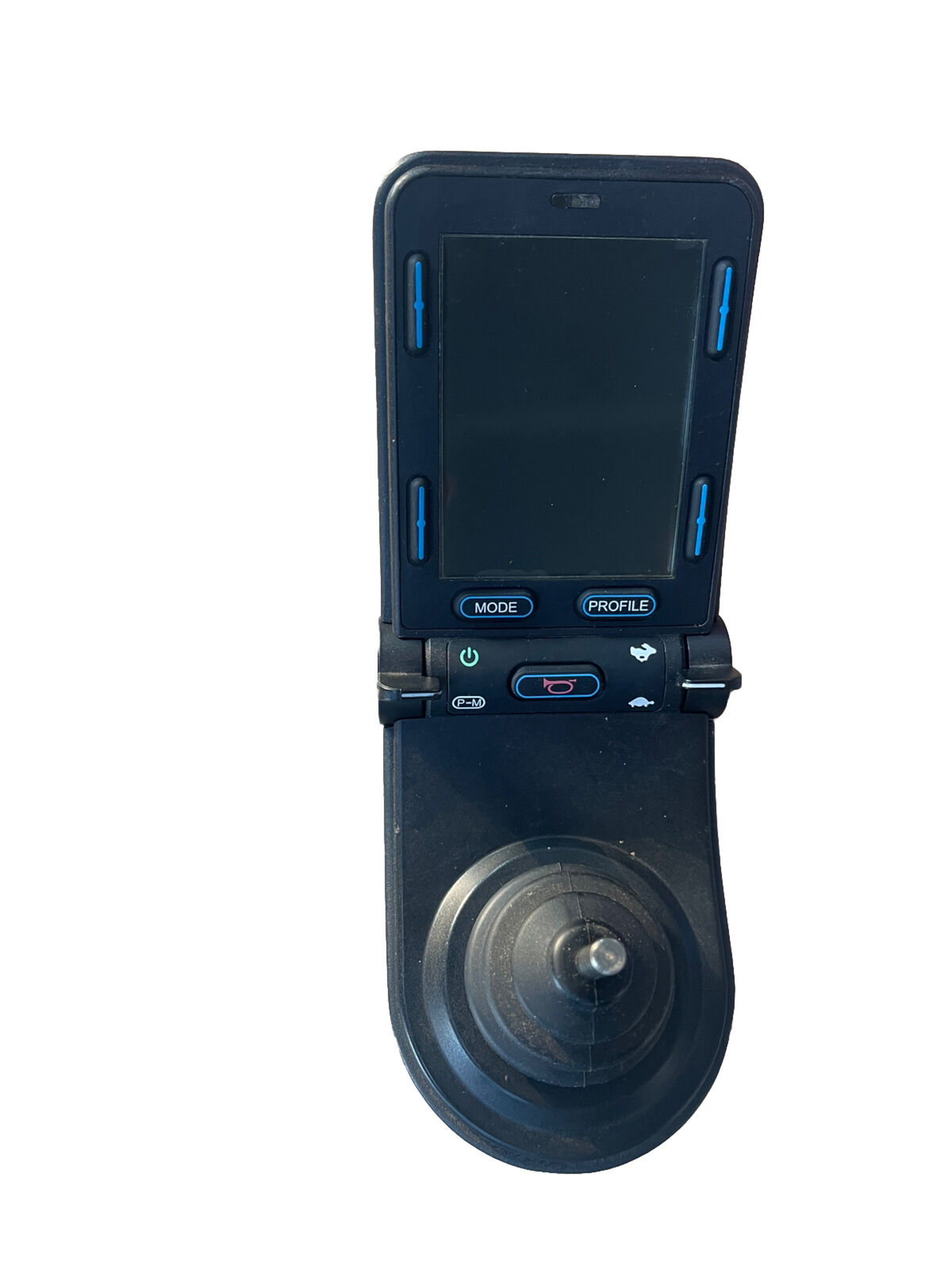

Postby Frank » 06 Oct 2023, 13:42

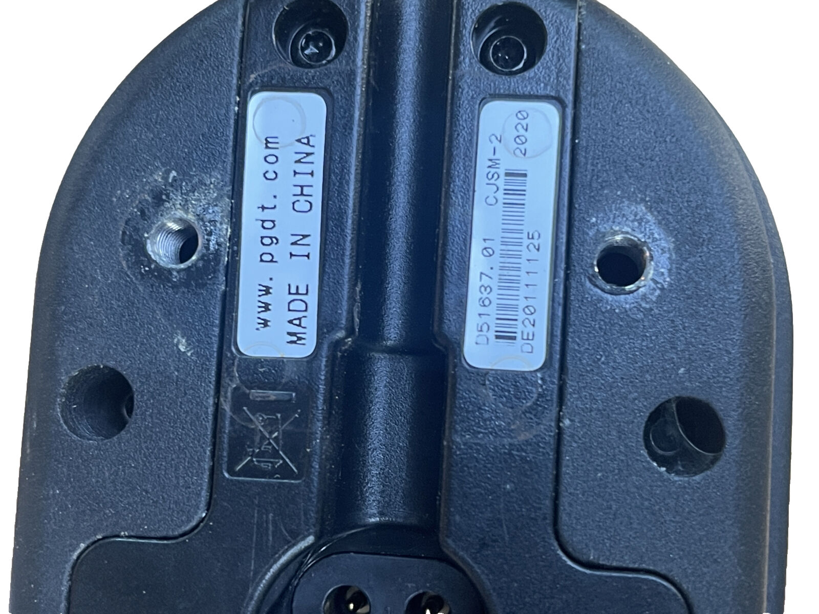

Hello there, I would like to buy a used CJSM 2 control joystick. To be sure may I ask if the following control box “QUICKIE SUNRISE R-net Bluetooth Wheelchair Joystick D51637.01 TESTED” is compatibility with my Q700R Power wheelchair with ERGO seating? Thank you.
