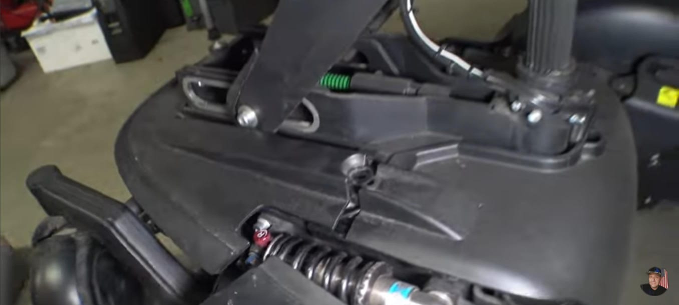

I'd consider a notch on the front , to route the cable out.
Here seems appropriate , as no moving parts around.

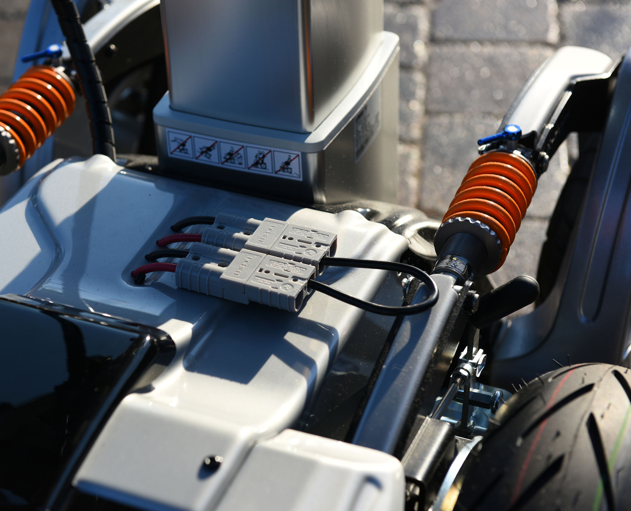

And a screw through the case (open it be sure gap so wires dont ollide!) to hold the connector flat on he surface to make it stable and easy to connect.
In the same way I did with the dual anderson connectors on he invacare storm xplore.

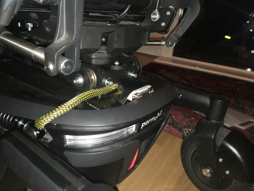

Ah, nicely mounted. Sounds like a good idea. Maybe I'll have to get a bracket to mount the plug. And something to cover it to keep water out. Shouldn't be much direct water there under the seat where it should be protected from the rain, but could get splashed by a bus or something.

shirley_hkg wrote:Use the 2 stock holes .
So I can unscrew the screws in the two holes and don't have to worry about it coming apart since it's glued. Then get longer screws to go through some holes in the shroud to secure it.

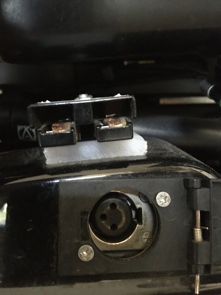

Postby jefferso » 03 Sep 2024, 18:11
The bolt looks like M3.
The Anderson SB50 on my C500 is mounted with a little spacer made from a piece of plastic cutting board.
Maybe I'll try to do something like that. It might be nice to mount the spacer on the shroud, then have holes for the bolt so it wouldn't be necessary to have to hold the nuts from behind the shroud each time it has to be removed.
I'm leaning towards trying to mount it on the back more vs. the front because the front is hard to reach through the leg rests when the chair isn't elevated. It might be difficult to plug it in blind when reaching through the leg rest. Or an extra step to have to raise and lower to charge.
I might be able to get it to come out the side without cutting the shroud, but I'm worried it might be close to one of the springs. I wouldn't want the cable to sag onto the spring and start to wear.

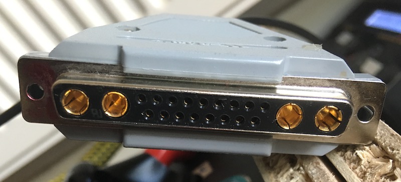

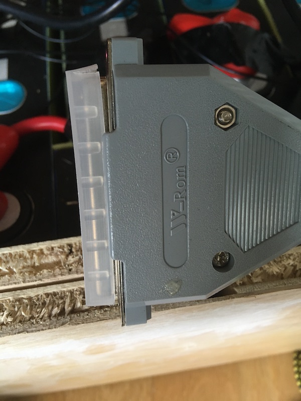

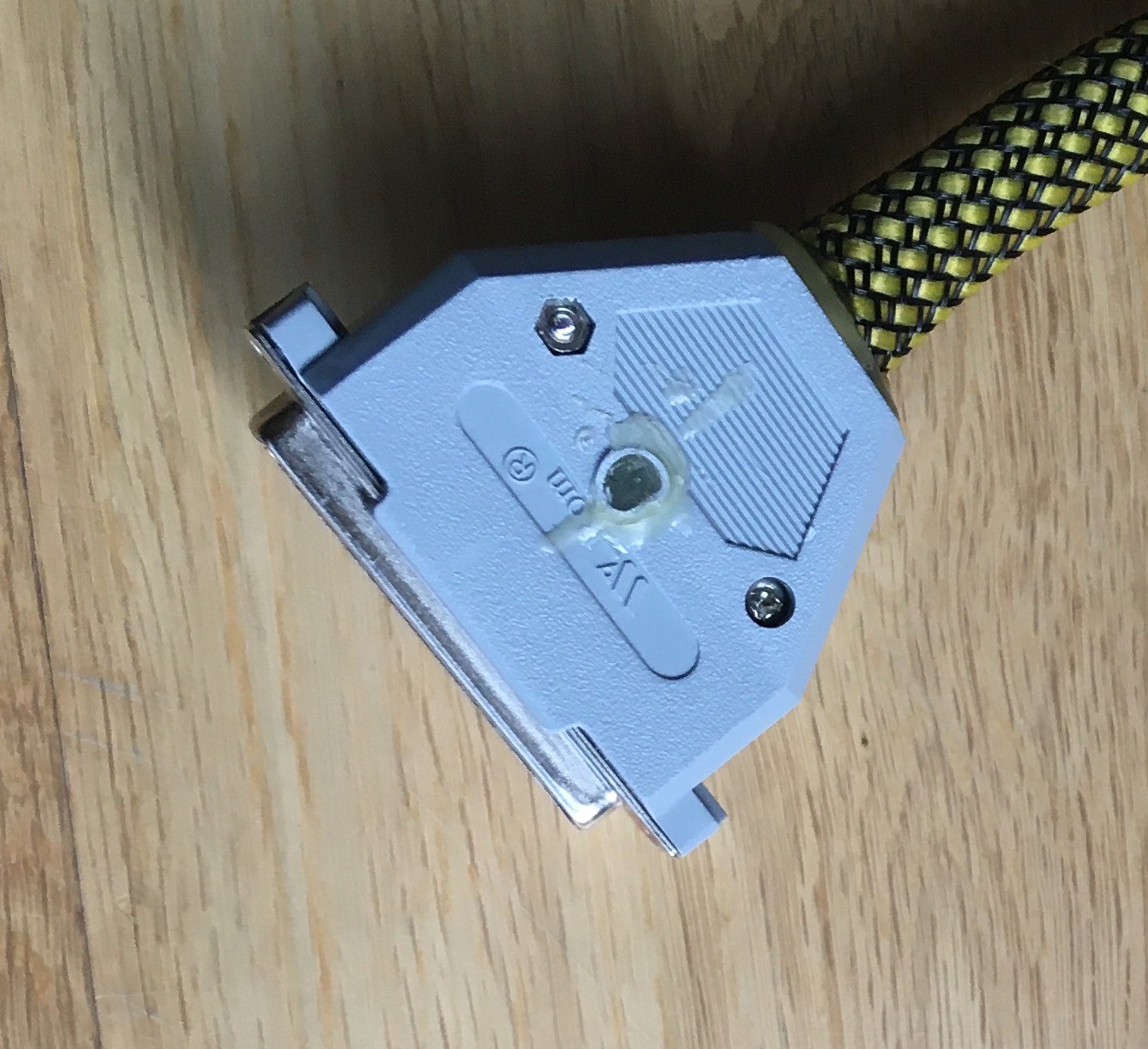

Postby jefferso » 12 Sep 2024, 12:10
Burgerman wrote:It is already a plastic cover. What are you hoping for this to achieve?
If the plug is mounted on the shroud, I'm worried about water getting in the plug holes in the end when I'm outside and it's raining, or dust etc.
There is one in your latest parcel. Dust cover of Dsub .
That seems to fit, thanks. It kept popping off though, looks like the end was damaged a little in the shipping.
jefferso

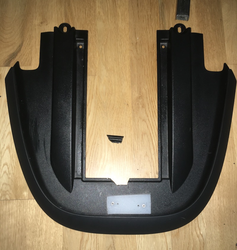

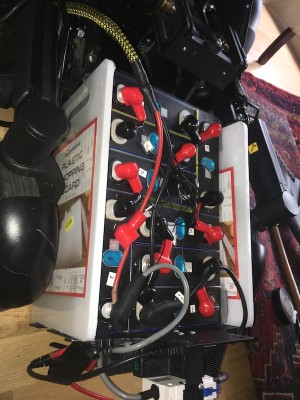

Re: Group 24 cells

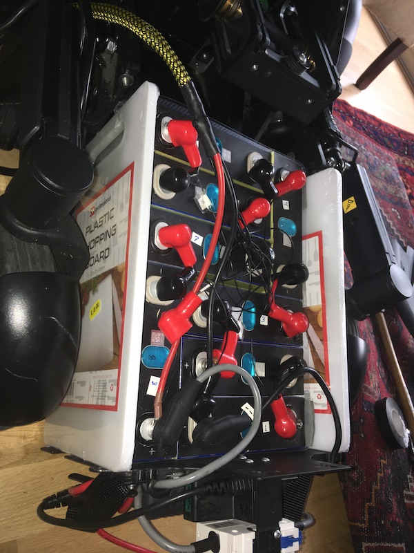

Postby jefferso » 21 Sep 2024, 22:52
The wood I used previously was half inch (1.3cm ?) plywood. It seemed to interfere with something. Even after cutting it lower and filing the edge a bit so it fit in better it still caused the chair to go into turtle mode after returning from a full backward tilt for some reason.
I got some chopping boards at the local market for £3 each and they were just the right size to nearly match 2 group 24 batteries side by side and about 0.8cm thick (5/16 inch?). An extra piece of cardboard wedged in next to it makes it snug. Two strips of acetate screwed in at the stop keeps them upright.
The cable could go out the side, around and then up to the middle in the back, but it seemed neater to cut a notch in the shroud so it could come right up in the back in the middle. A piece of chopping board is mounted to the top of the back shroud in the middle. I had another piece under the shroud to make it extra secure but I had to remove that and even file the nuts down a bit because there wasn't enough clearance under the shroud for the circuit breaker. The M3 bolts are just threaded into the plastic of the chopping board, so I hope that holds it in place well enough.
The chair doesn't seem to go into turtle mode any more after tilting back and then forward all the way.
It's currently getting a full charge.

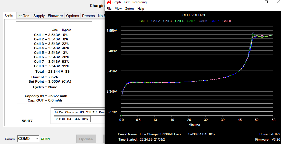

Postby jefferso » 21 Sep 2024, 23:26
Did some seating position changes to test, all seemed fine.
Just finishing a full charge now. Will maybe take it out for a spin tomorrow, though it looks like rain tomorrow…

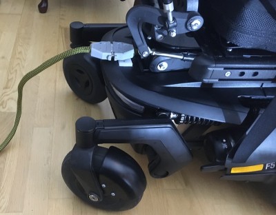

Here's how it looked with the charging cable coming out the side. Not terrible but this definitely looks neater.
