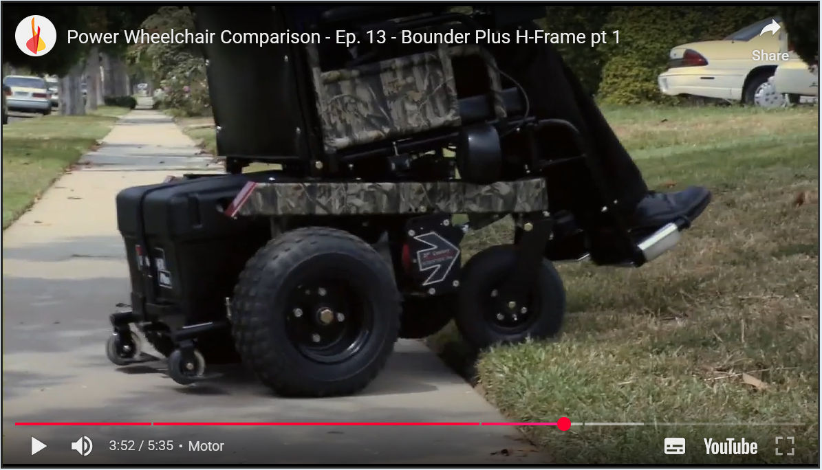

Postby Scooterman » 26 Oct 2025, 18:42
It's a good idea the user being able to temporarily switch off the annoying clicking brake
Looks like your van BM.
youtu.be/UKD5pO47b-A
Postby Burgerman » 26 Oct 2025, 18:54
Thats a newer version than mine.

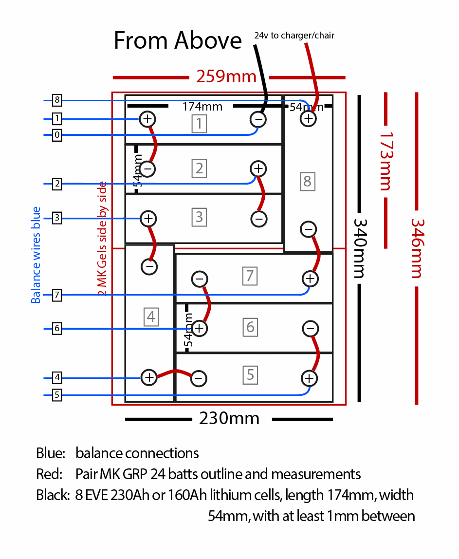

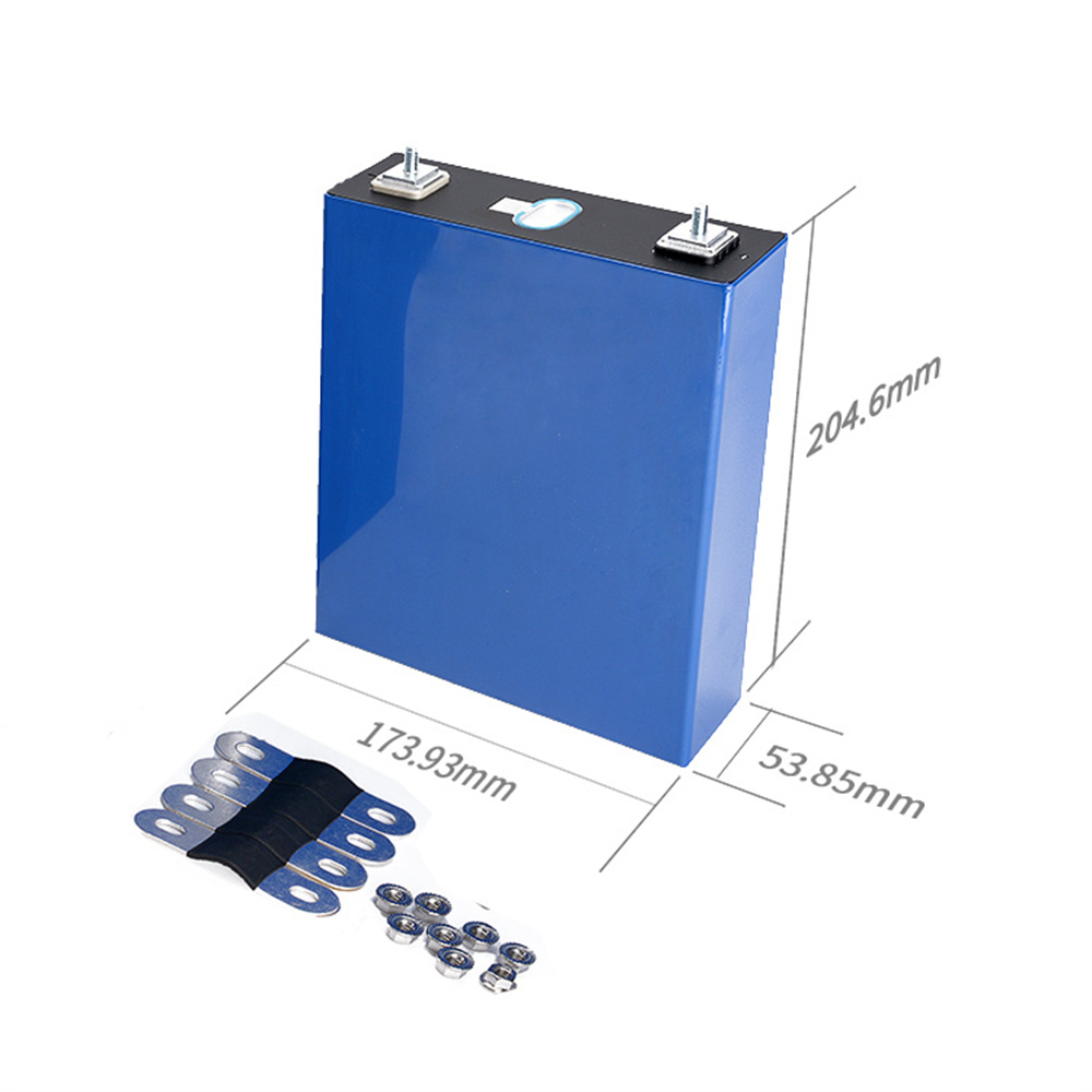

To fit a grp 24 box it must be 54mm thick max.
Posts: 70424
Postby emilevirus » 06 Nov 2025, 01:29
According to my measurements, it should fit. Will see when I receive them in about 2 months.
emilevirus
Posts: 381
Joined: 12 Aug 2020, 22:02
Postby Burgerman » 06 Nov 2025, 18:00
Take a look here:
A GRP 24 is 210mm inc terminals tall maximum (190 in practice).
And 168mm wide. And 260mm long.
And usually fitted side by side.
Giving this as the only possible arangement that will fit a 160 or 230Ah (244Ah) cells x 8.
There isnt another arangement that fits.
Posts: 70424

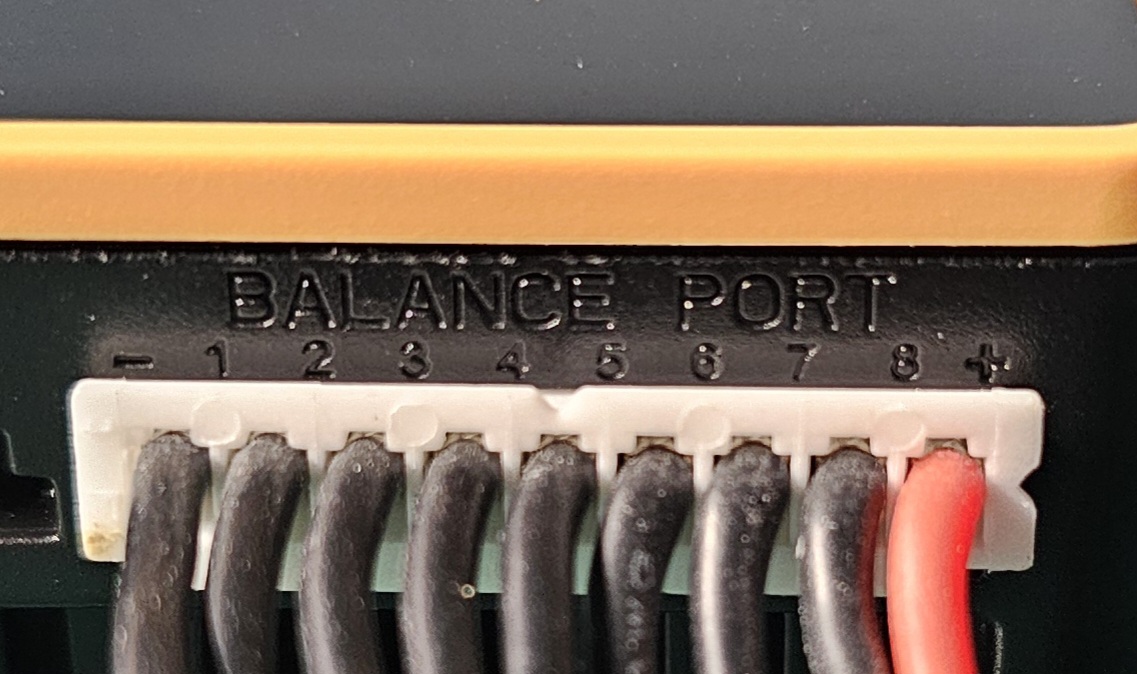

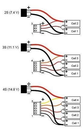

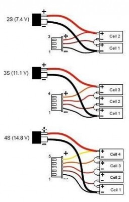

So I have everything soldered up and ready to go. But I have a newbie question, the balance lead I bought has 8 Black wires and one red one. What order do they go in? I tried looking for a wiring diagram but couldn't find one.

Postby ex-Gooserider » 18 Nov 2025, 02:12
I don't know your charger, but to figure it out, look in the charger docs (or even on the charger) and see what the order of pins is on the balance plug socket, and then see which wire is the red one when you plug in the cable. The red wire SHOULD be Pin #1 (or possibly pin #9) and go to the + on Cell 8 of the pack, the other black wires will go in order from the connector to each of the other cells, so that the one farthest from the red wire will go to the - of cell 1....
Look for some of the other diagrams of how the balance wiring is set up. It should also be documented in your charger manual (I know it is on the PL8)
Postby Burgerman » 18 Nov 2025, 02:15
Look at the charger. The negative end of the balance connector.
They are wired the same across all my hobby stuff, chairs etc.
The first wire is the same negative as the main charge cable.
So wire 1 is negative. It goes on the end negative of the pack. And that is cell one.
Wire 2 is next to it, and it goes to the other end of that same cell one.
Now, each wire in turn goes to the next postive on cell 2, 3, 4 etc.
You have 9 balance wires. So they go in turn to:
1. Cell1-NEG
2. Cell1-POS
3. Cell2-POS
4. Cell3-POS
5. Cell4-POS
ETC
When you get to
Wire 9. Cell8-positive thats it!
You are done!
Below 2S, 3S, 4S, Obviously 5, 6, 7, 8, same but more.
Always 1 more wire than cell count.
On your plug I do not know if that wire marks the neg or the pos end. If red its likely pos. Dont count on it! You need to check the connector.
Posts: 70424
Postby Burgerman » 18 Nov 2025, 02:36
Red to the 24V pos.
All the rest to each cells negative end in sequence... But check on the charger as the red wire may not be at the pos end on your cable. I saw a couple that were not as expected.
Posts: 70424
Postby shirley_hkg » 18 Nov 2025, 10:10
wchl25 wrote: But I have a newbie question, the balance lead I bought has 8 Black wires and one red one. What order do they go in? I tried looking for a wiring diagram but couldn't find one.
https://share.google/EwJQf1yzHlpWHMmQV
Posts: 4560
Postby wchl25 » 18 Nov 2025, 17:51
The red wire is in the #9 position at the positive end of the port.
So I'm assuming that it goes on the positive side of cell #8?
wchl25
Posts: 99
Joined: 01 Jul 2020, 22:53
Postby Burgerman » 18 Nov 2025, 18:24
Yes. Since its 8S.
Its easier to to always work the other way around and start with cell 1.
So the wire on the extreme left goes to the neg on cell 1. The same as the negative on the charger.
Then each wire in step, goes to each positive in a row.
The first wire is alwys the neg on cell 1. At the 0V end of the battery. Because working that way around is mentally easier than starting att cell 8 and going backwards.
Posts: 70424
