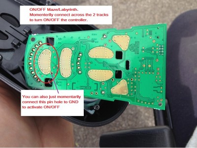

With your VR2 you could try cleaning the maze/labyrinth under the ON/OFF button ... this will entail taking the pod apart, not a difficult task.
Use a rubber / erasure or GENTLY rub with a the scourer pad side of a washing up sponge.

Pic that may help if you take the pod apart ...it shows the location of a black locking oval pin that should be depressed to allow the board to slide out to gain access to the various activation pads on the reverse side.

woodygb wrote:Pic that may help if you take the pod apart ...it shows the location of a black locking oval pin that should be depressed to allow the board to slide out to gain access to the various activation pads on the reverse side.

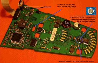

Thanks. Right got it removed with help from your info :) and this is it:
All cleaned but still no life :( I've looked at the PCB but can see now blown parts either.
You mention "Home brew software" Any chance of pointing me in the right direction for this please?

You must clean the oxidized metal that the rubber presses against with a scotch bright cloth or similar.
