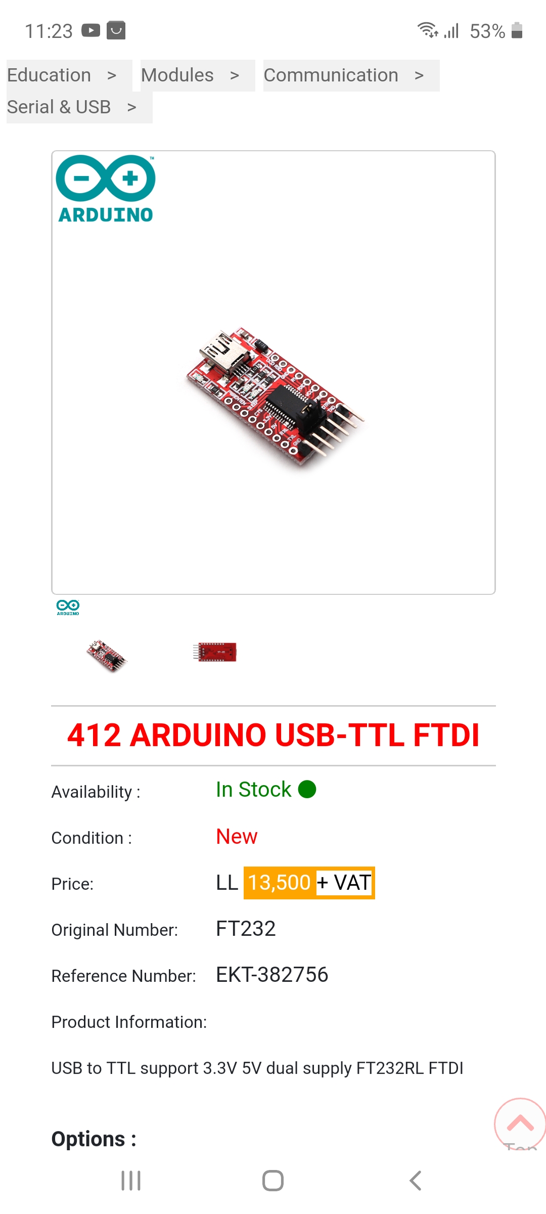

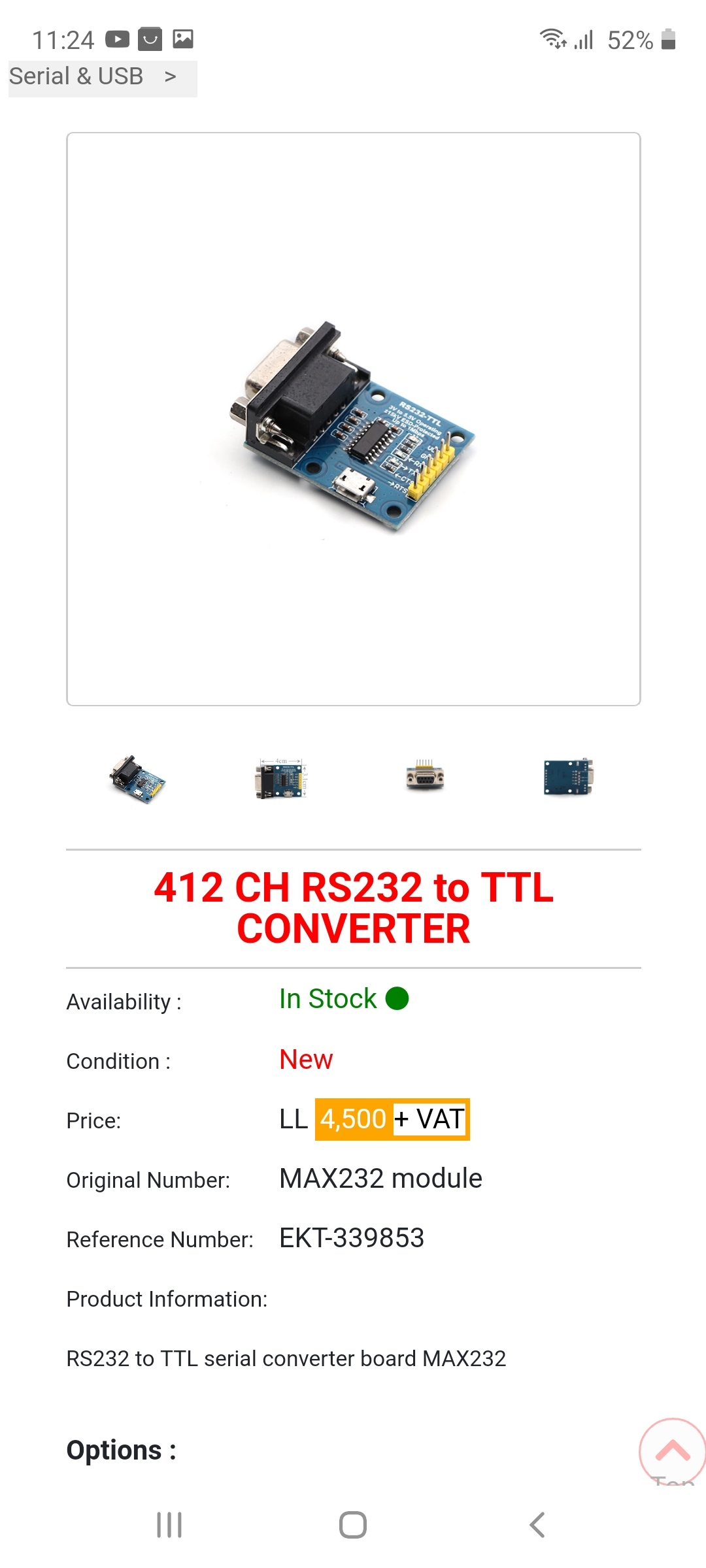

Also i was wondering if i connect everything i just have to turn on the scooter with the key right? not adding any other power wire to the programming connector like pg drives do. Would these boards im gunna attach might work instead of this cable by any chance, because i already i have them

And this

Khalid wrote:Also i was wondering if i connect everything i just have to turn on the scooter with the key right? not adding any other power wire to the programming connector like pg drives do. Would these boards im gunna attach might work instead of this cable by any chance, because i already i have them
You can probably make that work...
As Irving say's ... yes it should.
Just remember that the connection convention is TX of one board goes to the RX of the other .
