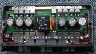

I presume you haven't looked inside your power module yet then?
Image :lol:
Nothing to be scared of. You just get to see how crappy the build quality is, wit only a rubber foam pad making the pressure for all the connections to the power mosfets. Amazing they don't fail more often. And that they are using just 8 power mosfets. Unlike the Roboteq with 32... No wonder they get hot really is it.

Well surprisingly it does appear to work pretty well! I and the rest of us using all of PG Drives systems, inc Rnet should take the thing apart and use a scotch bright cloth or fine glass paper to clean those contact point every year or so though. It will likely prevent failure.

The contact points your talking about to clean - are the plugs where you plug in the cables ? or inside the box itself -
Re: Rebuild BM2 green...
Postby Burgerman » 03 Feb 2016, 17:03
Look at the pictures. Inside. They just press together with a bit of foam! That is supposed to be OK for 100A per motor.

Postby Irving » 03 Feb 2016, 17:49
I don't suppose you know what MOSFETs they are, or have pics of the other side of the board showing them??
Postby Burgerman » 03 Feb 2016, 17:53
The side with the writing is folded on to the board so not visible without bending them up. I did compare an 80 to a 100 years ago and they were the same. So its only a firmware difference.

50 Amp PM insides...

Postby steves1977uk » 04 Feb 2016, 18:06
PG 50 Amp PM 7 Photos inside a 50 amp PM.

Postby Burgerman » 04 Feb 2016, 19:13
Trans MOSFET N-CH 55V 85A 3-Pin(3+Tab) TO-220AB
Does it help?
Where is the sense resistor?
Posts: 70457
Postby Irving » 04 Feb 2016, 19:17
but none show the MOSFET type. :(
There are 8 MOSFETs in the H-bridge, arranged in 4 pairs. At any one time only 2 of the 4 pairs is on, each MOSFET carrying 1/2 the current, so if limited to 100A each would be carrying 50A. A typical MOSFET from as little as 4y ago will have an on resistance of around 20milliohm, so heat losses = I^2 * R = 50 * 50 * .02 = 50W, WORST CASE at stall per MOSFET, which is fine with a decent heatsink. It'll get hot (case temp ~100degC) but wont die.
Replace that with a current top-of-the-range HexFET. On resistance 6.5mOhm, so for the equivalent heat loss it can handle 100A, or putting it another way a 100A controller could, in theory, be upgraded to 150A with a reduced heat loss of 36W per MOSFET and a case temperature of around 60degC (assuming its just a sense resistor that needs to be changed as well).
And the price? £14 inc p&p
That's a lot cheaper than a RoboTeq! In fact the Roboteq's oft quoted 32 MOSFETs (per channel?) is arguably overkill using current technology.

Not really, could be any one of 100s of devices...

Burgerman wrote:http://www.eurotech.co.uk/dynamic/detail.php?part1=AUIRF2805&man=INTERNATIONAL+RECTIFIER
What about one of these?
Actually those are pretty good devices, apart from they are no longer manufactured, not dissimilar to the ones I was suggesting. 55v a bit low for my liking on the regen spikes, but if that's what's fitted then just changing the sense resistor would work to 125 or 130A. I'd not take it to 150A

Postby Burgerman » 04 Feb 2016, 19:32
Does it help?
No, thats what it said on the 50A photo one!
