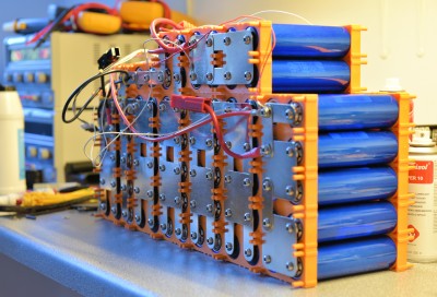

Just starting a discharge test on my NEW 120Ah headway pack.
Initial charge at 40A inc balance took a few mins. All cells were sat at 3.600V until 100mA reached. Nothing exceeded 3.652. Balance started at my chosen 3.500V and not before.
Initial charge 3.650V
All future charges will be at 3.600V or 3.550V and at 40A. Balance on a carefully built pack with 1A cont proportional variable balance and variable charge rate means full charge and balance achieved for 120Ah is 3 hours 5 mins (+/- 3mins) from 100% dead to 100% full.
Two mouse clicks, one connector. No BMS.
Posts: 71111
Postby Burgerman » 15 Jan 2016, 15:24
Wiring not yet tidied up yet but already under test!
120Ah, 80 cells, in 2 parts.
Each of the 8 groups have matched self discharge levels, (tested as individual cells over 6 weeks) and equal capacity. Actually they were all so close to within around 20mAh to 2.800V at 1C that measuring that was a waste of time. But at least I know.
Posts: 71111
