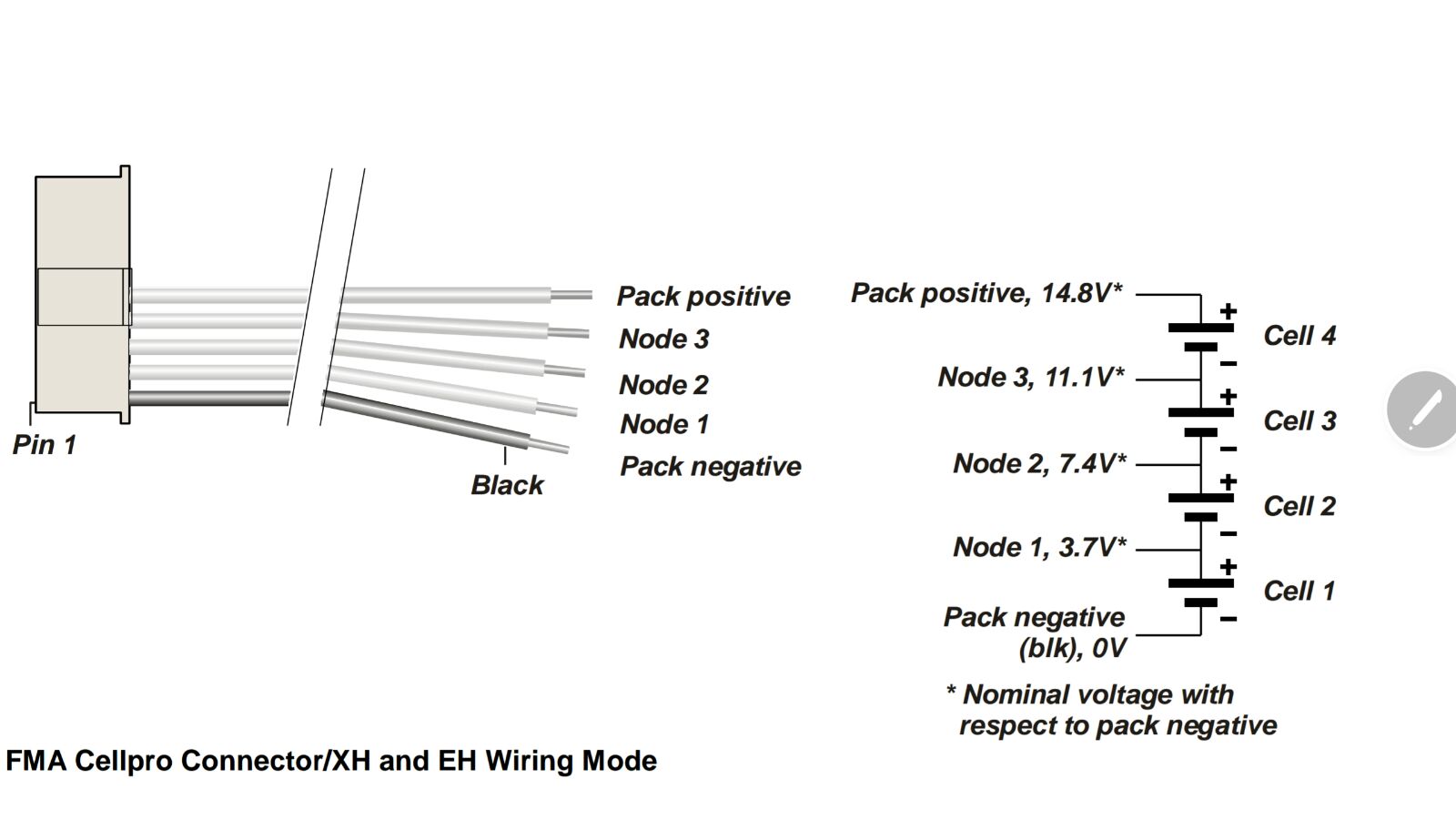

How do i charge a 12 Volt pack with the PL 8 - i want to make a 12 V 15ah pack - 4 cells - but the balance wires - the cable has 8 of them - do they sell a cable that has only 4 wires - to use on the PL 8 end ?
Postby shirley_hkg » 20 Apr 2017, 03:13
Connect the 5 balance leads of your D-sub , 0V , 3.3V , 6.6V ,9.9V , 13V

Can the balance cable from the PL8 with 9 wires on it - can i make a balance wire for the 12Volt pack just using the correct wires that are needed leaving the rest of the wires not in use alone - would the PL 8 when plugged in with this balance cable this way - would work ?
Postby Burgerman » 21 Apr 2017, 21:49
Yes. I charge 1, 2, 3, 4, 5, 6, and 8S batteries like that for my hobby stuff.
