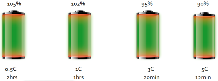

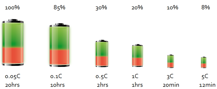

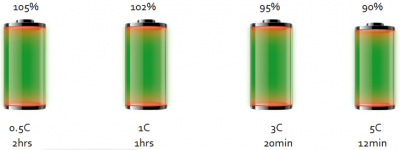

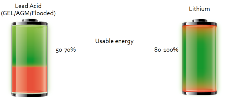

Postby Burgerman » 27 Jun 2018, 17:34
Its like this... ORANGE bits hurt the battery.
and...
LITHIUM ENERGY USABLE AT SLOW AND FAST DISCHARGE RATES (if you want the cell to last avoid orange bits!!!)
LEAD ENERGY USABLE AT SLOW AND FAST DISCHARGE RATES (if you dont want to kill it, avoid orange bits!)
Remember we can set off at 8mph, we have at best 16 miles range. Thats 2 hours. Look at the 2 hour rate... :fencing
LOOK AT THIS VERY CAREFULLY. IT EXPLAINS THE BIG DIFFERENCE WE SEE WITH LITHIUM ESP ON OFF ROAD OR FASTER CHAIRS.
Charts thanks to Victron Energy.
Posts: 71112

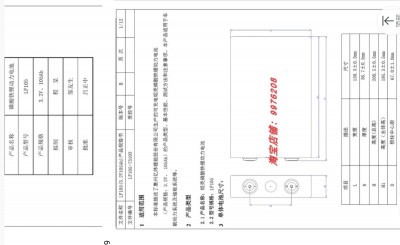

Postby shirley_hkg » 06 Jul 2018, 14:49
Found this EVE-LF105 , same size as the 90A counterpart , but 105Ah . butred @£32
Re: Sinopoly Cells - Info -
Postby Burgerman » 06 Jul 2018, 15:22
MEANING that you can fit 210Ah in place of lead, provided that you have JUST 4MM mm extra width available over a grp24 battery.
The math:
Cells are in mm:
130.3
37
200
37 x 8 = 296
37 x 4 = 148
We have a 240mm tall box. With 260 (or more) x 340 (or more although this way not an issue)
Arranged as
2 side by side is 260.6 (plus 3mm insulation from 1mm sheet so 263.6 total)
8 deep gives 296 (plus 9mm insulation so 305 total)
So with careful measuring it might just fit 16 cells.
210Ah in place of 74 (45 to 50 usable) So 5 to 6 times stock range. For £512
HOW MUCH will this cost to ship to UK in pounds for 16 cells and a huge 210Ah pack?
Thanks!
Postby Burgerman » 06 Jul 2018, 19:46
>>>I'd be very interested in those cells, but they won't fit in my chair's battery area. :fencing
Are you very sure? Because I think they will fit my (returned) storm, and the new salsa, and definitely the BM2/3 chairs. And the F55s, and the storm 3 in my garage.
They will fit any place a grp 24 battery like the MK will, as long as you have literally a couple of mm (3.6) clearance to slide in an MK longest side. Most chairs actually do. Make up a 263.6 x 309mm box, 210mm tall to allow for cables. If it will fit, so will these cells.
They are each 130 wide, So 2 is the same as an MK. the ones you link to are 135 wide. So need to be turned around. And then you get 150Ah rather than 210Ah with wasted space on 4 sides.
