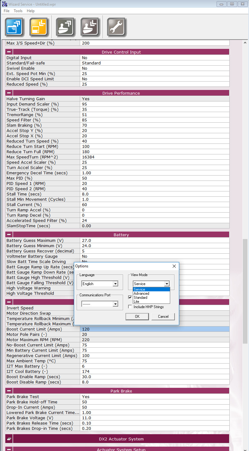

Postby Burgerman » 15 Jan 2017, 16:19
Note battery (meter) menu below...
That will allow me to set say 3.35v per cell as 100 percent. (26.8V) and then fine tine until it reads full for first mile or so.
Then set say 3V per cell (24.0V) as the red/end of play.
And set it to VOLTS rather than a fuel gauge.
And 9 other battery meter settings to fine tune for lithium accuracy!
And I can set it to stop the chair completely for safety at (2.8v per cell) 22.4V.
download/file.php?id=5945&mode=view
Posts: 70464
Postby steves1977uk » 15 Jan 2017, 17:27
Wonder why Curtiss-Wright (PGDT) didn't implement this on their controllers?
Postby Burgerman » 15 Jan 2017, 18:04
Because you need a better than OEM to get to it... But it obviously can.
SERVICE appears to unlock the factory stuff thats OEM wont...
Posts: 70464
Postby Gnomatic » 15 Jan 2017, 20:16
Burgerman wrote:Note battery (meter) menu below...
What controller is this for?
Posts: 2123
Postby Burgerman » 15 Jan 2017, 20:20
Dynamic - gearless brushless in this case.
Posts: 70464
Postby Gnomatic » 15 Jan 2017, 20:48
DX2 then I presume?
Very cool you get rid of the worthless fuel gauge and change it display the voltage.
Posts: 2123
Postby Burgerman » 15 Jan 2017, 21:02
Actually the fuel gauge can be made to work. It will be as garbage as always, but will tell you when to stop before you do...
Posts: 70464
Postby steves1977uk » 16 Jan 2017, 12:04
That's the next challenge then, to get hold of the SERVICE software :mrgreen: :twisted:
