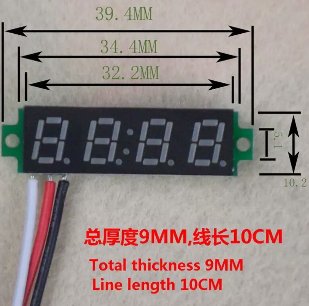

Postby shirley_hkg » 13 Feb 2017, 02:42
I switched to this . This is the smallest , 4 digits voltmetre . :D
It has a potentiometer to calibrate reading . Very accurate .
$1.00 each .

Postby Gnomatic » 14 Feb 2017, 18:14
shirley_hkg wrote: I switched to this . This is the smallest , 4 digits voltmetre . :D
$1.00 each .
Do you have a link to something like this shirley?
Posts: 2123
Postby Burgerman » 14 Feb 2017, 20:43
I found that on ebay.
Posts: 70469
Postby Gnomatic » 14 Feb 2017, 23:11
Posts: 2123
