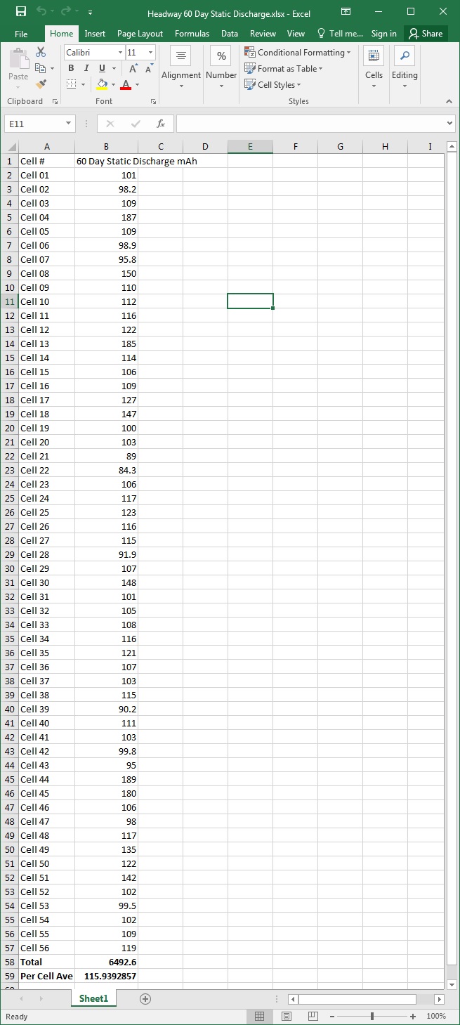

Finished topping the cells off. Here's what they look like.
Headway 60 Day Static Discharge.xlsx.zip
(11.73 KiB) Downloaded 235 times

So now you make 8 groups of 7, that add up to 811.6mAh total lost! Give or take a few mA. And assemble a pack.
Posts: 70440
Postby Gnomatic » 30 Mar 2017, 22:28
Burgerman wrote:So now you make 8 groups of 7, that add up to 811.6mAh total lost! Give or take a few mA. And assemble a pack.
That's the plan!

Postby Gnomatic » 31 Mar 2017, 04:06
Here are my groupings ....
(60 day static discharge test)
Group 1
Cell 12 - 122
Cell 16 - 109
Cell 22 - 84.3
Cell 23 - 106
Cell 36 - 107
Cell 43 - 95
Cell 44 - 189
Total 812.3mAh
Group 2
Cell 04 -187
Cell 06 - 98.9
Cell 10 - 112
Cell 15 - 106
Cell 17 - 127
Cell 21 - 89
Cell 28 - 91.9
Total 811.8mAh
Group 3
Cell 13 - 185
Cell 24 - 117
Cell 38 - 115
Cell 39 - 90.2
Cell 42 - 99.8
Cell 46 - 106
Cell 53 - 99.5
Total 812.5mAh
Group 4
Cell 02 - 98.2
Cell 07 - 95.8
Cell 09 - 110
Cell 20 - 103
Cell 35 - 121
Cell 41 - 103
Cell 45 - 180
Total 811mAh
Group 5
Cell 08 - 150
Cell 31 - 101
Cell 37 - 103
Cell 47 - 98
Cell 49 - 135
Cell 50 - 122
Cell 54 - 102
Total 811mAh
Group 6
Cell 03 - 109
Cell 14 - 114
Cell 25 - 123
Cell 29 - 107
Cell 30 - 148
Cell 52 - 102
Cell 55 - 109
Total 812mAh
Group 7
Cell 01 - 101
Cell 18 - 147
Cell 27 - 115
Cell 32 - 105
Cell 33 - 108
Cell 34 - 116
Cell 56 - 119
Total 811mAh
Group 8
Cell 05 - 109
Cell 11 - 116
Cell 19 - 100
Cell 26 - 116
Cell 40 - 111
Cell 48 - 117
Cell 51 - 142
Total 811mAh
Assuming my primitive Excel skills didn't fail me, all 8 of my groups are within 1.5mAh of each other following static discharge testing and grouping. I don't see much point continuing to fiddle trying to make that number smaller. Feel free to check my math ....

Postby Gnomatic » 31 Mar 2017, 19:10
Burgerman wrote:Its only got to be approx. Most people never do this.
I understand the objective here is to build the pack in such a way to prevent the cell groups from getting too far out of balance during long term storage situations. So just in general, if the static discharge varies between the groups by say no more than 1% after 60 days, its okay to conclude the pack shouldn't have balance issues when it comes out of long term storage. Would you agree?

Postby Gnomatic » 01 Apr 2017, 18:11
Reading back through your thread for your pack build expresso, and doing a bit of number crunching, it looks like each of the cells in your pack averaged 1.71mAh/day of static discharge. Comparing to the cells I got, my cells averaged 1.84mAh/day on static discharge each in this phase.
Also, the cells you got for your pack have a black negative end and a red positive. The cells I got have a white positive end.
Not that any of that matters really, just a couple observations.
Posts: 2123
Postby Gnomatic » 01 Apr 2017, 19:08
Also, had I not tried to organize my cells by static discharge, and just took the first 7 cells out of the boxes and put in Group 1, the next 7 in Group 2 etc etc, I would have ended up with a 180mAh difference between my lowest and highest group following 60 day static discharge.(had I gone back and measured).
Instead, I got a 1.5mAh difference between my groups. 180 vs 1.5 seems significant, but I have no idea what the real word implications of that would be.
Posts: 2123
Postby Burgerman » 01 Apr 2017, 19:24
Well it means that with a typical BMS that has claimed 50 to 100mA max balance ability, and in reality they never reach this unless miles different. So it would add 4 to 8 hours re-balancing time to a charge after 2 months. 3x that after 6 months. So potentially a day or more.
The PL8 has 1A balance so it will take that about 10 to 15 mins. Or about an hour after winter say. But you were lucky. Sometimes its possible to find a few cells with higher self discharge. Add 2 or 3 of these to a group and then it makes a massive difference.
Posts: 70440
Postby Gnomatic » 01 Apr 2017, 20:17
That makes sense. My average discharge per cell was 116mAh. However, I had four cells that took in 180+ mAh. Had I been unlucky and those cells ended up in the same group, along with four average ones, then I'd potentially be looking at 400+mAh variance between the groups at the 60 day self discharge rate. And rebalancing out of storage would take a really long time...... especially if I was relying on a BMS to rebalance.
Posts: 2123
