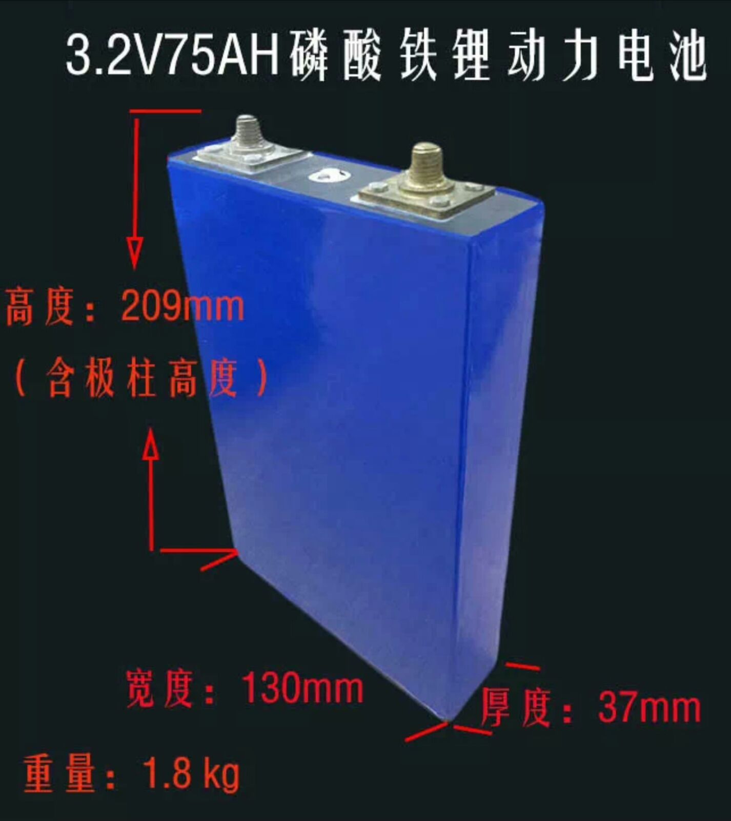

Postby shirley_hkg » 05 Apr 2017, 03:10
Will you consider this also ? Rated 3C .
Pretty sure you can put 2P8S @150Ah in G24 space
Claimed to be BYD's new old stock at less than @ £20.00.
Posts: 4568
