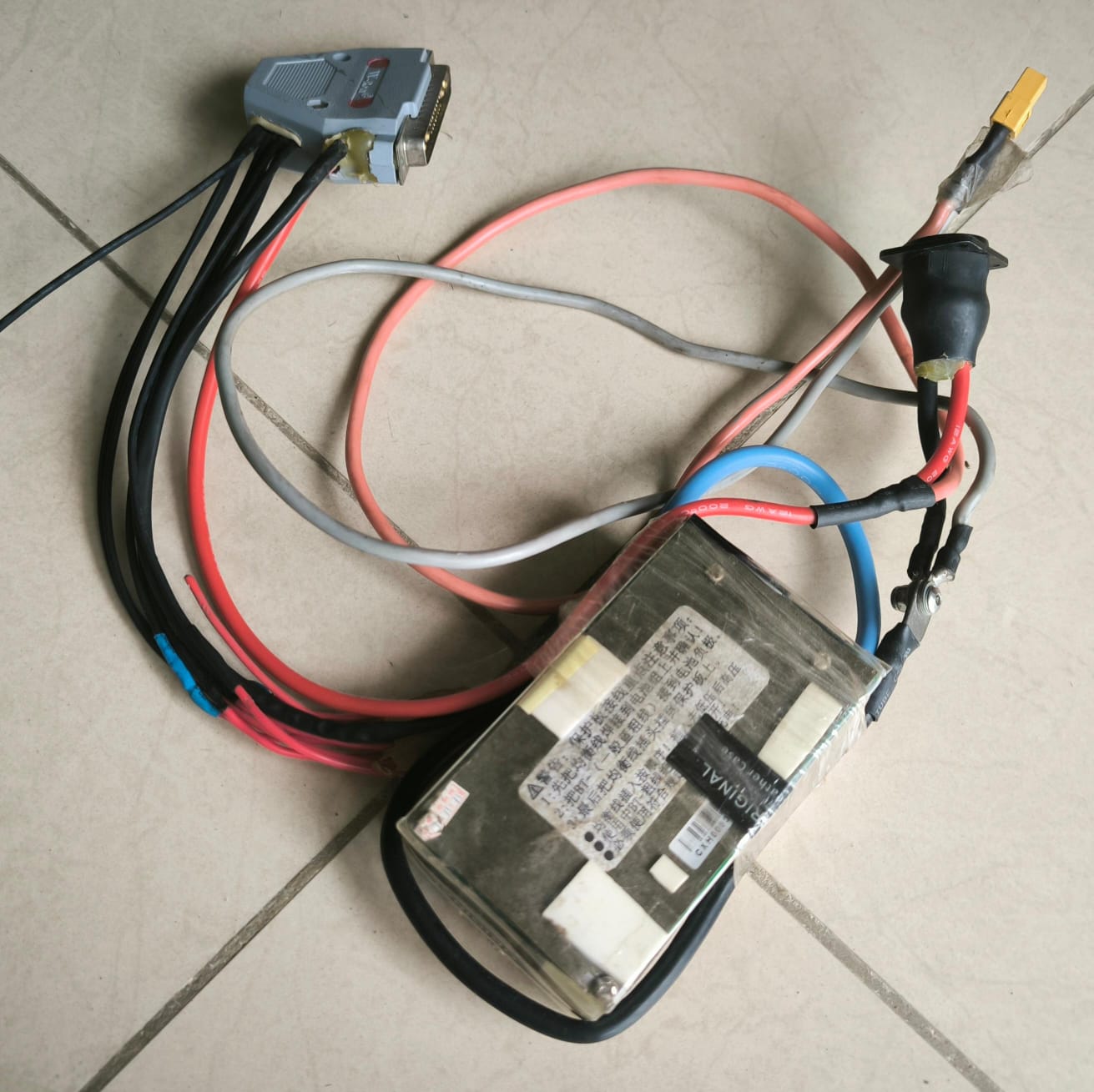

jefferso wrote:What happens if some overly helpful PA or helper plugs in my old charger to the XLR port while I'm in my old chair or in bed or something?
Will it charge the LiFePO4 pack at 12 amps, just without balancing? Or not even charge unless voltage is 28.2 or lower?
There is way to use dump charger for your pack safely , if you were away from home and you don't want to carry PL8+PSU with you.
Let me know.
Let me know.
I'm interested in this, does it involve a BMS?

Postby shirley_hkg » 23 Sep 2024, 11:52
YES.

Postby shirley_hkg » 24 Sep 2024, 06:50
It's pretty primitive, that's just a BMS with a matching male Dsub to plug into chair's connector.
Belows is 10 years old. You can now find a modern BMS with user programmable parameters.

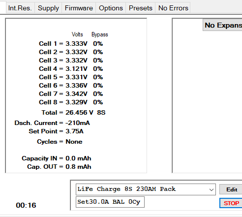

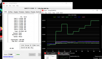

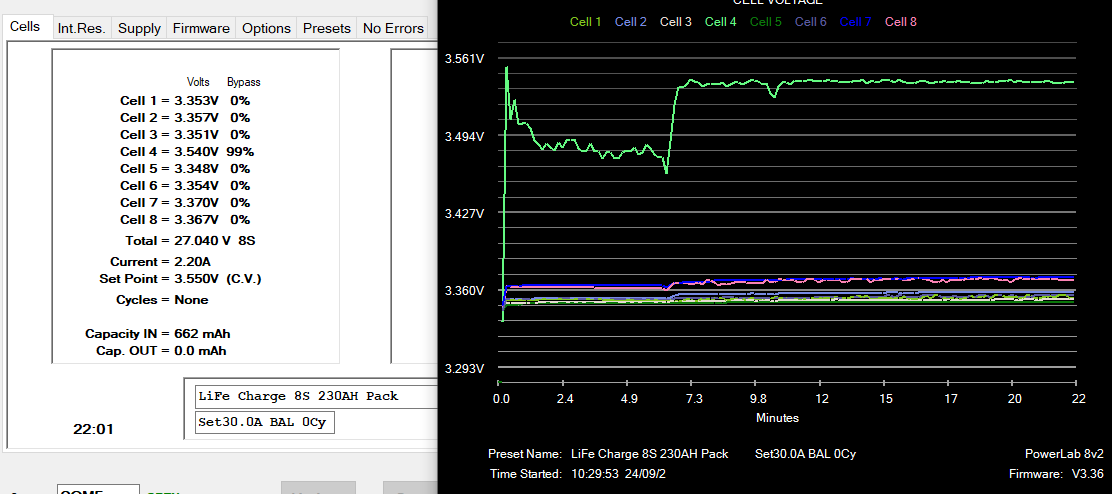

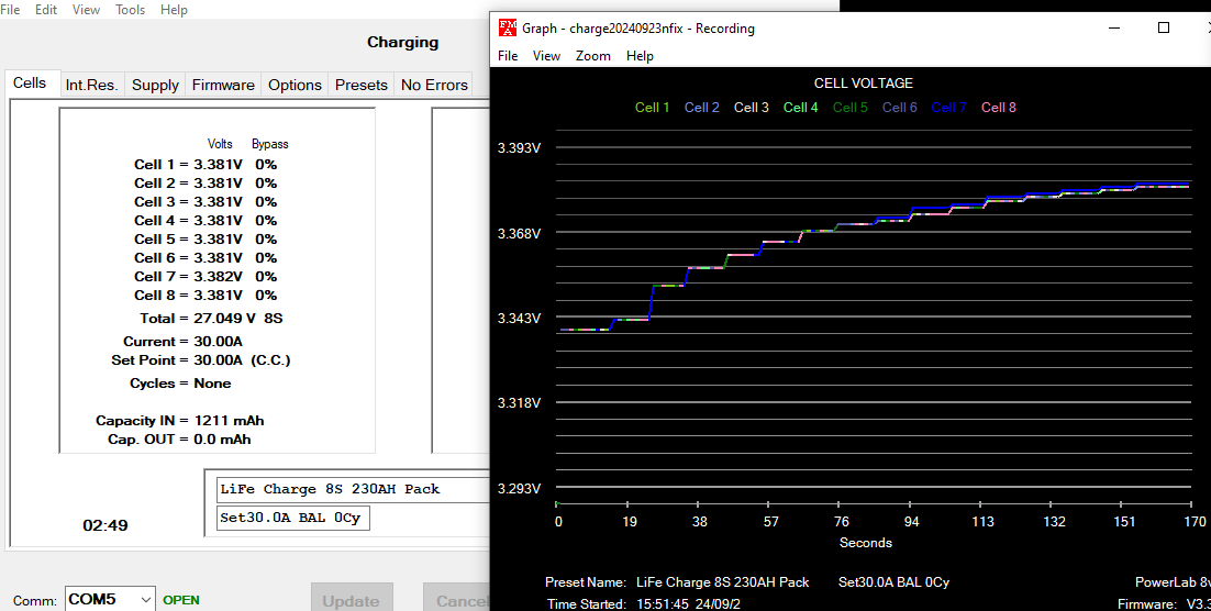

Yesterday I went about 5km and ran my ventilator most of the day on the chair. The joystick indicator stayed all green. The Permobil phone app seemed confused for the battery, showing 83% for a while, then 98% then 96% then 98% again.
But today attempting to charge, I tried to charge at 40 amps instead of 30 amps. It worked for a few minutes, then said power supply unstable. I set it back to 30 amps.
I am now getting Cell 4 going very high on charge, so it immediately goes to CV and bypasses Cell 4. I tried discharge and Cell 4 goes immediately below the low voltage and the discharge ends.
Is Cell 4 likely bad? That's the one that had a spark across it when assembling the pack.
I also had a SAFETY CODE 17: Cells No Add Up when I tried charging with 35 amps.

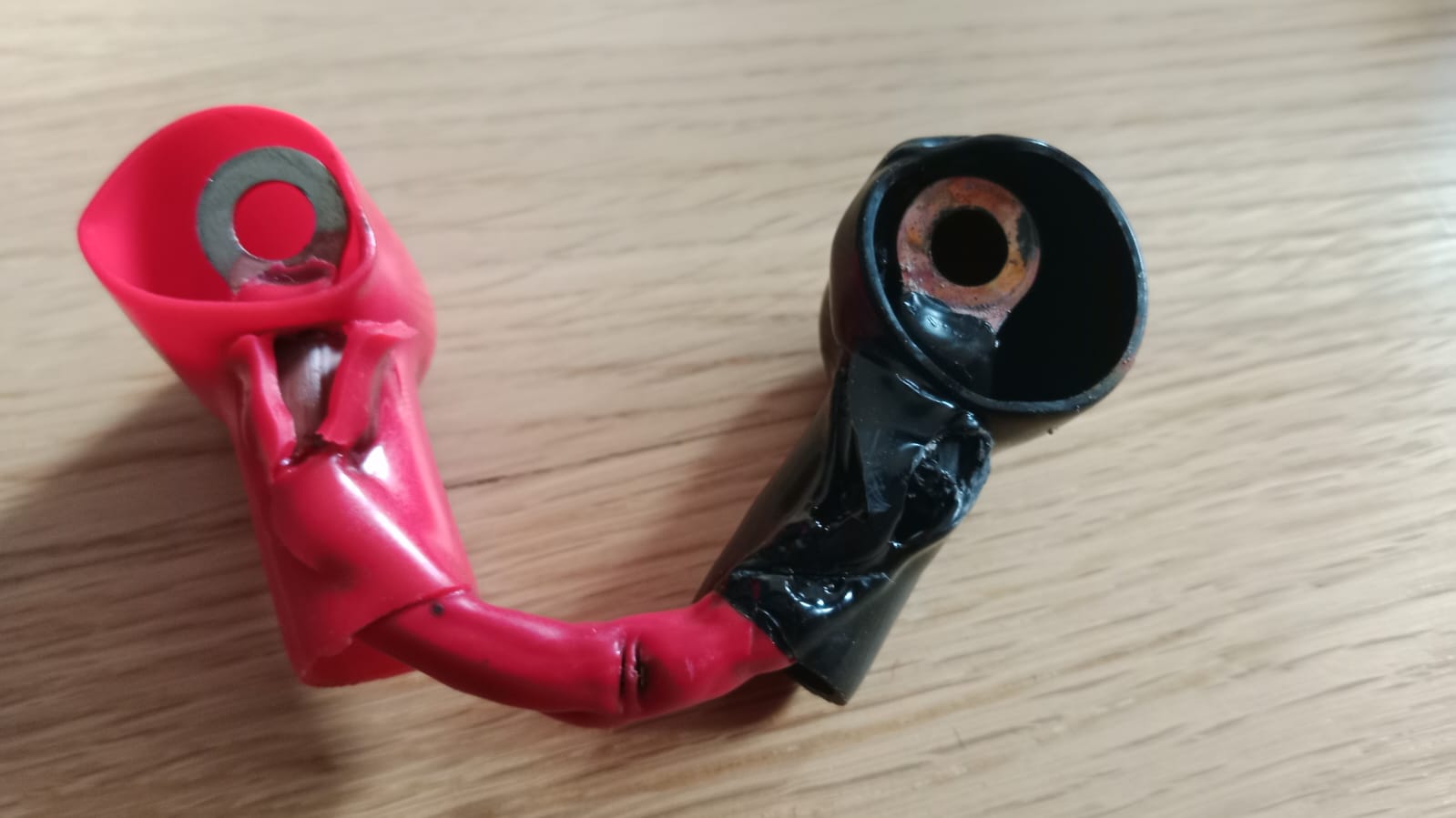

What you have there is a bad connection. I think. Very common.Either some connection is loose. Or you didnt solder everything and are relying on crimps...
Can be a balance connector, main battery terminal connection, charger end, battery end, the subD in the middle, or somewhere.
Clean all surfaces, use switch cleaner, and solder anything that is crimped.

Thanks! Definitely a loose connection. The terminal nut on cell 3 positive seems like it had only been hand tightened. A clue was the smell of melting plastic. It caused enough heat to melt some of the insulation on the interconnect cable and melted the plastic terminal cover. Got those off, got everything cleaned, wound some electrical tape over the damaged insulation on the interconnect cable. Put it back on with new spare insulation boots (fortunate they come in batches of 20 instead of just 16), checked and tightened all terminal nuts. Only had time for a five minute test charge, but all cells were very close in voltage and none of the covers or cables were warm.
I guess the lesson is if you have a helper who doesn't have experience with things like this, or isn't by nature careful and methodical, just saying "tighten them all" isn't sufficient. I guess it's best to watch and confirm for each one.

Postby shirley_hkg » 25 Sep 2024, 11:39
High heat seemed to have caused high resistance to wires.
Better have it replaced.

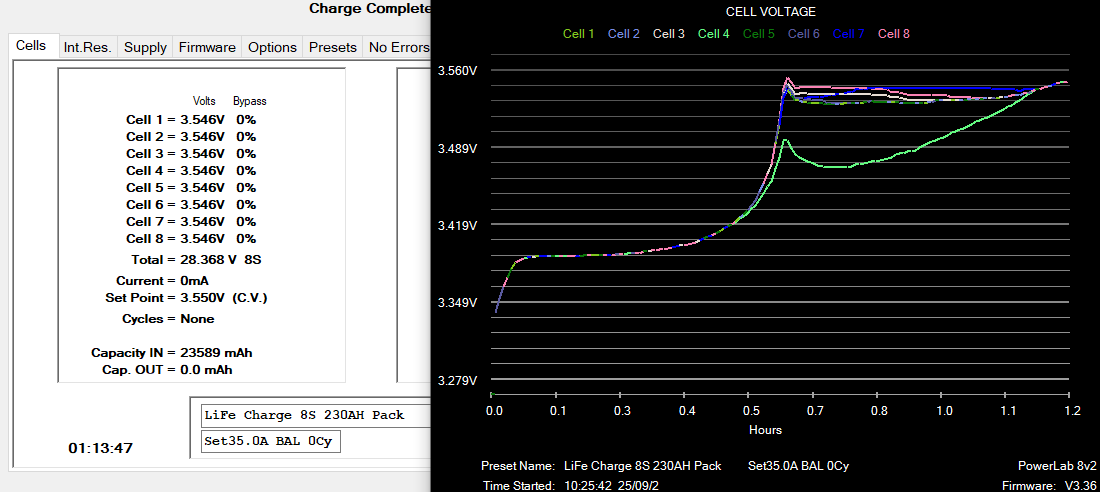

Postby jefferso » 25 Sep 2024, 15:18
Did a full charge today and everything seems much better. Cell 4 showed up as lower than the others for a while, but it kept getting bypassed yesterday so maybe that's not unexpected. I guess I'll see how it does with the next full charge.
It put back 23.5 Ah, and maybe a total of 4 or 5 Ah yesterday before the melted plastic smell, which is about what I would expect for 5km and using the vent most of the day.
So the heat might have affected the interconnect cable's resistance? Not just melted the insulation? I'll check on getting a replacement.

Postby Burgerman » 25 Sep 2024, 16:44
Cell 4 was just lower.
Should be almost perfect next charge or so.
Cable resistance should be fine. As long as they are soldered. And are STILL soldered! Personally I would take a careful look. Maybe measure resistance but that needs a very very good meter. If in doubt swap it.

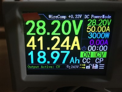

Postby jefferso » 26 Sep 2024, 12:34

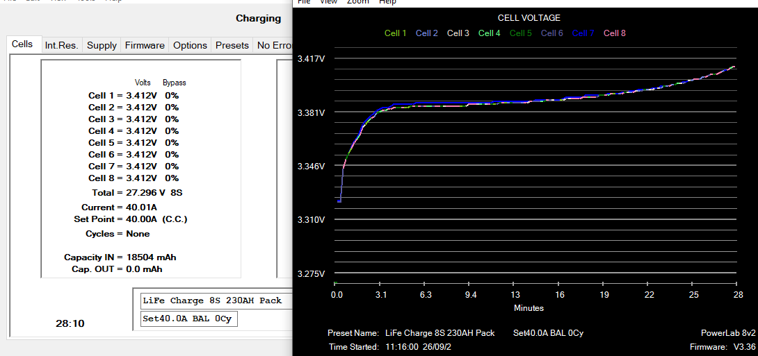

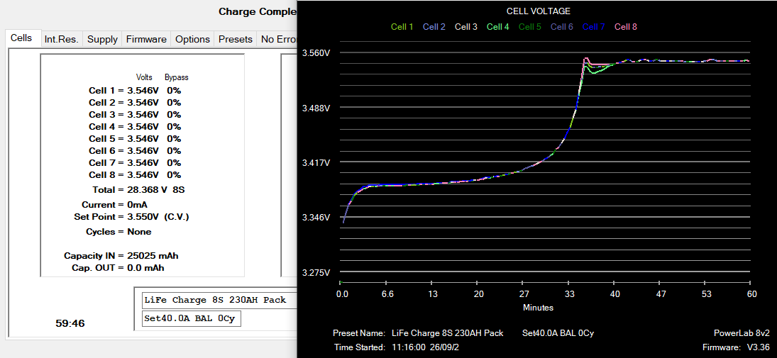

I switched the power supply to the new ZXD and did a charge at 40 amps.
Seemed to work well and cells were much closer at the end. The ZXD is pretty quiet even at 40amps. The PL8v2 is louder.
The ZXD was showing 18.97 Ah while the charger was showing 18.504 Ah. It was using 41.24 amps to drive the charger at 40 amps.
Put in 25 Ah from running the vent on my chair all day, moving around in the house and doing seating adjustments and standing.
It had put in most of the charge within 45 minutes. Amazing to charge at 40A and put in a day's worth of use in under an hour. Of course it will take longer when I go out, and travel some distance but impressive compared to all night charge for an average day and even then probably not charging long enough to be really good for the MK gel batteries.

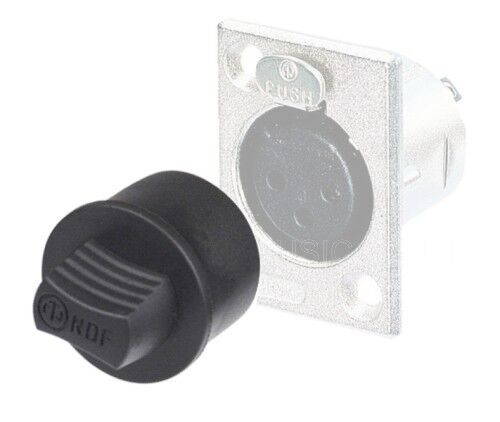

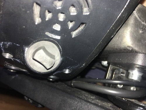

Postby jefferso » 26 Sep 2024, 16:57
I taped it over and then ordered a "Neutrik Dummy Plug For XLR" from ebay. I thought it would be stiff plastic but it's kind of flexible rubber. It seems to work anyway.

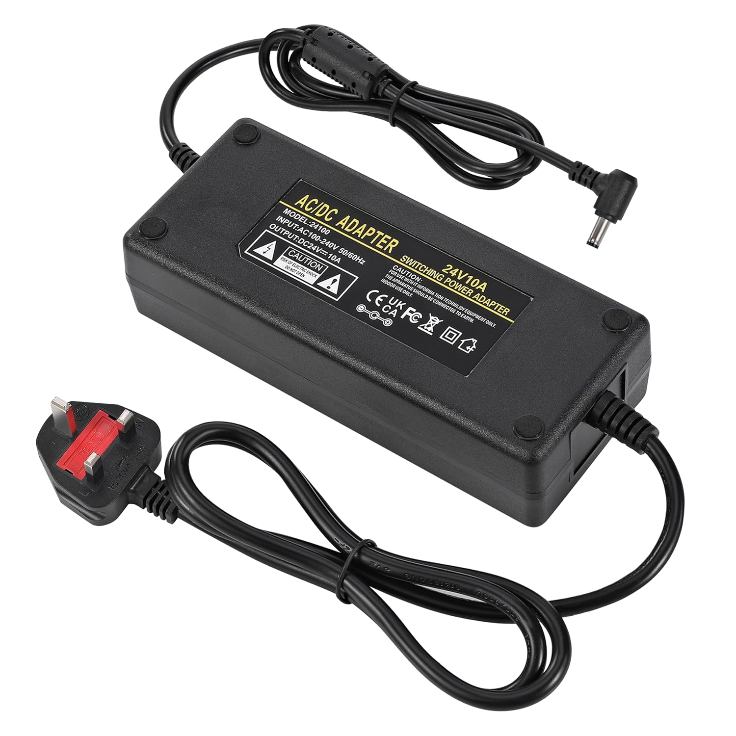

shirley_hkg wrote: It's pretty primitive, that's just a BMS with a matching male Dsub to plug into chair's connector.
I am interested in this as an option for travel to use with my Victron Blue Smart IP22 Charger. It does 12 amps and has bluetooth which is handy for seeing how much it has charged and it's only 1.3 kg (2.9 lbs) and is relatively compact 235 x 108 x 65 mm (9.3 x 4.3 x 2.6 inch).
Also for travel I was thinking of taking a PL8 and finding a cheap lightweight power supply. Maybe something like this 24V 10A 240W Power Supply Adapter:
https://www.amazon.co.uk/Adapter-100-24 ... 0CD7KJ8HJ/
or this AC 110-220V to DC 24V 10A 240W Voltage Transformer Switch Power Supply Converter:
https://www.ebay.co.uk/itm/126257933744
or something similar, e.g. a 12v 33a version for £12.99
Hardly ideal for quick charging, but could add back a reasonable amount overnight.

Postby Burgerman » 26 Sep 2024, 20:07
10A 24V less losses at charger and voltage increase to 28.8V charge means that even maxed out you will see 6 to 7A charge. Thats OK but if you are putting back 160Ah that would take almost 27 hours! Which is why we use powerful hobby chargers. I apreciate that you likely wot b fully discharging them but its not ideal... But even a 50% charge is still 15 hours.
At 40A that takes 4 hours for 160Ah. And a bit to balance.

According to this, you basically put everything back in under 35 minutes. Just left about 1% to add and balance. So more amazing than you said!
So in cases lilke that, probably better to reduce charger to 20A. Less stress on everything. You should use 30A if you need to. And 40A if its heavily dischared. Then less heat, less chance of melted cables or other issues. The advantage of an adjustable charer.
You can increase termination current a little. By around 25%. So if its set to say 200mA for e.g set to 250. Keep doing that until it ends after around 15 to 20 mins after it is at CV balanced. Its pretty good already. Manual fine tune! Its not critical. But why not.
Does it get power from the XLR plug? or do you have to provide external power for it?
