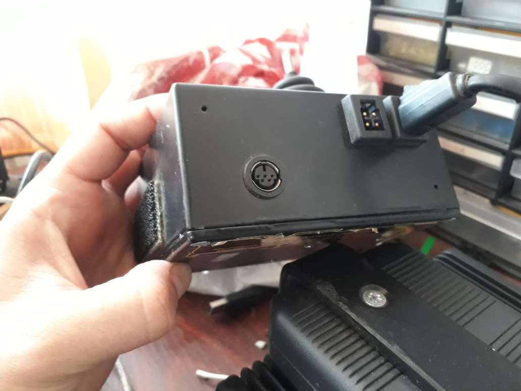

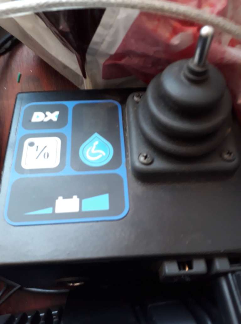

As a newbie I'm looking for some help to repair one of my friends old wheelchair.
I'ts a DX based system. I disassembled the original joystick(DX REM34) which is working, but it's not reliable and sometimes turns on or off random. At the moment i'm unable to find the source of the faults.
My second idea was to try an other controller, finally i got one(DX ACU-3), which seem to be working, but the wheelchair barely moves. I found some documents on web, now i know that the controller needs to be reprogrammed. Can somebody help me with the special wizard5? The mentioned DWIZ-ADAPT must be built or we just need an rs232-usb adapter for this thing?
Thanks,
Tom
Faulty one
New one
connector?

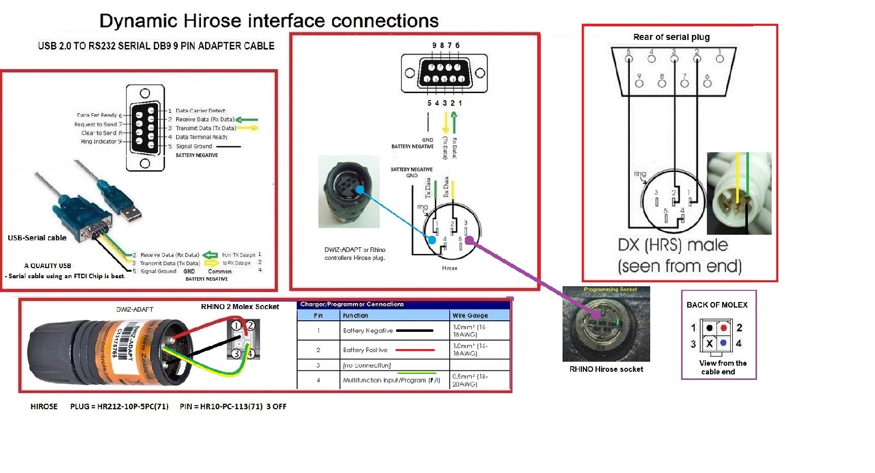

you wont need the dwiz adapt as you have a direct hirose connection.
Re: DWIZ-ADAPT
Postby woodygb » 09 Jul 2020, 17:57

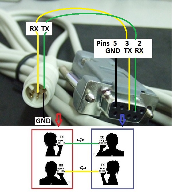

As Rover say's you need just a RS232 DB9 - USB lead and 3 off Male -Female Dupont leads ..or something similar.
You need to make the equivalent of the lead shown below and connect directly to the RS232 Cable.
MORE diagrams showing various connection types for the Dynamic range.

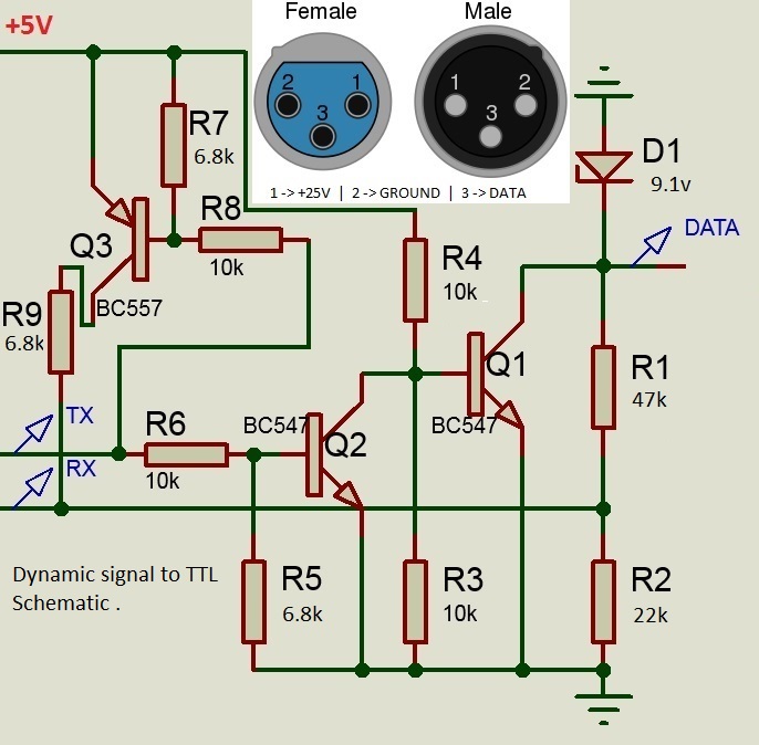

Re: DWIZ-ADAPT
Postby 7Gluk » 08 Aug 2020, 17:00
Here's a diagram, maybe someone will come in handy.
In round brackets the values that are more appropriate by calculations. But I haven't tested it.
Adapter checked only on FT232 based USB-UART with DA50-A41.
And as says - ATTENTION: do everything at your own peril and risk!
Moreover, I am poorly versed in electronics:)) Therefore, it is better to first show it to a knowledgeable person.
7Gluk
Posts: 27
Joined: 10 Feb 2020, 17:02

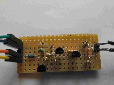

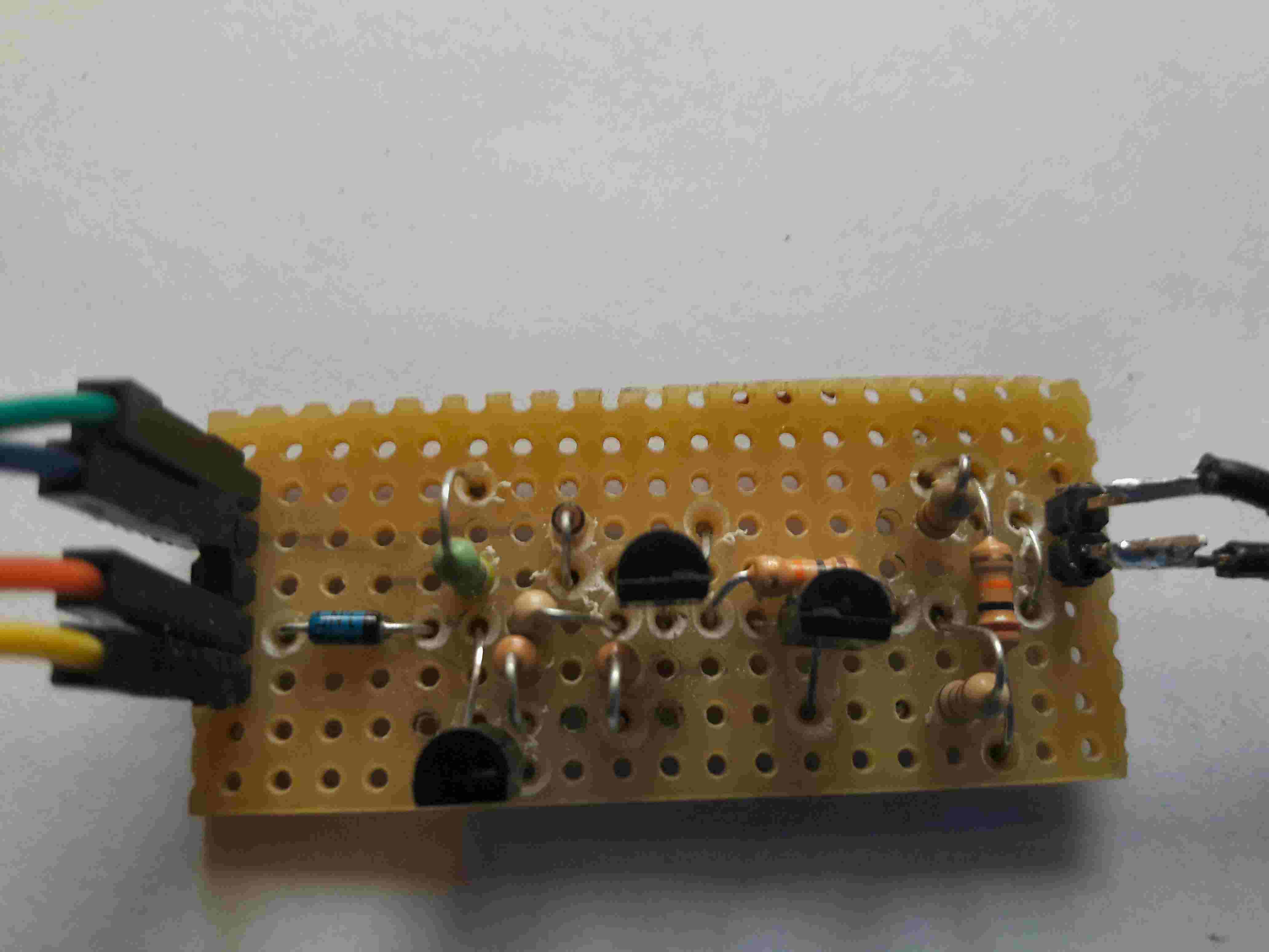

Postby woodygb » 09 Aug 2020, 15:00
OK.
I made one ( it is a bit neater ) and I can confirm that the schematic ( with some minor resistor value differences ) works on my Shark.
Re: DWIZ-ADAPT
Postby woodygb » 09 Aug 2020, 15:12
My values.

Connections to the Molex will be just GND ( pin 1 ) and the multifunction pin (pin 4 ) NO 24V +
Should you wish one I can supply you with one.
