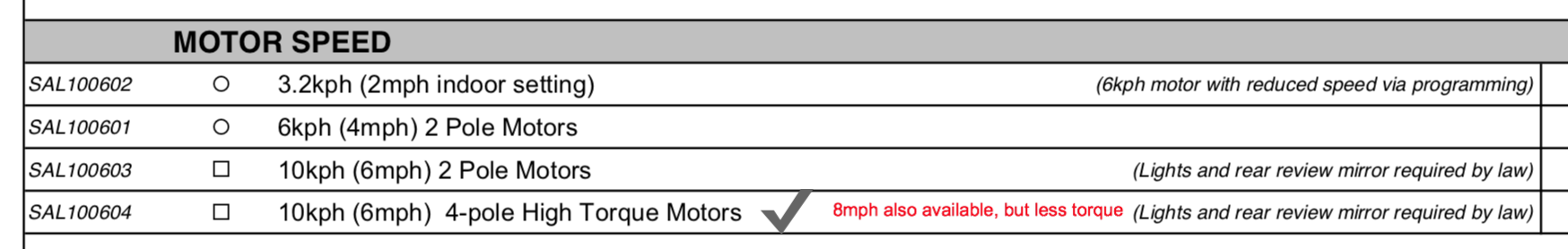

Are chairs like the Salsa modular? I.E. Is there a base chair underneath and optional extras bolted on prior to shipping? If so can they be also be unbolted and returned to a 'base chair' if not (or no longer) required? After being turned down by WCS for a powerchair, I'm trying to sort myself out with a 'used' powerchair that I can use very much like a I use a small mobility scooter I.E. Stop, Go, Rev, Turn L-R, but no real need for tilt/recline or elevate (although tilt/recline might be quite nice to have?).
The big advantage of a powerchair over a scooter would be more comfort and manoeuvrability, and more comfort and range than a man w/c.

Postby Burgerman » 22 Feb 2018, 11:57
Sometimes. But often they use alternative parts too. Best to keep all the lift, tilt etc as thats one module. And a different mechanical setup to just tilt.

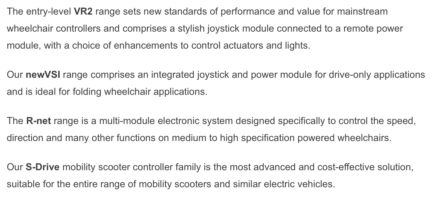

Re the motor controller (i.e. PGDT type thing) on the Salsa, do they come in different Amperage options? I didn't notice that on the order form? But if I remember rightly the amperage rating of the controller only determines how much grunt the chair has and how much acceleration you can dial in. Is that correct? When cruising at top speed, level terrain, the motors might only be pulling 30A? But grunt and acceleration are very important.
Postby Burgerman » 22 Feb 2018, 15:03
Ideally you want a 120A controller. But thats not common.
VR2 is or can be 90A.
R-net is or can be 70 80, 90, 120... Usually 90A with built in tilt actuator on the basic chairs.
Its about peak stall torque. Turning in place, curb, ramp, control in a difficult situation. Digging out of a hole. Thresholds. Not acceleration.
And batteries can be 60Ah or 73/80Amp hour. You want the latter. But it doesent matter as on any used chair the batteries will be junk. So you can choose better ones later. And yes 4 pole.
But while tilt/lift/power back/legs double the cost of a chair, its usually ignored when sold used. So you are better off getting one with all that if its already fitted. But you dont have to use it.
Downside? Weight. Adds flexibility into seat mounting.

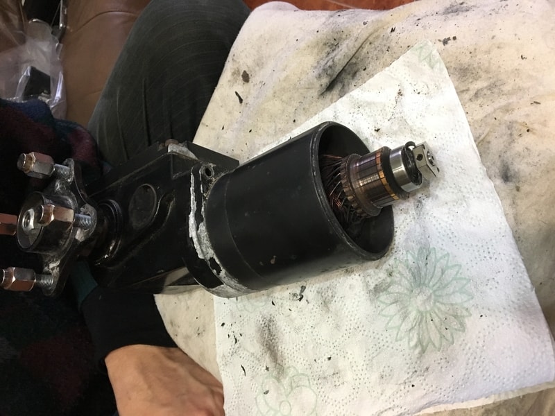

Postby elryko1992 » 24 Feb 2018, 15:05
My linix motors is DEAD :thumbdown: i was thinking is the brushes but is not, and when i open the motor the one magnet is gone.
This is the motor.

Postby Burgerman » 24 Feb 2018, 17:22
You didnt hear or feel that?
Posts: 71119

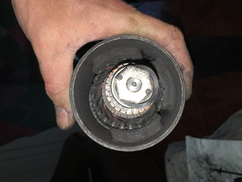

Postby expresso » 24 Feb 2018, 17:27
elryko1992 wrote:My linix motors is DEAD :thumbdown: i was thinking is the brushes but is not, and when i open the motor the one magnet is gone.
where would it have went ? it cant just disappear - it was never there from the beginning maybe ?? or was this motor used or opened before - ?
Postby elryko1992 » 24 Feb 2018, 17:33
Burgerman wrote:You didnt hear or feel that?
yes i hear and feel, but i was thinking is bearings or the brushes not the magnet and in the last time the speed drop to one motor. And when i open it is dead and smells burnt. After 3 years used.

Postby elryko1992 » 24 Feb 2018, 17:35
Was there but something happened with the magnet, the chair was new and after 3 years used is dead, this is the first time when i opened the motor.

Postby Burgerman » 24 Feb 2018, 17:38
Motors dont last 3 years if you use a chair daily. Only if you sit watching TV...
I replace every 2 years regardless working or not.

Postby elryko1992 » 24 Feb 2018, 17:44
Burgerman wrote:Motors dont last 3 years if you use a chair daily. Only if you sit watching TV...
I used every day the chair, and i think was some water there or snow :) because i don't stay in home everyday. Now i need to found two motors.
No idea. But they can break up... But likely was opened before. Did you buy used? Probably cracked, so taken out, reassembled... Must have been worse than the other motor! Unless that one too has one missing. I have seen them break and the loose bit jam the motor or make a terrible noise. Never dissapear! It cant. Your pictur looks odd though. Hard to see inside. Take it all apart I am interested! Its a 3 pole!

Postby elryko1992 » 24 Feb 2018, 18:31
Burgerman wrote:https://www.ebay.co.uk/itm/QUICKIE-JIVE-MOTORS-GEARBOXES-FOR-ELECTRIC-POWER-CHAIR/173163925976?hash=item28515fd1d8:g:qJUAAOSwIWVY-MsD
https://www.ebay.co.uk/itm/QUICKIE-JIVE ... Sw2gxYpyMi
Search for salsa and you only find 2 pole weedy motors...
https://www.ebay.co.uk/sch/i.html?_odkw ... s&_sacat=0
I open the second motor and is 4 magnet, is 4 pole not 3. And this where is 3 magnet have 4 brushes. That is hard to see there because all is black the magnet was eat. And the motor working but have delay when i drive, and the second motor works in parameter normal and this not and i can't drive, and when i go to maximum speed my chair is stoping.

Postby Burgerman » 24 Feb 2018, 18:33
I am not surprised. You cant actually have a 3 pole! It was a joke. North/North/South doesent work! You mean its ground all the magnet up into dust? Lovely! Must have sounded like a washing machine full of gravel. :cussing
