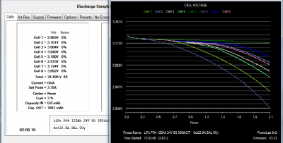

Postby Furio » 12 Jul 2018, 10:54
This is the fag end of 120Ah battery discharge. The voltage is all over the place. :shh: After charging to full, I initially discharged 105Ah through a Turnigy wattmeter to 24v truck halogen lamps.Then connected to pl8 and discharged the remaing 7.8 Ah till charger stopped on cell #6 voltage.
Also the charging data after the above discharge. :shh: :problem:
BM's opinion please. :argument

Re: Sinopoly Cells - Info -
Postby Burgerman » 12 Jul 2018, 18:01
They are all ended really thopugh. Maybe only a percent or so between all of them. They wont all be empty at the same moment. You are only looking at the very ending. You dont see this with headway cells because there are a lot of cells. So that they all average out. As you discharge in use, the cell to keep an eye on will be the one here that drops lowest first.

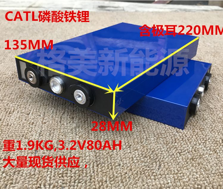

Another cheap cell , nos 80Ah @£17.50 .
Famous brand , CATL with super low IR 0.37mΩ can survive high C-rate discharge .
Postby Burgerman » 14 Jul 2018, 08:02
Allwws 160Ah if those cells are any good. But wastes 70mm in one direction and about 20mm in the other, Unused.
