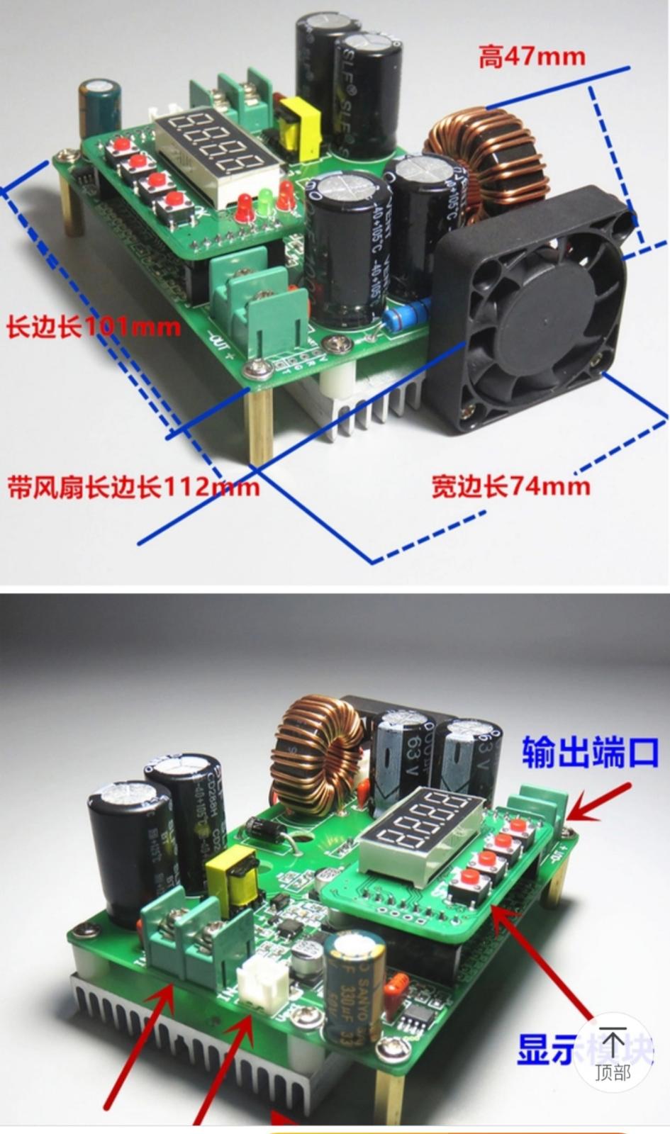

Postby shirley_hkg » 21 Jul 2018, 15:17
700W 12A
CC / CV step-down module .
Posts: 4656
Postby Burgerman » 21 Jul 2018, 15:18
Yes those or similar.
Posts: 71096
Postby shirley_hkg » 21 Jul 2018, 15:28
I thought of it too. A power bank for wheelchair ,
like the one used to charge cellphone. :clap:
Posts: 4656
