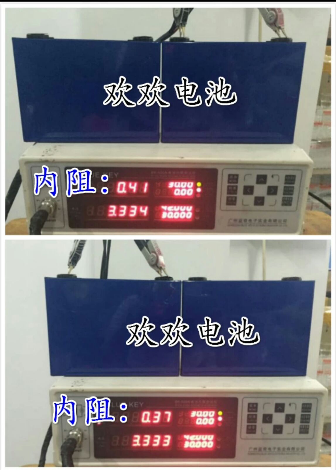

Postby shirley_hkg » 24 Apr 2017, 02:59
;) Maybe 180Ah is feasible .
Also by ATL .
IR @0.4mΩ
£22.70
Postby expresso » 24 Apr 2017, 03:29
180 ah that would be great - never have to worry about going to low - if this is ever figured out and they are new cells -etc,
maybe a good choice for my next future chair -

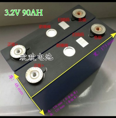

Postby Gnomatic » 24 Apr 2017, 04:05
shirley_hkg wrote:;) Maybe 180Ah is feasible .
Also by ATL .
IR @0.4mΩ
£22.70
Don't think those above will fit. Can you get the ones you mentioned a couple days ago? The 75Ah cells.
shirley_hkg wrote: :D
Found this too , and think you'd give it serious thought .
Look at the super low internal resistance , and tested capacity .
I'm quite confident that you can fit 16 of them in it , and that's 150Ah .
Should be good stuff . 0.36mOHM @ 2.65V That's really good , itsn 't it ?
@£17.00 :lol:
Postby shirley_hkg » 24 Apr 2017, 07:13
Yes , they are still available . You have to judge its quality basing on the superficial information , IR and recharged capacity . Risk on / off .
http://c.b0yp.com/h.5mdPXP?cv=TvGoZtJH23z&sm=7abfba
Seller's reply is standard : THIS is NOS , and stored at 2.7V from factory .
Postby Burgerman » 24 Apr 2017, 10:20
Wont quite fit 16.
The ones I linked to are perfect! Need supplier.
Posts: 71104
Postby Gnomatic » 24 Apr 2017, 19:01
shirley_hkg wrote: Yes , they are still available . You have to judge its quality basing on the superficial information , IR and recharged capacity . Risk on / off .
I can fit 16 of these easy in any of my chairs. I know there's a risk that these cells might not be top quality, given the limited information available. But for the price, I'm will to take a chance.
What's the best way to buy something off Taobao and have it shipped to the US? I don't speak Chinese and Google's translator isn't perfect.
