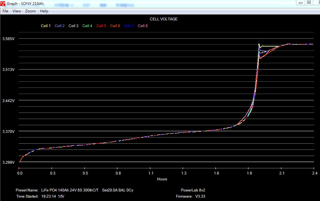

:D First try of PL8 on my lithium . It's a 72P8S pack with Sony 26650 cells . TWO years old and has been with BMS . :P
Postby Burgerman » 02 May 2017, 14:12
Pretty good. Bet your charger is set to a lower voltage than recommended though...
The pack in my mower is 2 year old and was with its BMS. And miles out. And defective.

Postby Gnomatic » 02 May 2017, 15:50
shirley_hkg wrote::D First try of PL8 on my lithium . It's a 72P8S pack with Sony 26650 cells . TWO years old and has been with BMS . :P
How many Ah is your pack, Shirley?
Posts: 2123
Postby Burgerman » 02 May 2017, 20:59
Top of graph, says 215Ah. Bottom of graph says 140Ah...
