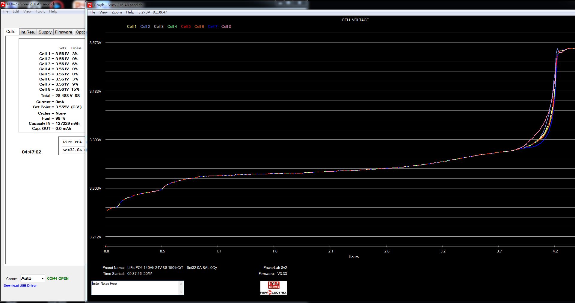

Anyway, here's the recharge graph. Only change I made to the preset was upping the CC voltage to 30A, to finish up a bit faster.
Postby Burgerman » 18 May 2017, 09:41
Strange that they are not almost exactly together, but looks ok. Maybe long charge cables. At least cell 8.

Postby shirley_hkg » 20 May 2017, 07:39
IS it normal that it shoot up to 3.561V , right after stop , that set point is 3.555V ? ;)
May be 32A current is high .

Postby Burgerman » 20 May 2017, 14:18
Theres three voltages.
1. Voltage at charger while 32A flows.
2. Voltage of cells while 32A flows, which is false or rather not the voltage that is important. Only resting voltage without current matters. The charger knows this but doesn't display it.
3. Voltage at charger, and at cells is different depending on cable length and resistance and current.
Charger knows all three voltages! And more importantly charges in pulses with breaks where it measures off load voltages many times per second, so it knows what is really too high. So displayed voltage is actually an average of the voltage at charger (rather than cells) and during charge and short breaks. Rather than the off load/charge voltage. So don't worry.
