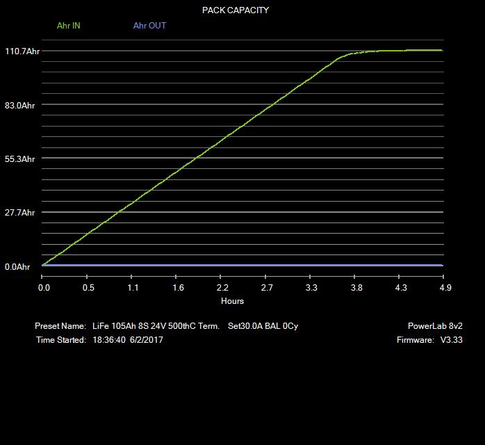

After my mishap, I completely tore down the pack, and removed the two cells that were compromised by scraping against bolts when I was doing a test fit a couple weeks ago. I also took out a third cell that seemed it may have taken a bit of abuse as well. Huge thanks to expresso for sending me a few replacement cells and orange blocks so I could bet the rebuild going much sooner than otherwise.
I individually tested a bunch of cells for capacity ect. Everything seemed fine. Reassembling the pack went much, much easier and smoother than when my friend and I initially put it together. This is all new territory for me, and there's no teacher like experience. Once assembled, I charged the pack, did a complete discharge to 2.9v, and then fully recharged it.
A little bit of bouncing around at the top of the first graph, maybe a little less pronounced than before. My charge cables are long so I'm chalking it up to that.
Ahrs returned seems fine I think.
So all this put me back two weeks, but all in all, I think the pack is better assembled than before. It really helps having some experience putting one of these together. I get my chair base back from the shop I took it to next week. All the bolts sticking above or inside the battery area have been ground off and welded in place so the inside of the battery area is snooth. I'll be lining the entire inside of the battery area with drawer liner, and also am wrapping the pack in rubber sheeting. At that point, I think I'll be ready to install the pack in the chair! (hopefully no sparks this time :oops: )

Gnomatic wrote:After my mishap, I completely tore down the pack, and removed the two cells that were compromised by scraping against bolts when I was doing a test fit a couple weeks ago. I also took out a third cell that seemed it may have taken a bit of abuse as well. Huge thanks to expresso for sending me a few replacement cells and orange blocks so I could bet the rebuild going much sooner than otherwise.
NIce - You Saved the day - :) thats great - got back in shape in 2 weeks time - i bet the graphs will get even better with time and using it daily etc, -

Postby Gnomatic » 03 Jun 2017, 17:31
It would have been much longer than two weeks if you hadn't sent me some spare cells and and orange blocks! Thanks again.
