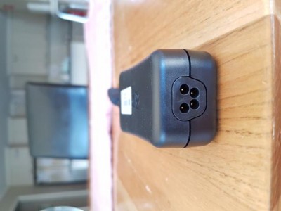

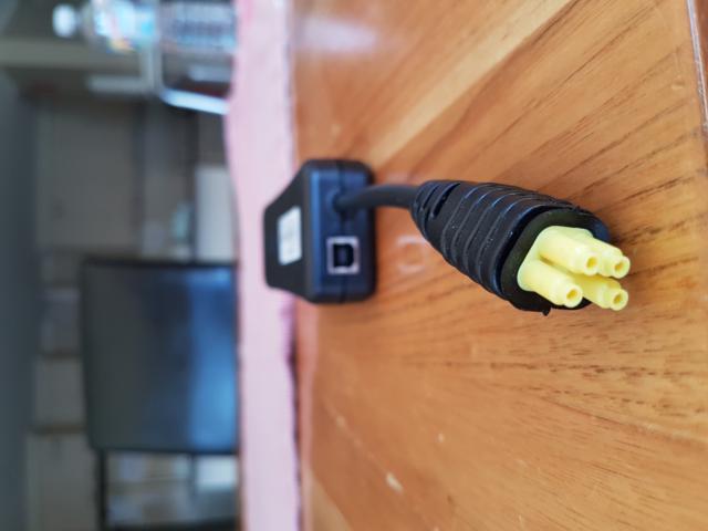

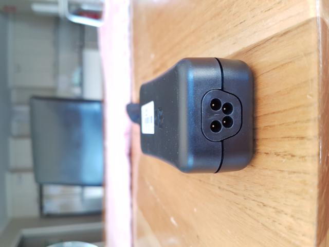

Postby carlo67 » 08 Oct 2016, 02:54
these are i got, I don't know where plug it in chair? will I unplug other plug on chair?
carlo67
Posts: 251
Joined: 18 Mar 2010, 04:58
Re: which chair is best or better.
Postby Burgerman » 08 Oct 2016, 08:11
Unplug any module anywhere and add the thing in your picture. Eg control pod.
