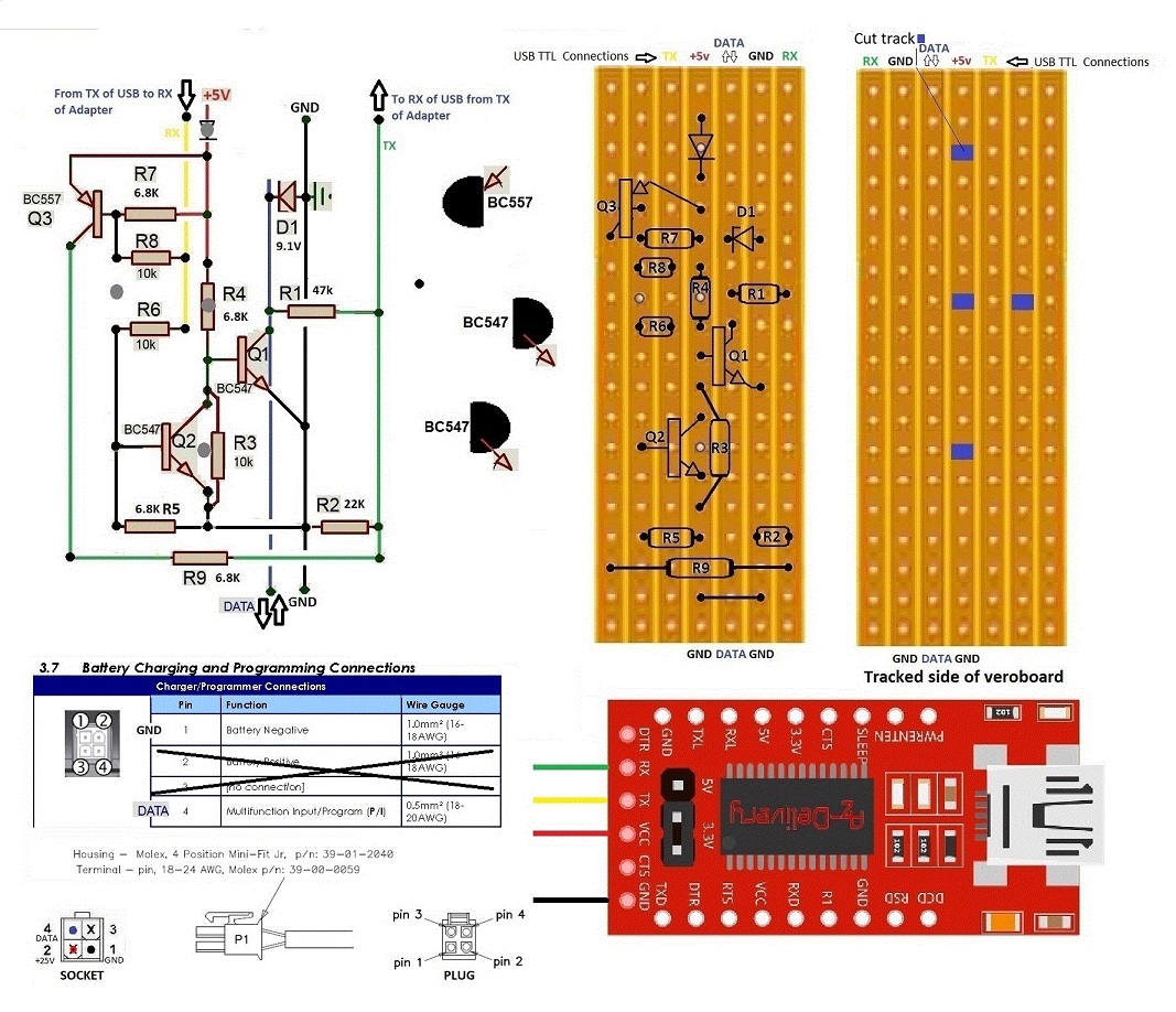

Re: DWIZ-ADAPT
Postby dc5dd » 12 Oct 2020, 18:53
Yup, I noticed a doide in your 7Gluk desgin?
dc5dd
Posts: 5
Joined: 12 Oct 2020, 06:46
Re: DWIZ-ADAPT
Postby woodygb » 12 Oct 2020, 22:59
The diode is probably not required , it was simply an addition by me as a "safety" feature , so this diode is most likely not needed.

dc5dd wrote:Woody, you better give me that diode anyway Newark has flat rate shipping and I minus will get that while I'm at it. Danny
I used a 1N5711 SMALL SIGNAL SCHOTTKY DIODE ... because I had some...

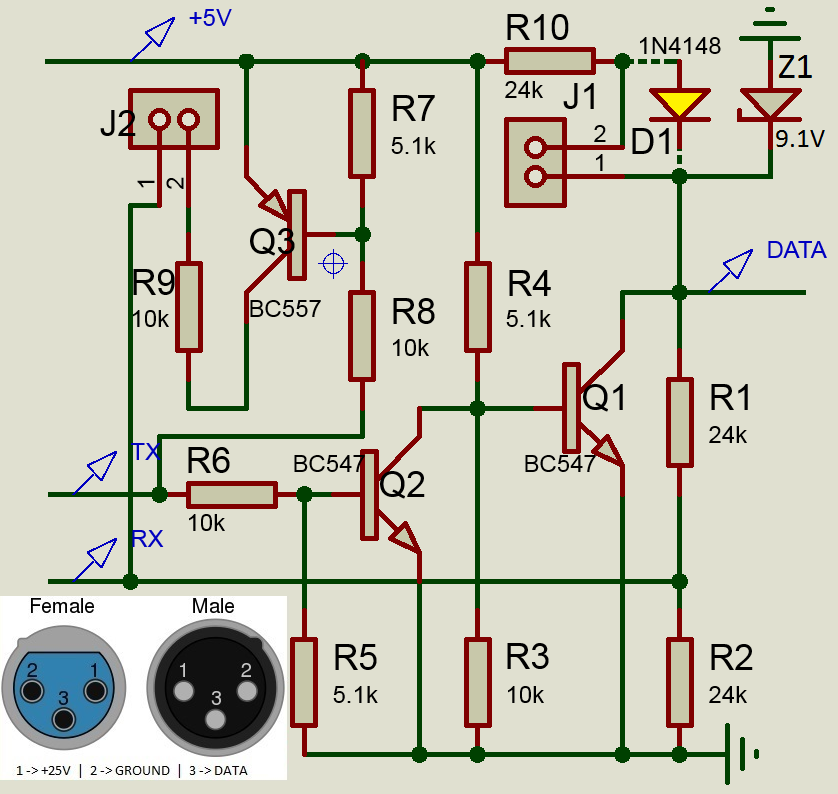

Re: DWIZ-ADAPT
Postby 7Gluk » 18 Nov 2020, 21:57
I changed the circuit of the adapter to fit the newVSI remote. I have two WC with different remote, and it is more convenient to have a universal adapter.
1. For the DA50-A41 remote, you need to open J1 and short J2.
2. For the newVSI remote, you need to open J2 and short J1.
J1 can be replaced with a diode D1. But I can't check now whether the diode will affect the work with the DA50-A41 remote (that WC remained in the country).
Woody's resistors can be used too. But if the R1 is different from mine, the R10 may need to be adjusted.
And as I already say: ATTENTION: do everything at your own peril and risk!

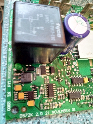

Postby pdumitru » 22 Jan 2021, 15:35
Hello!
i got a Mercury M36 mobility scooter that no longer works. I found that the controller is defective and I bought one from ebay which unfortunately comes from diffrent model of scooter and it needs to be reprogrammed.
I would like to try to save the settings from the faulty controller (if is possible) and load them in the good one.
I just need wizard5 and some advice .
Thanks!!!

Postby pdumitru » 24 Jan 2021, 16:52
I have tried to connect the damaged controller to my computer with no success.
I can only connect the good one, but i have no idea how to do the right settings.The scooter is shaking at low speed, especially on reverse direction.Can you help me to find the right settings for Mercury M36, please?
pdumitru
Posts: 6
Joined: 17 Apr 2020, 13:13
Re: DWIZ-ADAPT
Postby woodygb » 24 Jan 2021, 17:02
It could be the motor load compensation setting.
Load Compensation Value: Load Compensation (mOhm)
If Load Compensation is set too high, the chair
- Drives very rough
- Is hard to steer or control, vibrates or surges
Try taking the existing number lower and use small increments .... reduce by 5 mOhm each time ...test and repeat if needed.
IF IT GETS WORSE, STOP AND REVERT BACK TO THE ORIGINAL SETTING.
Re: DWIZ-ADAPT
Postby woodygb » 24 Jan 2021, 17:19
https://manualzz.com/doc/23099492/rhino ... ion-manual
Page 56 - 57 gives you the procedure for setting the Load Compensation value.

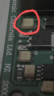

Re: DWIZ-ADAPT
Postby pdumitru » 28 Jan 2021, 20:11
After several attempts to find the correct load compensation value I decided to tried to fix the faulty controller. After several measurements I finally found a tantalum capacitor in short circuit. after replacing the capacitor I was able to read the original settings and load them in the good controller.Like you said the load compensation was to higt 140 and the original settings is 30. Thank you for your support!
