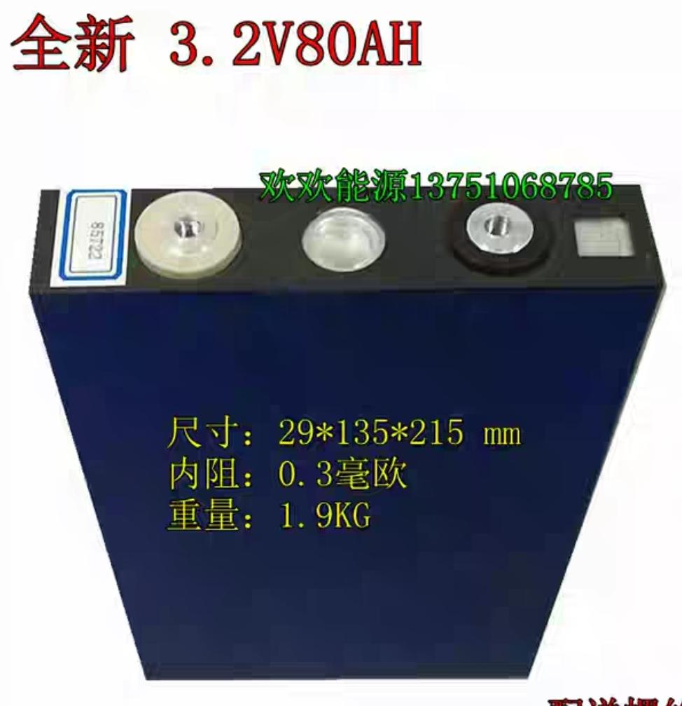

That CATL turns out to be a 70Ah cell only .
Seems what Gnomatic has been chasing after are better better picks .
Or this 80Ah one , @£22.00
They are ALL from the seller who SNAKER purchased from .

thats a good size -- would fit easy in my box width wise - just a bit taller - but will work - i make it work :)
if you are up to getting some for me - - i leave it to you which is best cells - 80ah would be great -
what your showing is in pounds or liters ? cost of each cell - etc.
these are NOS ?

These EVE-LF90 has many sources to choose from , even brand new from factory , mostly NOS .
They are 36mm thick , but a bit shorter .
It will be only one foot wide for the entire pack . Think again if your P220 why can't carry it . :clap:

Depending on the size - and weight of the Cells -
i may be interested if it fits my needs for 8 of them possible -
thanks :thumbup:
Re: Sinopoly Cells - Info -
Postby Gnomatic » 22 Jul 2018, 16:57
ICEUK wrote:Shirley what r the dimensions and any additional info?
Thx
130.3mm long
37mm thick
200 tall
Postby shirley_hkg » 23 Jul 2018, 03:20
Burgerman wrote:MEANING that you can fit 210Ah in place of lead
The math:
Cells are in mm:
130.3
37
200
37 x 8 = 296
37 x 4 = 148
We have a 240mm tall box. With 260 (or more) x 340 (or more although this way not an issue)
Arranged as
2 side by side is 260.6 (plus 3mm insulation from 1mm sheet so 263.6 total)
8 deep gives 296 (plus 9mm insulation so 305 total)
So with careful measuring it might just fit 16 cells.
210Ah in place of 74 (45 to 50 usable) So 5 to 6 times stock
We are doing a 2P8S pack .
Is it still save enough to eliminate the insulator between cells of the same group ? It will save 4 insulation sheets in a row then , ie another 4mm in length .
goodpost
