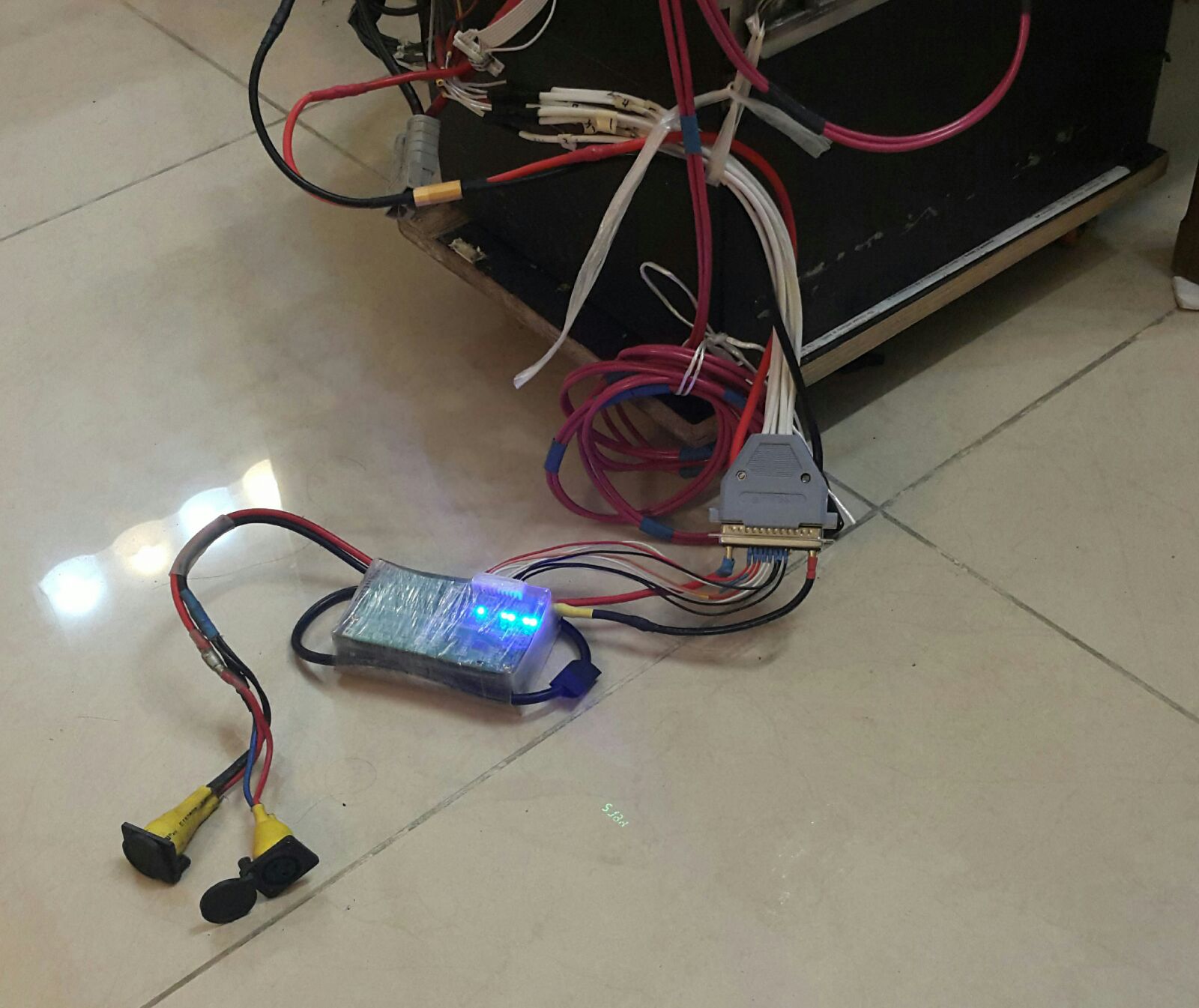

External BMS/Charge controller so dumb charger can be used if needed, perhaps?
Postby steves1977uk » 15 Jun 2017, 18:09
shirley_hkg wrote:;)
Monitor that BMS with the PL8 connected and post the graph please Shirley, be interested to see how it balances...

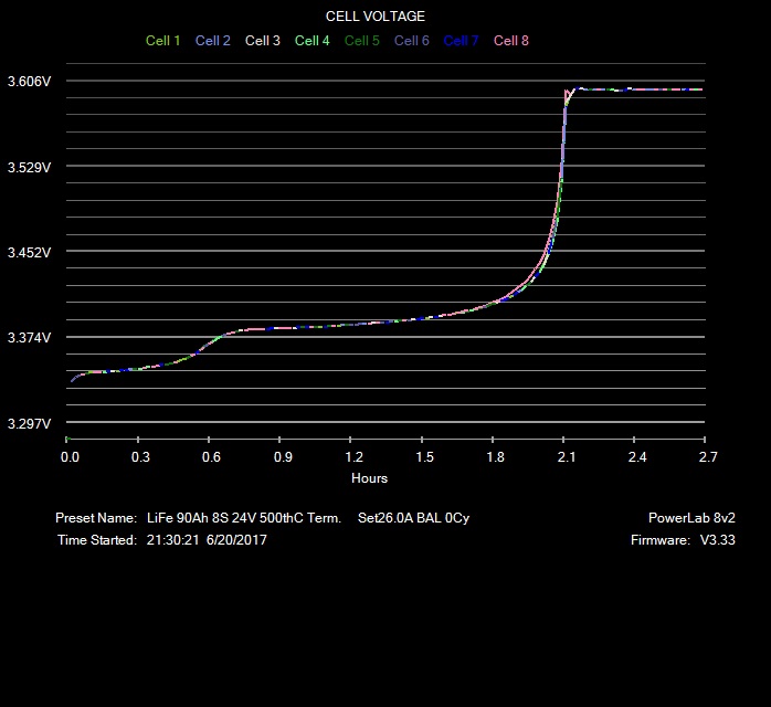

Postby Gnomatic » 21 Jun 2017, 18:08
In interests of tome I had to scale my pack a bit and leave off the top group of cells. I'll have room for it after a few more small mods. But that will have to wait. I started with the intention of building a clone of expresso's 105Ah pack, but for the rest of the summer, its a 90Ah pack for me. I'm fairly certain it will still piss all over lead bricks.
A couple buddies stopped by and got the pack successfully lowered into the chair base with multiple layers of insulation on the bottom and all sides.(no sparks this time!) The extra insulation has been holding me up, as I didn't account for it when planning and measuring. But after my incident, even though I had all the bolts that protruded into the battery area welded in place and ground off since, I still wanted extra insulation. Which I now have.
With the pack in the chair base, I discharged about 2/3rds the way, and charged it back up. Looks pretty good. Less squiggly at the top than when I was charging it with the top row on.
Postby Burgerman » 21 Jun 2017, 20:01
90Ah will still allow around double the range you get from a set of grp24 batts.
Since you only really get a true 40 to 45Ah from a 73Ah MK gel before low voltage under load ends playtime.
More is better, as it works the cells less hard on every trip, which benefits service life etc. But it should be enough.

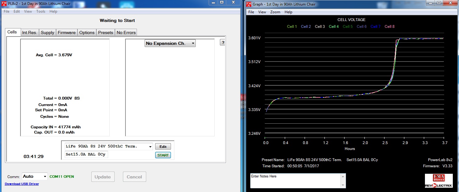

Postby Gnomatic » 01 Jul 2017, 02:46
First day in my chair with my lithium pack. Don't know exactly how far it was, but I went about as far as lead new can take me, plus some more on top of that. I'm curious to see how many Ahrs get returned to the pack when I charge it tonight.
One thing that stood out right away, the chair handles hills better. A lot less vdroop, especially after going a few miles. I expected this from my lithium pack, and it didn't disappoint.
Postby Burgerman » 01 Jul 2017, 08:20
Remember that if you take out 50Ah you put back about 53 to 55. So it seems like you used a little more than you actually did. Charging isn't 100 percent efficient.
Posts: 71120
Postby Gnomatic » 01 Jul 2017, 15:37
It turns out I put just 41.774Ahrs back into the pack. But I'd have been real nervous trying to go where I did yesterday with lead. I'm sure the joystick would have been calling me names and telling me to plug in. I'm about 220lb, my chair base is a big heavy one compared with something like expresso's 646se, and the seat on the chair is a heavy one with power tilt/recline, and elevate. And some of where I went yesterday was offroad.
So would you say the relatively low Ahrs returned to the pack that would kill my new lead bricks is a result of my chair is drawing lots of current out the gate and Gel lead can't cope?
Whatever the reason, after one day, I can comfortably say my small 90Ah pack easily more than doubled my range.
Postby Burgerman » 01 Jul 2017, 17:23
That 41Ah means you used about 39 to 40Ah on your trip. Thats all you will get from a group24 lead brick.
Although you can obviously go the same distance again, and still have plenty left with lithium.
Depending on the rate you use it your 73Ah gel will let you use anything from 1/2 to 3/5ths of its capacity before the chair stops.
If you set off fully charged without driving about the house, and go 8mph for 2 hours thats 16 miles, and you battery is dead. Because you took more power for a short time.
If you go 4mph in the same chair, and go 16 miles, there will be more power left in the lead. Because thats the 4 hour rate. So you can continue for a while. The actual figure the ISO test uses is the 5 hour rate.
