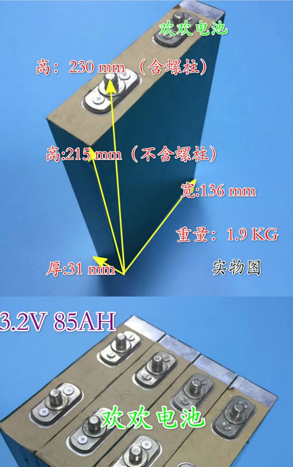

Postby Gnomatic » 03 Jul 2017, 18:53
Burgerman wrote:A group 24 battery like the MK is exactly 259mm long.
8 of these cells = 29mm*8 = 232mm. Well under the length of a single G24 battery.
Burgerman wrote:And 173 wide.
So 173mm*2 for two G24 batteries sitting side by side = 346mm. To rows of these cells 135mm*2 = 270mm. Again, well under the width of two G24 batteries sitting next to each other, longest side to longest side.
Burgerman wrote: And in many chairs uses flat top terminals. 200mm tall.
Your spec sheet for MK G24 w/ flat terminals says they are 209mm tall. BCI chart says 225mm tall with full terminals. All my chairs can accommodate G24 bats with full sized terminals, and still have a bit of head space. These cells are 215mm tall, so no problem for me.
Postby Gnomatic » 03 Jul 2017, 18:59
expresso wrote:
Burgerman wrote:If you have the height, yes.
the height i would need cant be more than 9 1/4 or 9 1/2 - the 105ah pack fits perfect so not over that height would work for me - they would have to fit sideways also - for the cost of $18 each - i would have to make two 12 Volts and connect them for 24V
i would consider others also - as long as they fit in the same space - for about $200 to get 8 of them - sounds very good - i would have to plan this out first - if it has the connectors - screws etc, - all the extras - not in a rush though - i need to get my main chair back working first
You would need 16 of these for 150Ah. They are 215mm or 8.46" tall. So almost a full inch shorter than your current 105Ah pack. Plenty of room.
You would have more free space in your battery area in every direction with 16 of these than you do with your current 105Ah pack.

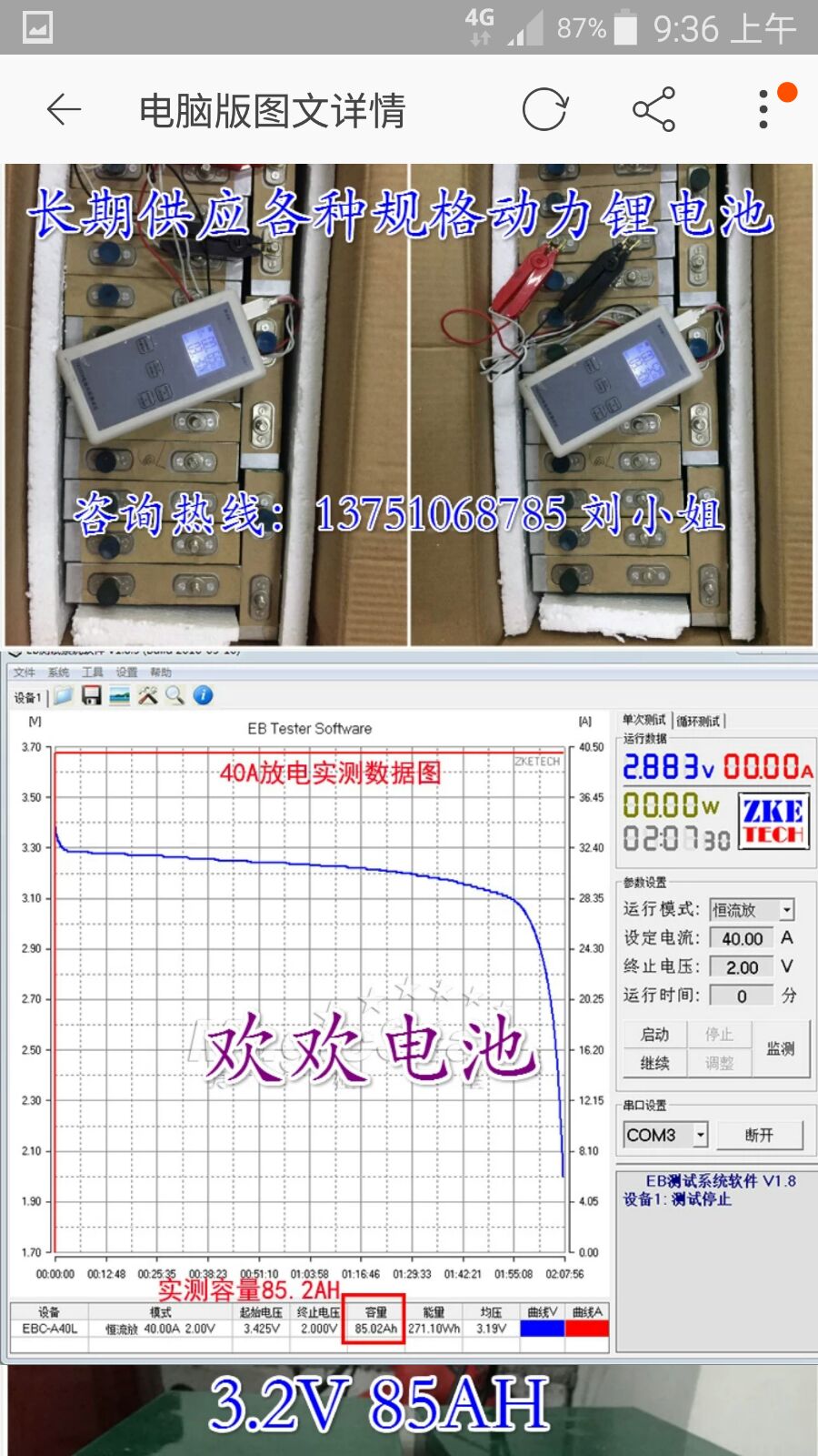

Postby shirley_hkg » 06 Jul 2017, 02:55
Bigger pie for pizza lovers .
IR 0.5 -- 0.6 mΩ , 85.02AH at 0.5C discharge rate .
170AH , ,same price , G24 size still .
Postby expresso » 06 Jul 2017, 03:21
whow - that sounds great - If it really fits in a group 24 battery size - has to fit - no room for error with the chair i want to add this to -
would be amazing to have that much range - i can remove the 36ah ADD ON - remove the lead and replace with 16 of these - sounds perfect
but whats the catch - ?
if its all good - i would be interested in 16 of them - also i am sure Genomatic would be also interested -
are they OLD - USED etc ?
what about hardware to connect them ?
i love pizza :mrgreen:
